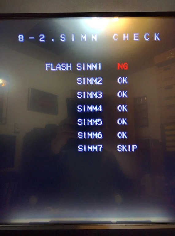

You can do a SIMM test, but keep in mind IF you are using a SuperBIOS (Darksoft) cart the first SIMM will always report a bad CRC.

hmmm ok, I did the SIM test and everything looks good SIM 2-6 say ok.
I took out all the SIM's and wiped them down with rubbing alcoholl.
I also took out the cart and put it back in.
I"m still having freezing issues in the game.
