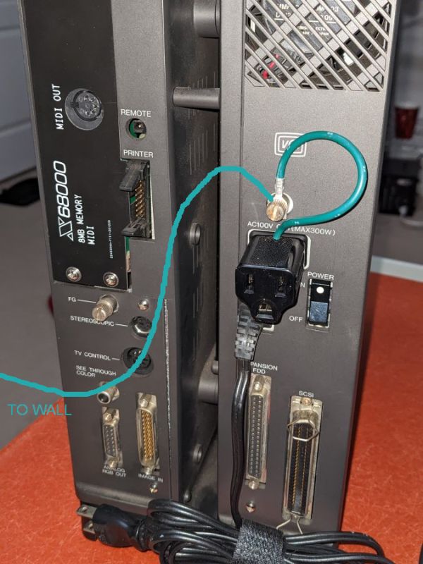

But since your here I looking to ground the system and wated to ask you a bonus question. There are 2 Field Ground terminals on the back of the X68000. If I have my ac plugged into a step down converter ungrounded. How might I go about grounding the system itself to FG? Would I plug a Cord into the wall and connect the ground to both or one of the FG terminals?

As far as I'm concerned, the FG terminal was for anything else going into the 'AC100V OUT' outlet.
No. That makes no sense.
Japanese wall sockets have separate ground connections. You're supposed to put a separate ground wire between the wall socket and the appliance.
Of course you can use it like that, but you need to wire it to your wall as well. Do you think a direct electrical connection to earth exists inside the X68000 by itself?

There 2 FG.
Can someone confirm if this very rough paint diagram is correct. I would like to buy just a wire with a male pin for ground and tie both FG to fork terminals, Then plug the AC +- into the a Female AC plug and run the bridged FG to its own pin on the bottom ground AC plug. Does anyone know a good just male ground pin to attach to a wire to plug into the female ac socket?
