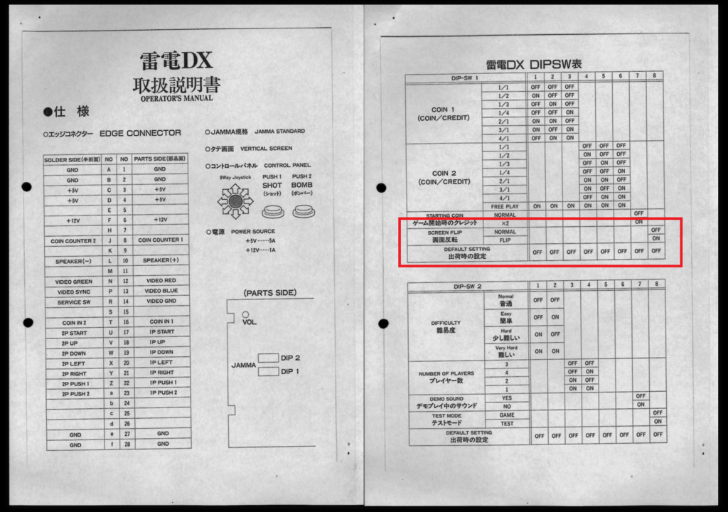

nonosto Champion Joined Jun 5, 2018 Messages 2,120 Reaction score 610 Location FRANCE Sep 5, 2022 #1 Hello I will soon receive my raiden dx, I read the manual there is a flip option, for you is it a 90° (yoko) or 180° rotation please? THX
buffi JONGBOIS Enlightened Joined Aug 12, 2019 Messages 1,268 Reaction score 2,918 Location Sweden Sep 5, 2022 #2 180 rotation, to avoid not having to do yoke flips if you have a weird orientation of your tube. Very common in general
nonosto Champion Joined Jun 5, 2018 Messages 2,120 Reaction score 610 Location FRANCE Sep 5, 2022 #3 Thx very much.
