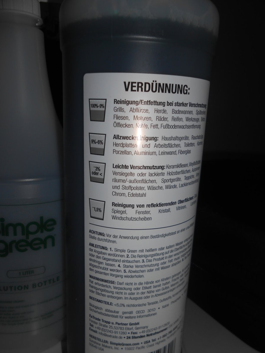

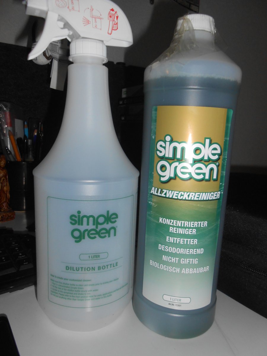

Id like to clean my chassis and my monitor and Ive got some biodegradable Simple Green in a concentrate bottle. I also bought a 1 liter empty dilution bottle for the dosage.
This product isn't common in Switzerland and no way to get some from a foreigner country since the customs rules regarding liquids. My german is so bad and Google do not traduce all words well, but the only electric element Ive found on the label are ''Grill'' and ''Motor''.
They say a ratio of ''100%-9%'' for grill/motors (I guess for 1 liter of water : 9 deciliter of Simple Green) but they don't speak about electronics... The other ratios are lighter but still no electronics... Which dosage would you use?

Yes 1:1 is fine for Simple Green.
I find that Krud Kutter does a better job though at removing grease/nicotine tar, etc... I have cleaned some pcbs/chassis with simple green a few times, looks ok, but have gone back and washed them with krud kutter and it has definitely clean stuff simple green left behind.
I say experiment with both, you can go wrong :D

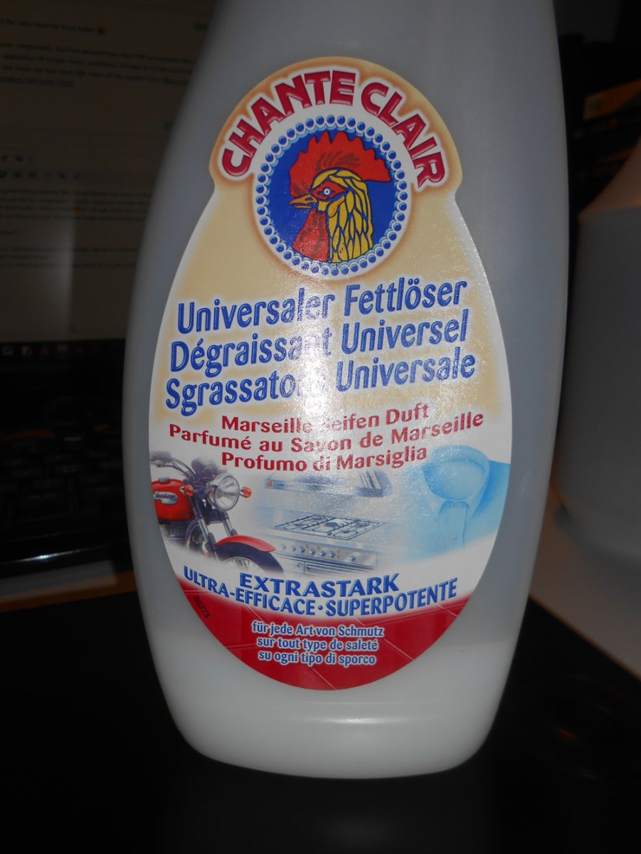

Real : that's difficult to get these products in Switzerland unless an importator decides to commercialise them. I had luck with the Simple Green, but a few months ago this product didn't existed inthere. I think we have something similar (check pic). It's a universal and strong enough degreaser which do the job correctly I guess (but not biodegreadable I think since this isn't mentionned on the label).

Like STJ says, you can try dish washing soap with really hot water, etc... its should get about all the grime off.
Just us a good painters brush that can get into the tighter spots around components.
