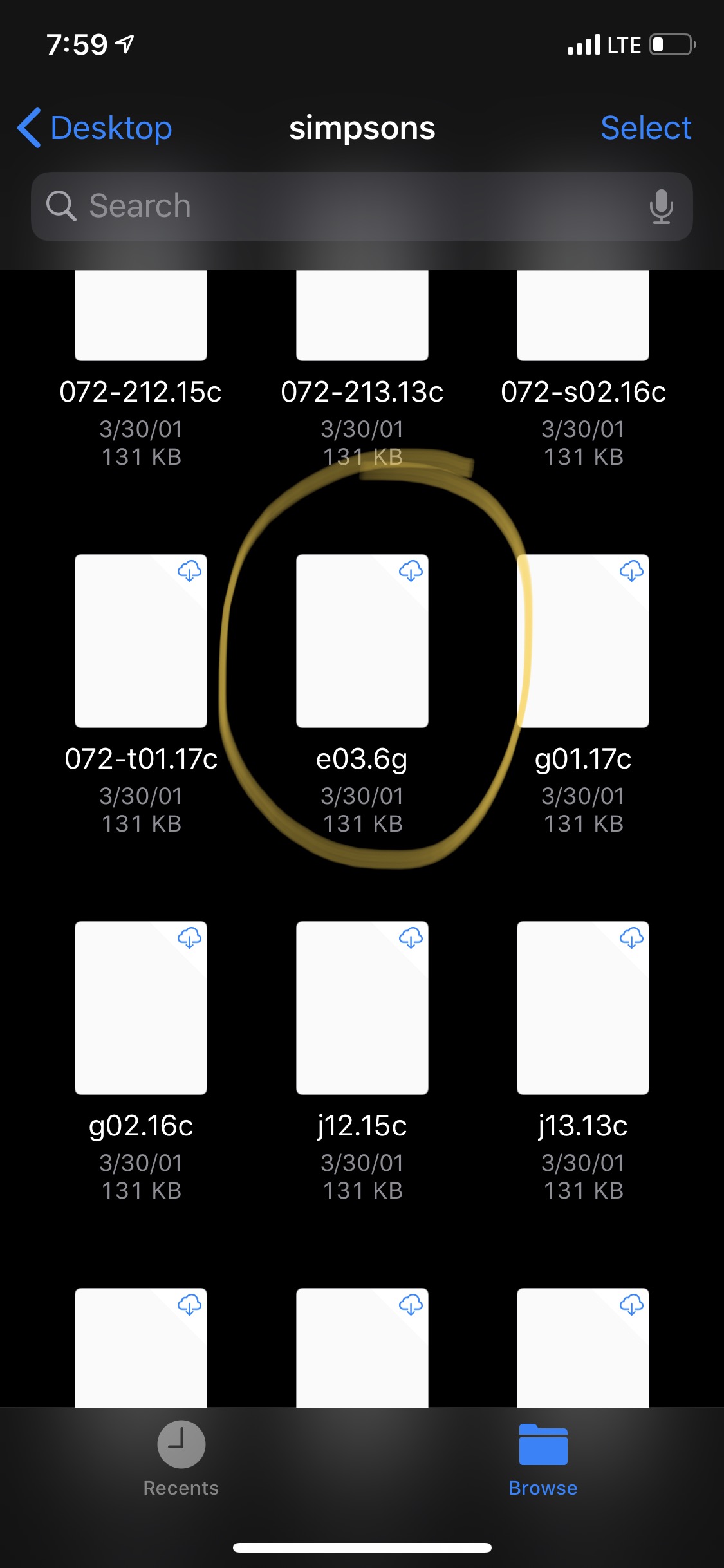

Also, I have a burner, but I don’t know what IC to get... or what file I’m looking for...
Is it one of these two?
thanks again for you help!!! I really appreciate it!

The file you need is dependent on the version you want to run. I'm not sure why but the files seem to differ between the 4p and 2p romsets. There is also a difference between asia and everywhere else, but that makes sense since this is the audio cpu code.
https://github.com/mamedev/mame/blo...144661d9f8/src/mame/drivers/simpsons.cpp#L393
The romset you're looking for has the filename here: https://github.com/mamedev/mame/blo...144661d9f8/src/mame/drivers/simpsons.cpp#L634 in the first column e.g. simpsons, simpsons4pe, simpsons2p etc.
No matter the file, it will run on a 1mbit 8 bit 32pin rom: 27c010 or 27c1001
or if you're out of those, a 2mbit 8bit 32pin 27c020 or 27c2001 with the data doubled
