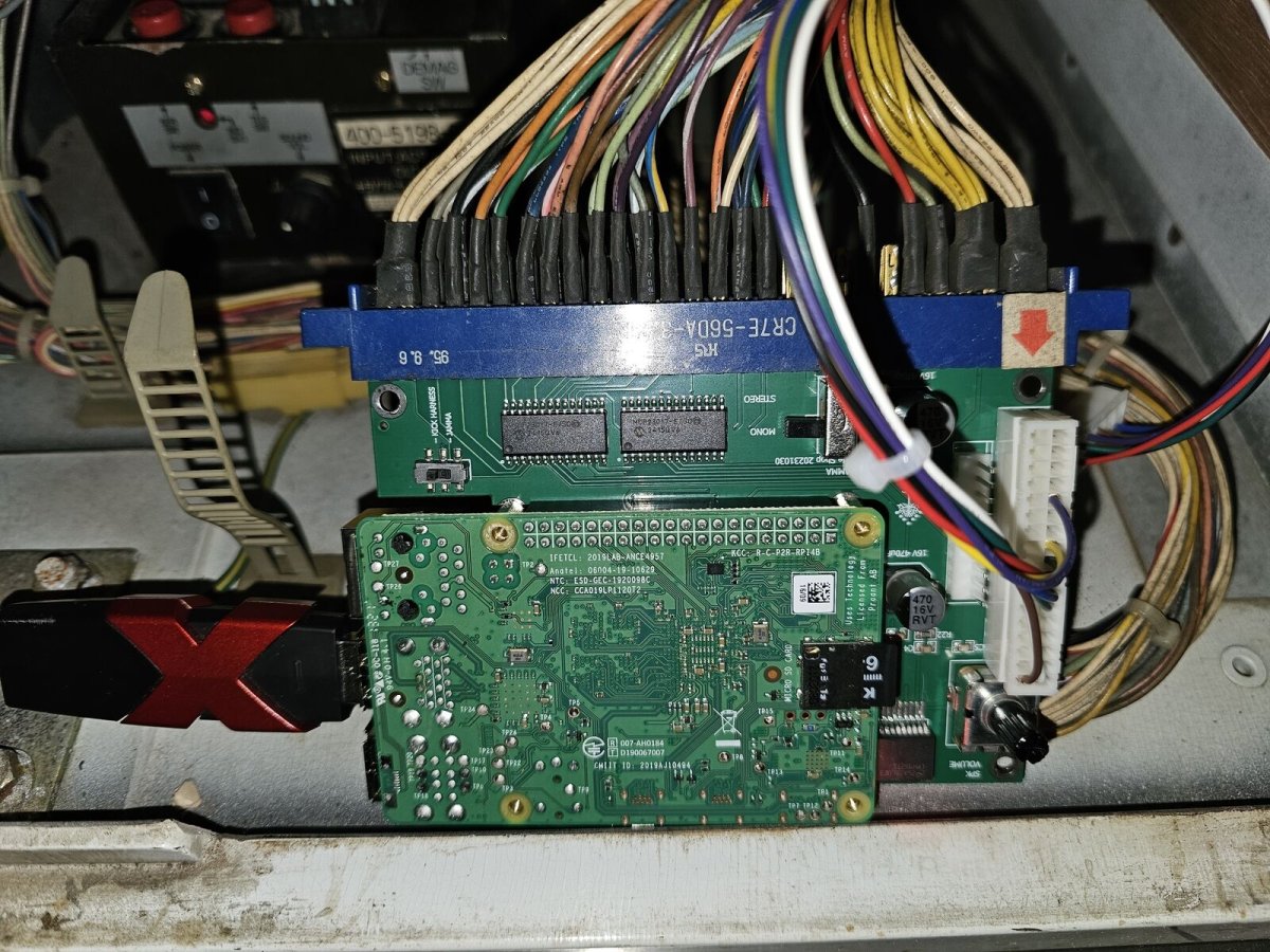

I wanted to play CPS2 games first, so I ordered this Sega Astro City CPS-II Arcade Kick Harness from misteraddons.com

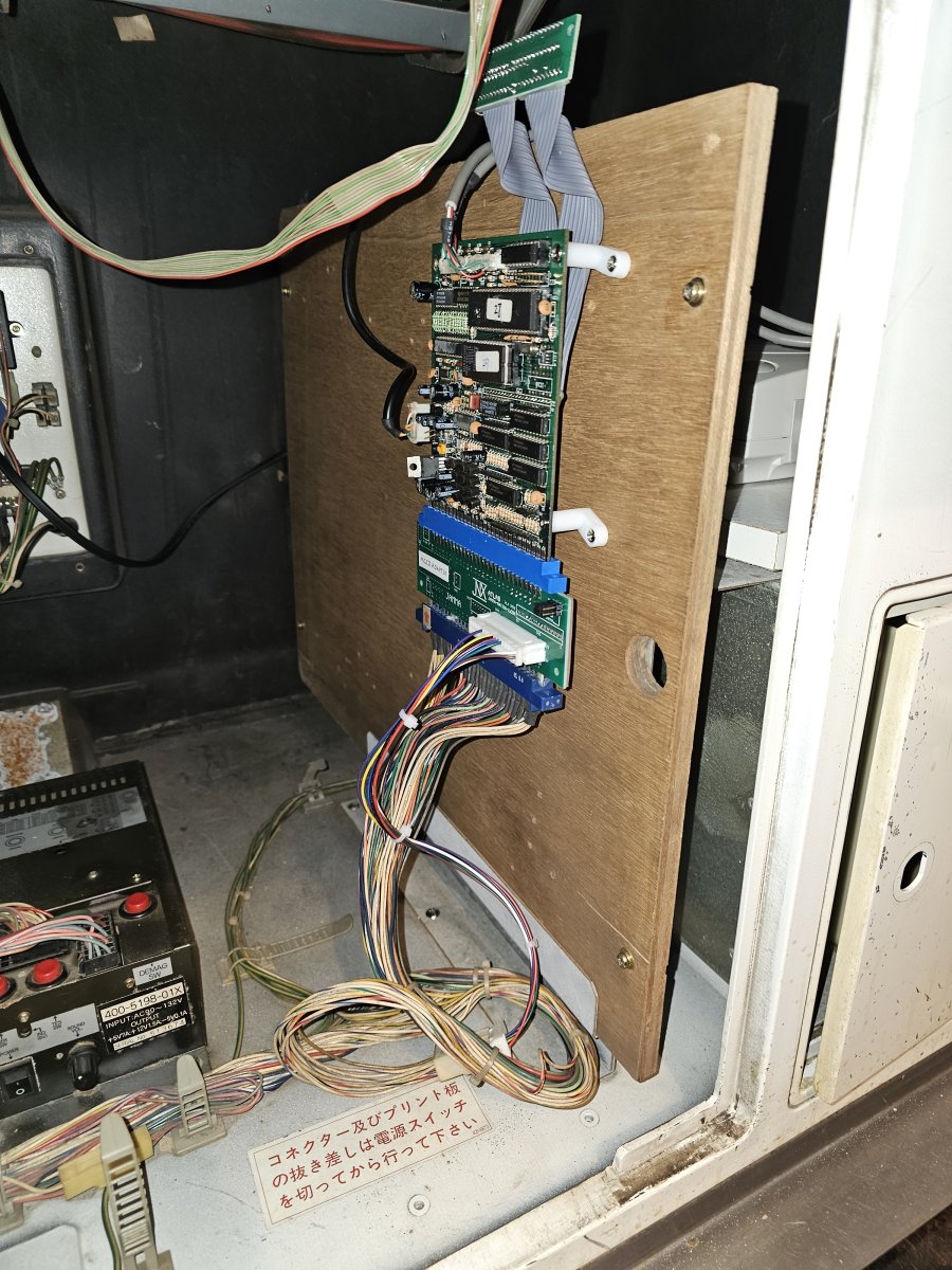

I found it on ebay. It came with the A + B board, the battery removed, and an arduino installed. I also picked up a Street Fighter Zero B board so I could swap them out.
I still need to find a way to mount this giant thing in there.

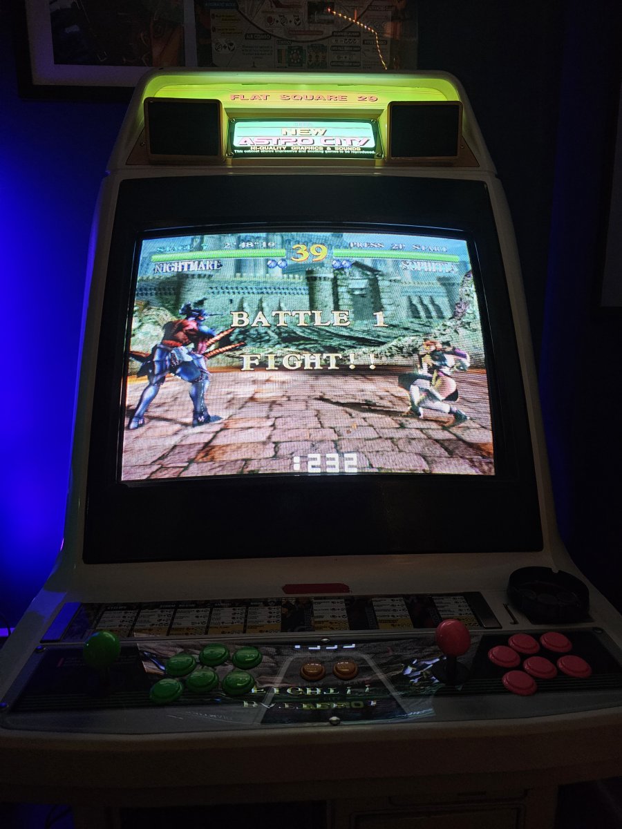

TIME TO PLAY!
I've had a few sessions now and it plays like a dream. I'm in love.
Still a bunch to do to get it looking new, but for now I am happy I get to play it.

This is the connection I'm talking about. It goes from here to the 6 new buttons (3 per side - not pictured)

TIME TO PLAY!
