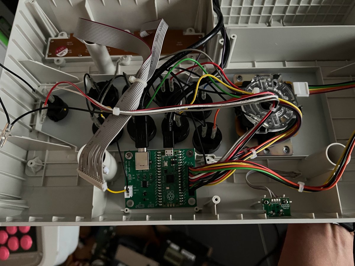

The backstory here is that I want an arcade stick that I can plug directly into my Exa Arcadia, without a external IO board. Still needs an additional USB cable for power though.
I'm using a Iona USB HID IO board now which is pretty nice, but this is an other option to do it.
Basically, what I wanted is:
- Only P1 controls
- No JVS daisy chaining support
- Need to work for all my JVS equipment
- Compatible with the lower latency JVS' spec that Exa is using for new games
- Compatible with Brook Board wiring cables, so I don't need to make my own cabling.
I have a td-io JVS IO setup for my Naomi, and since that is open source, I made a small scoped down PCB using the tranceiver circuit from there. Since I only care about p1 controls, I removed the shift registers and just wired the inputs to the pico directly, and modifiedthe firmware for this instead.
Turned out like this:
This is the first prototype, and I have some improvements I'd like to make for a v2.
Wont be selling this, but dev is open source and will end up at https://github.com/buffis/smol-jvs-io
Note that since this is a WIP, the project there might not reflect the board seen above

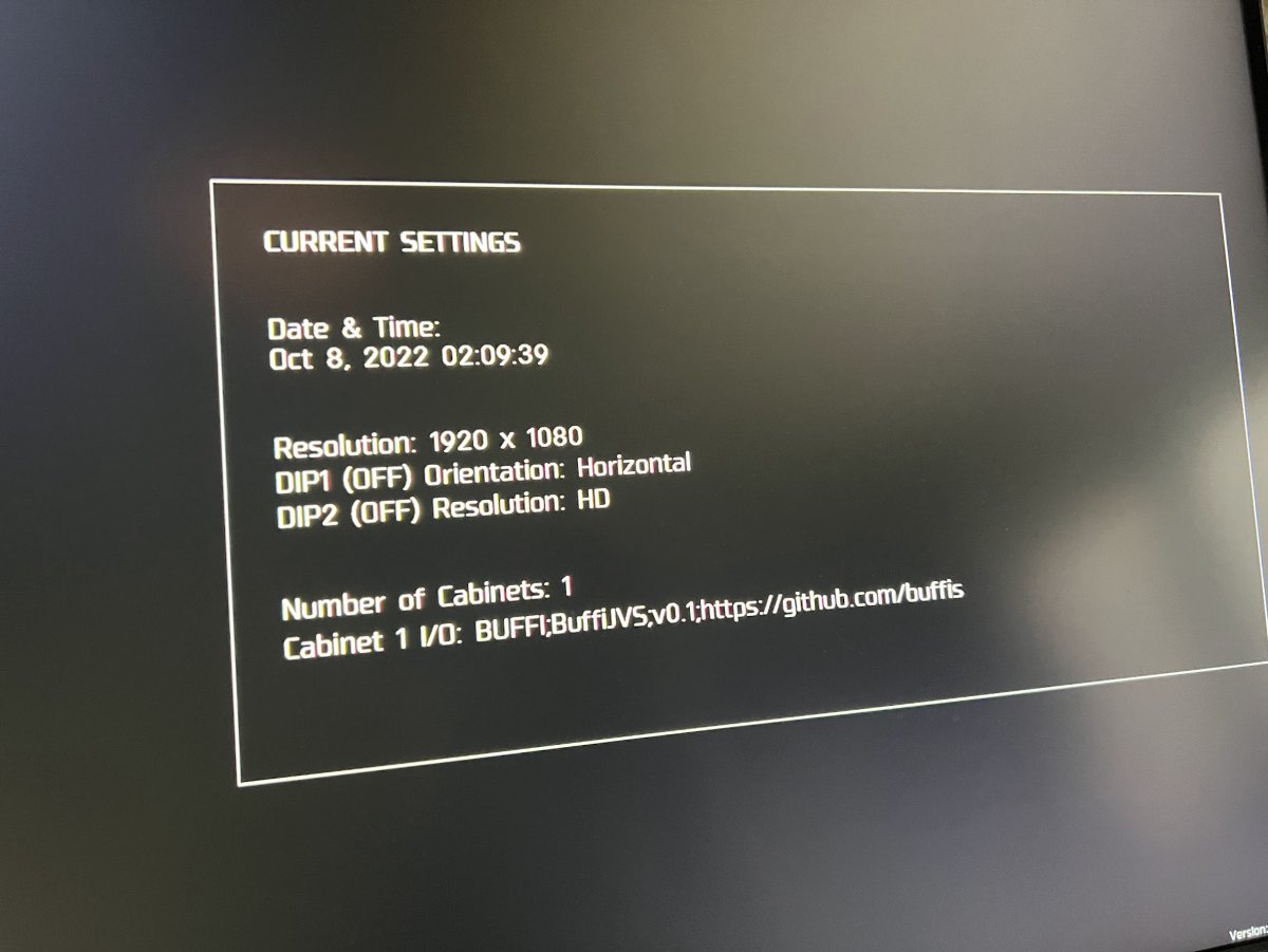

Been using this and it works real well.
Made a new ver which should be sized the same as the default pcb in the Hori RAP VX stick, so hopefully I can use it as a drop-in replacement that screws in nicely when it arrives.
Also minor silkscreen fixes, and replaced the left connector types to be compatible with "Brooks 4-Pin Button Harness" cables
Sense now also uses a resistor (like Open JVS) intead of 4 diodes, since that makes BOM simpler.
Assuming this works, it'll be final ver
