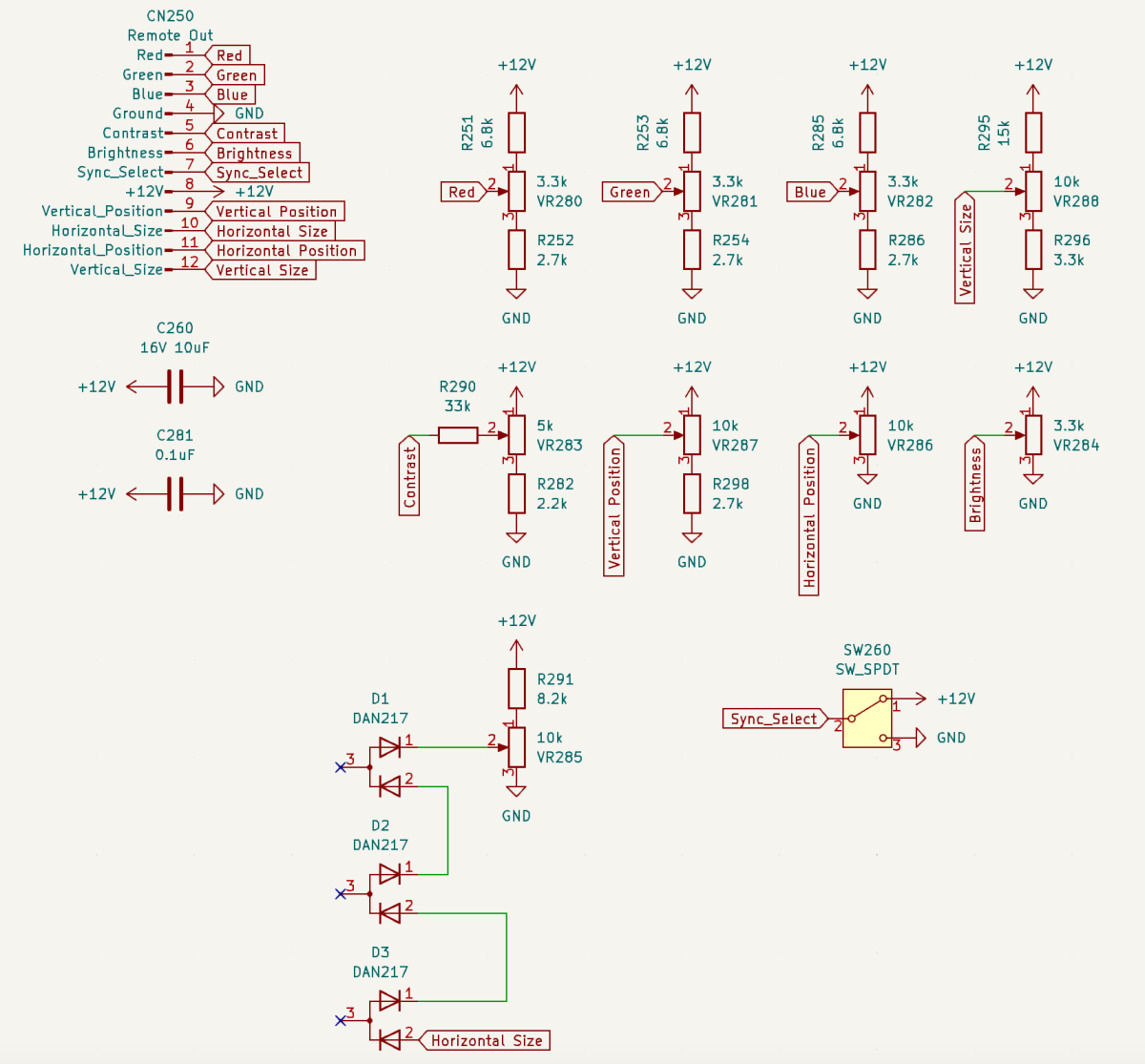

...wonderful schematic? my eyes hurt and I dream of being able to redraw the whole thing in kicad. I can't believe that's what we have to work with still in 2024
How is this? Possible issues include:
1. The parts of the schematic with the two decoupling capacitors were very hard to read, so I did my best with the board I had on hand, a picture of someone else's board, and the schematics.
2. I didn't include the jumpers.
3. This is my 2nd time making a schematic, so I have no idea what I'm doing. Did I even use netlabels correctly here?
One of my astros came with a corroded remote board that refused to respond to any desoldering so I definitely want to repro the base Nanao board -- figured I'd include this schematic I made as part of my efforts.
