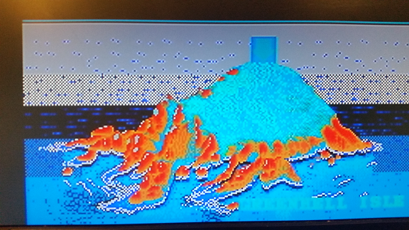

Long story short, In December 2018, I bought this board (Prehistoric Isle) off of Fleabay claimed to be tested and listed at 100% working. After receiving it in the mail and ready to play it, Upon first start up, the board was obviously 100% messed up.
As you can see here, this is what I was presented with when I powered up of the game. It basically looked like SNK were trying thermal imaging on this one as part of a special project, but it wasnt.

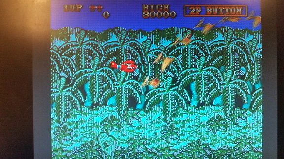

Other parts of the game had lines through the graphics like these here

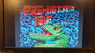

Although it took a long time to work on, I was making progress little by little which is why I stuck with it and didnt decide to get rid of it. As you can see from the pictures below, the graphics, especially the foreground ones and text were coming back once again. This was promising and lead me to continue trying.

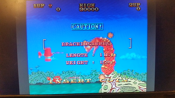

Letting it run through demo mode as well as trying to get into the game confirmed that all graphic issues had been cleared up.

Symptoms: Missing colors, Missing sprites, Lines in Sprites.
