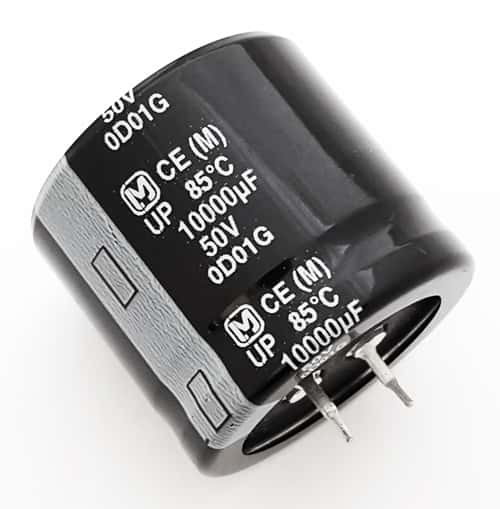

Pretty sure those are just the series, most capacitor brands have dozens of different series.
The [M] with the curved legs is the Panasonic logo.
I think UP would be the series. CE I just read means Electrolytic Capacitor, just in french. I feel like i'm being trolled from a post from 2010 but I got nothing else. (M) I think is the tolerance, +/- 20%.
