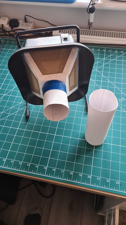

I've used one of these type of fume 'extractors' for years, I think I got it from Maplins...
It was OK but you had to pretty much have the hood right over what you were doing for the fume to be pulled in. So, I put my Blue Peter badge on and added a cardboard funnel and removeable tube to focus the draught and extend the soldering position away from the hood.
This does actually work a lot better than the standard extractor. The whole thing is still a bit unwieldy though and it's not really filtering or extracting the fumes. There are some 'carbon foam' sheets in it but I doubt they do much and I'm sure most of the fumes are just blown into the room.

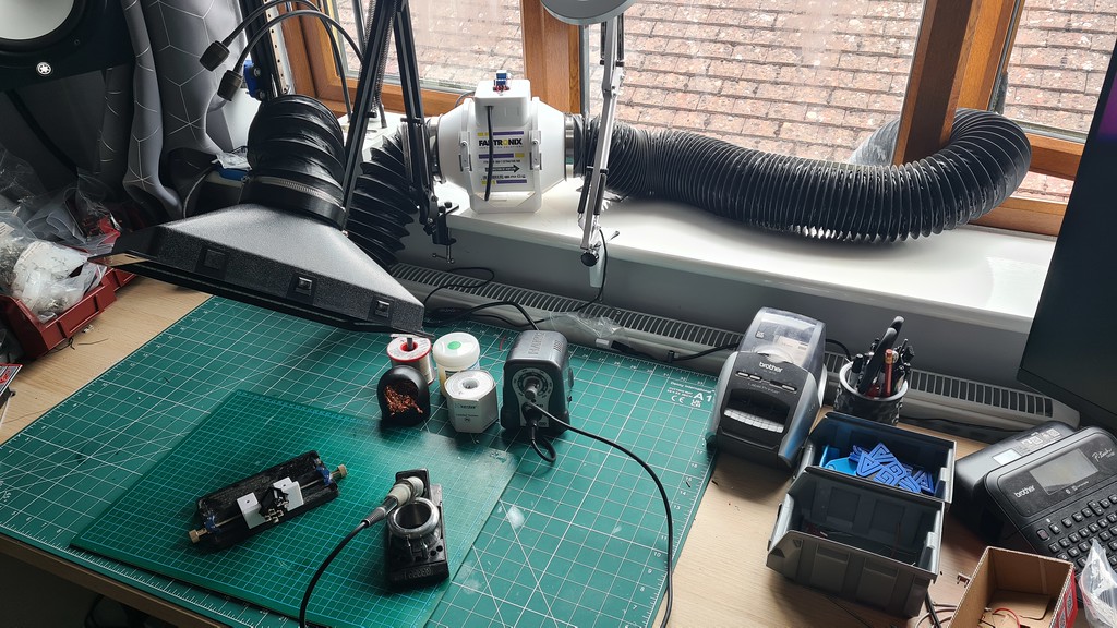

Rather than try to filter the fumes I thought a better idea would just be to exhaust them outside.

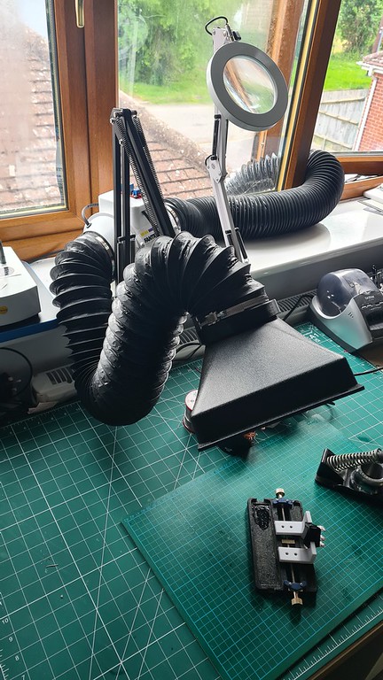

I cobbled together a 100mm extractor fan and some 100mm ducting. I was going to print a hood for for it but I found a dust collector hood on ebay which was near the right size so wasn't worth my time designing/printing. I bought an articulated mobile phone mount and printed an adapter to fit it to the hood. This provides 5 axis of adjustment and can be positioned/reach anywhere on my desk.

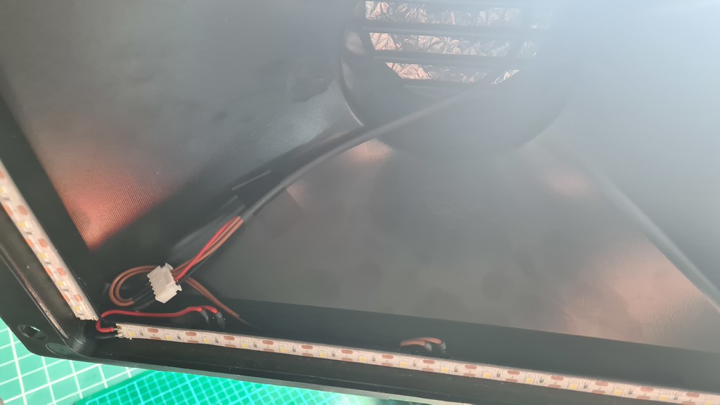

One problem I had when using the old extractor was that I got a lot of shadow/loss of light due to the tube etc blocking the light source. This was going to be even more of an issue with a large hood so I added some 5V LED strips fitted to some printed recessed mounts inside the hood.

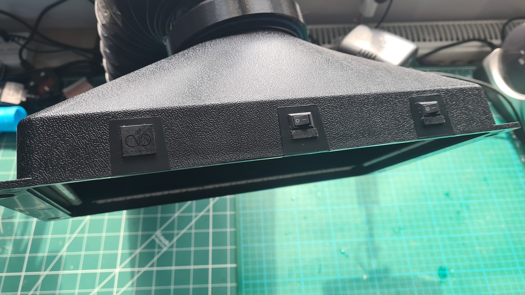

I added a JST XH connector so it can be disassembled easily if required. I also wanted to be able to turn the fan on/off from the hood so I added switches for the fan and LEDs
Luckily there were already three ~12mm square cutouts in the side of the hood which just happened to fit some small SPST rocker switches I had. I printed some blanking plates to plug the remaining cutout and gaps.

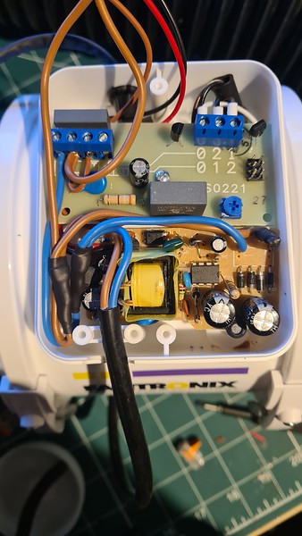

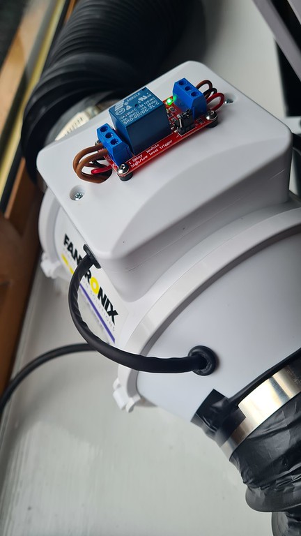

It didn't seem like a good idea to run ~230vAC near the hood though so I used a 5v relay instead. The sleeved 5vDC wires travel up the ducting and then exit out the side of the fan and then into the box on top.
I didn't have room to fit the relay inside the box so I've fitted it to the top. I just need to make a cover for it as there are bare 230vAC terminals currently.

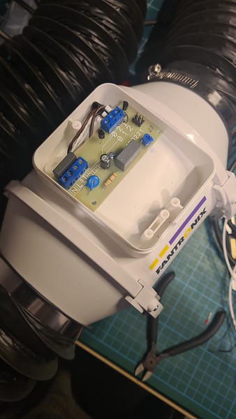

The box on top of the fan contains the timer circuit as this is where you would set the 'run on time' if connected to your bathroom lights. There was a fair bit of space in here and actually just the right amount of space to fit a decased 5v 2A PSU I had in a box of random PSUs. Switch live is connected to live so it will just turn on and off with the relay, no run on time required.

It's all a bit McGuyver but it does work really well.
