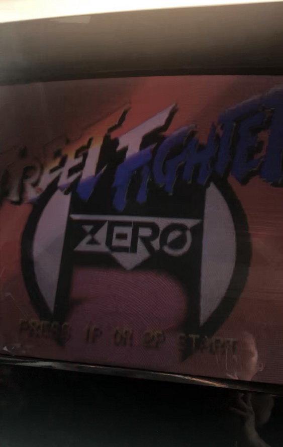

I just recapped Nanao MS2930 due to "black goop leakage" on the chasis. All capacitor I used is 85 degree specs.
After recapped, cleaning and reassembly to the cab there was some issue.
I tested with CPS2 and MVS when start the game (RAM check screen, capcom logo etc.) there is no problem.
Until the title appears (bright screen) the picture got zoomed and gone dark despite the game still running as the sound continue.
.I reduced contrast knob on the front remote board (inside control panel) to almost lowest level to keep the screen running.
The picture is too dissolve to play. Everytime I increase contrast to mediocre level the picture got zoom and vanished.
Please help!

Apparently it completely black. I checked at the cathode tube, the heater stop working until turn off/ turn on back again.

I double checked the screen pot last night. The picture became darker when I turn counter-clockwise, seems like contrast improve a little bit but the picture loss details in gray area (all resulting in black). However, when the screen "flash" the tube still shutdown.

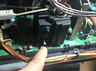

I solved this issue. The ABL was culprit!!
ABL stands for Automatic Brightness Limiter. Increasing this knob on Chassis (it placed on right hand side from behind along with other knobs) and the issue solved.
I would love to see where this is located.
Do you mind sharing a pic on the chassis?
Thanks. I tried that unfortunately.
Definitely turn this knob during testing if your tube isn't blown though..
