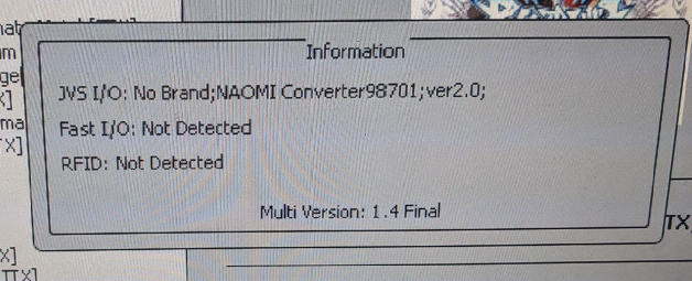

Hi all, I just setup a Taito X2 using Niko's awesome multi, everything is working with the exception of BlazBlue CS2. I get an I/O error when it launches.
I am using a Capcom I/O v2 per the information screen on the main menu. Any tips on this would be appreciated

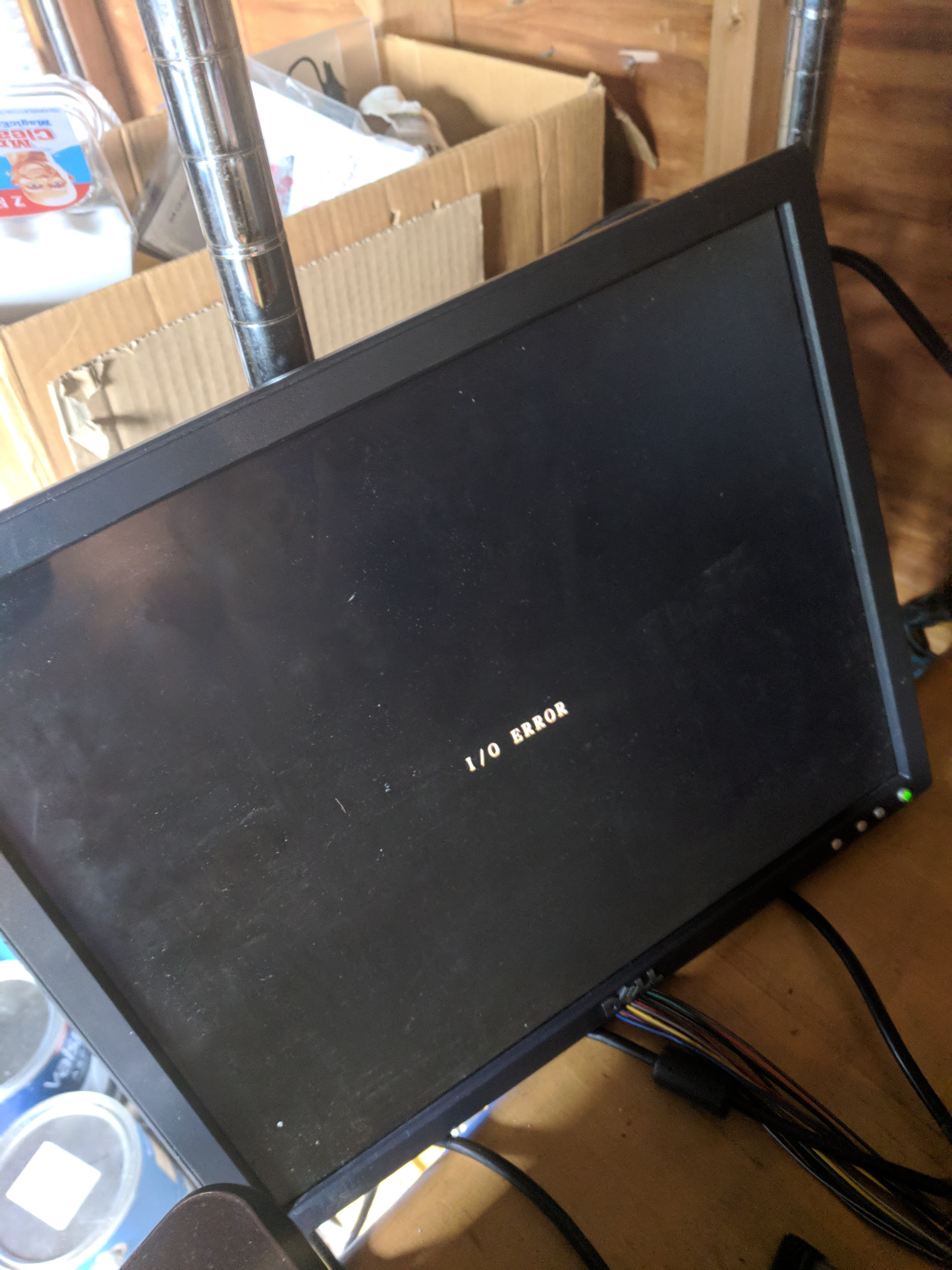

What type of error do you get?
Can you post a pic of your error screen?
Picture is attached, it simply says I/O Error. Not sure if the Capcom I/O doesn't work with this game or if I have something out of place.
Thanks
Ah sorry, missed it while browsing on my phone :)
Maybe @Niko can pitch in here? Don’t have a Capcom IO anymore to test, not sure what CS2 expects from the IO, perhaps double coin meters like KOF:XIII?
I'm willing to bet you have a iDmac PCI-E card in your X2.
CS2 is the only game that naitively supports both FastI/O and JVS. The game determines which I/O to use based on whether or not it detects an iDmac controller card. So if you have a iDmac and your not using FastI/O it throws a I/O error.
You have two options,
1.) Remove the iDmac controller card from the X2.
2.) Rename the iDmacDrv32.sys file in "C:\WIndows\System32\" ( I think, you may need to search for it. ) to something else.
Let me know if you still have problems.
