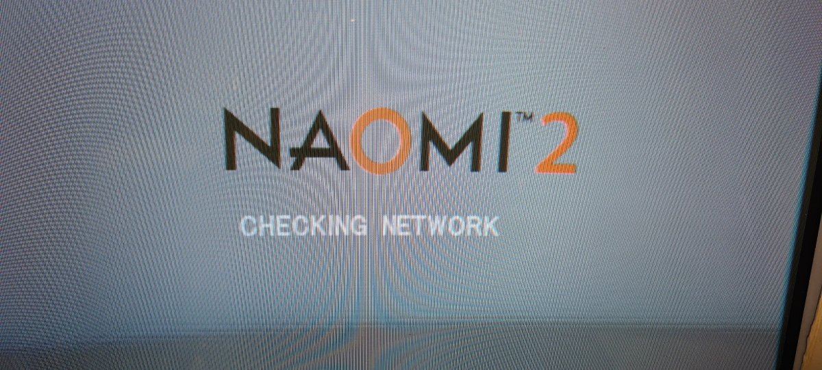

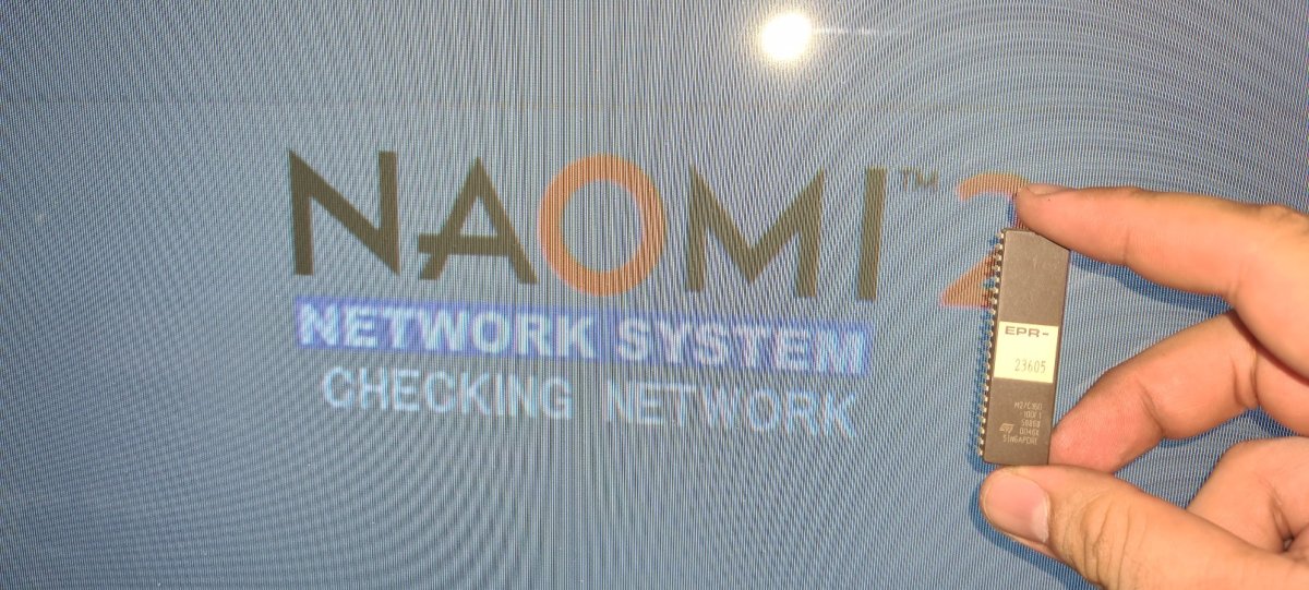

Hello all a long time ago I purchased several naomi dimm with firmware 1.02 and a couple of separate network cards, my question was when currently the dimm from 1.02 to 4.02 did not appear anymore the phrase "Network System" under the naomi logo still it loads normally the network wired games, but I can't get into the naomi network options in the Test menu.
Why is this happening? Is it the firmware version?

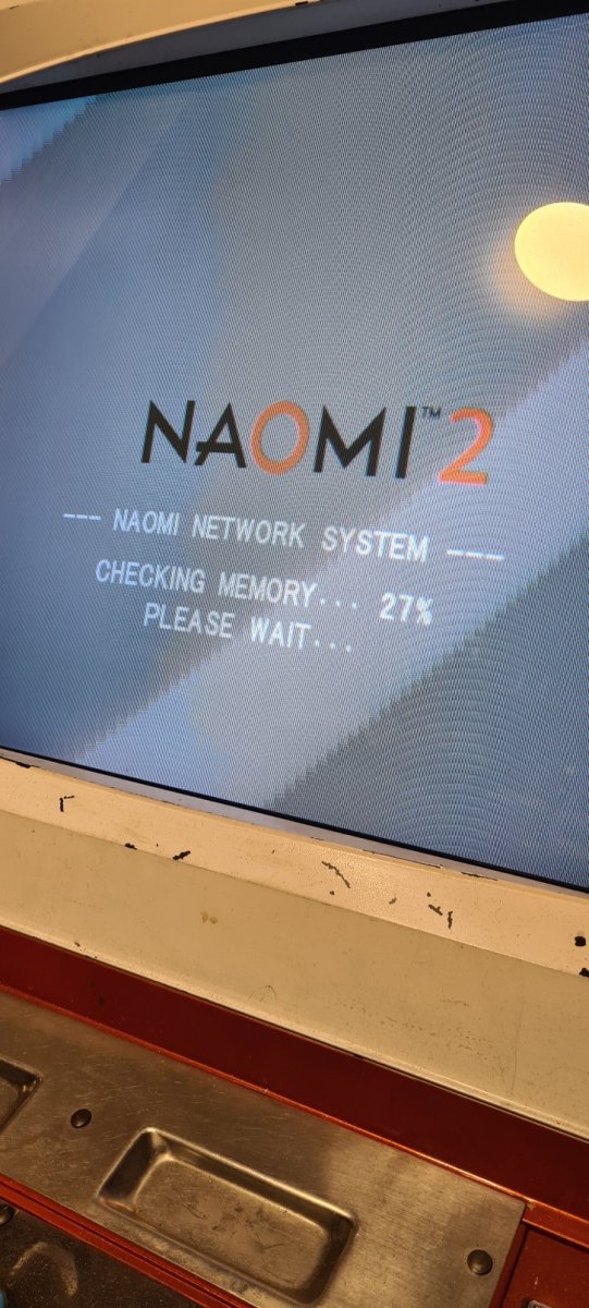

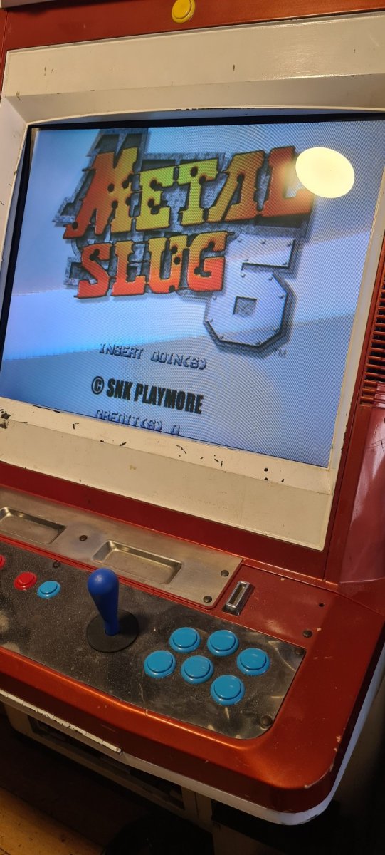

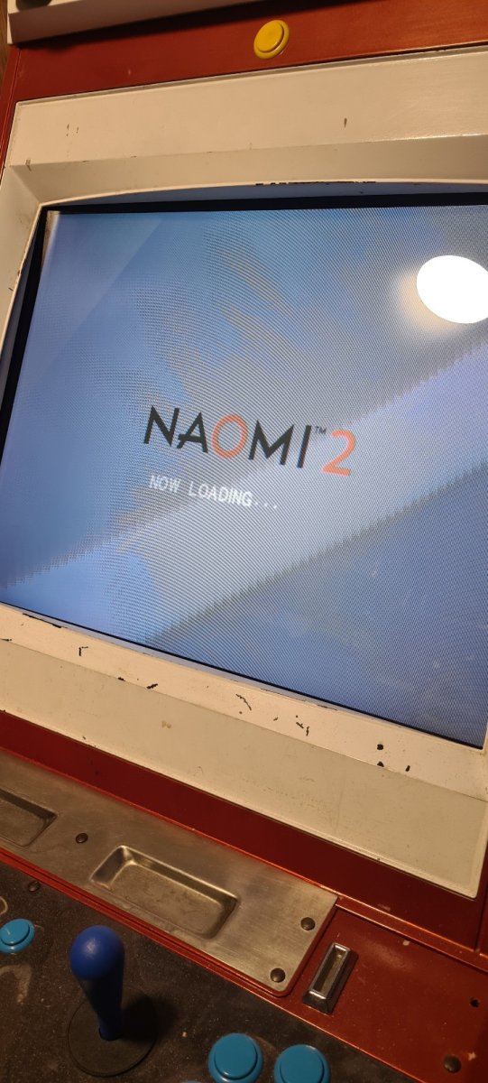

problem solved, ignorant had the Japan 23605 bios installed which is not compatible with ethernet system. 🤦‍♂️
