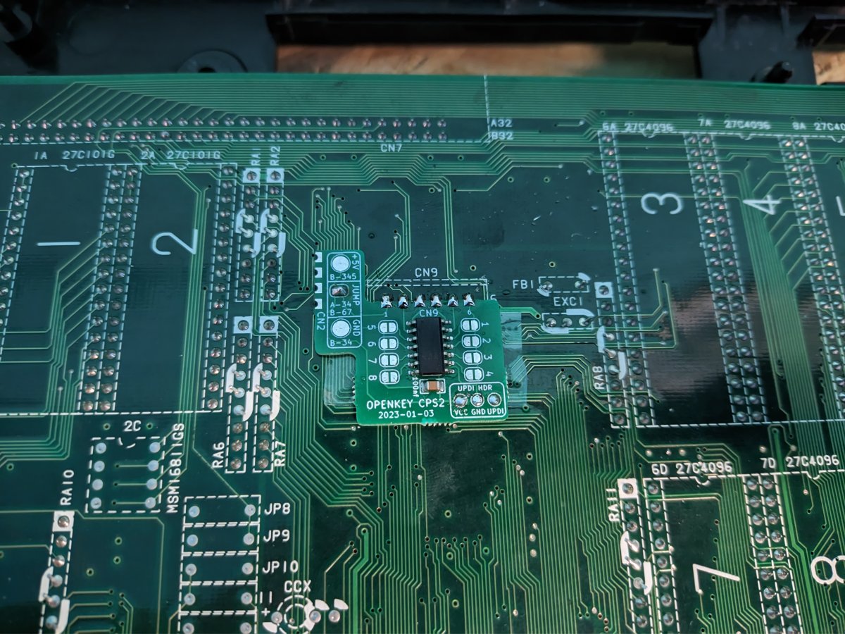

Hi. I have experiencing an extrange problem with this Openkey. I have installed it carefully on 5 games, it boots correctly on any Astro City, hantarex or intervideo power supply, but not in Blast City cabinets.
I have tested the problem in 3 Blast City cabinets, it's a mysterious error. On the other hand, I have another CPS2 with undamned's Infinikey installed, and it boots on all the machines (even de Blast City ones).
Has somebody the same problem? I think it's a problem of timmings and coordination of the ATtiny404 with these supplies. The example:
- Blast City, no boot
- Astro City, codes injected
- Blast City, boots because the Astro City injected the codes a minute ago
- I change one jumper to force injection of another game. It boots on Blast City misteriously
- I return to Astro City, black screen because they are incorrect codes
- I return to Blast City, black screen because on Astro City it injected distinct codes
How odd!

What I have really clear is that the Openkey isn't activated for injection on Blast City. Forcing to inject the incorrect codes when the board has the correct ones is the key.
I looked into this a little from our PMs. The only thing I can think of is its taking a while for the powersupply to get up to 5V. With the Attiny's lower end operating voltage, perhaps its kicking off the programming cycle before the powersupply has made it high enough for the cps2 board to boot. As a test try adjusting the initial Delay() to 5000. This will cause openkey to hold off for 5 seconds before trying to program.
Checked. On Astro City the game has a reset after 5 seconds (it's writting the code).
On Blast City it boots (thanks to the previous injected codes), but not makes any reset after 5 seconds. "setup()" code is not initializing inside the ATtiny404.
Discovered the problem. It fully works with startup time 16ms, not 0ms like the tutorial (the option you use to flash the ATtiny). I have tried even 64ms and still works, but the minimum quantity of ms for making it works is 16ms. Hope it is for use for other people

I agree it sounds like low 5v, i've seen CPS2 boot as low as 4.5v before (coincidentally a blast city pre recap). I'd be curious to know VCC measured at an IC.
Upramp time of PSU can do weird things. For example I have a crystal oscillator of a certain frequency that vibrates at the wrong harmonic if 5v is locked onto during PSU upramp beore the PSU reaches the full 5v. I have to physically delay power to it with a relay when using meanwell PSUs, or it oscillates 1/3 the proper speed.
I had this same problem with openkeys and infinikeys alike however my problems were exclusive to rev 3&4 boards. DId you experience this on rev 6 and 7 boards?
Yeah, it works on Children of the Atom B-7

In my case I burn the chip with jtag2updi, burnt on an arduino nano setup. It leaves me to config that option of timming
EDIT: I have been reading and on ATtiny chips isn't necessary to burn again the bootloader. The ms startup time is a variable summed on the compilation/uploading sequence
