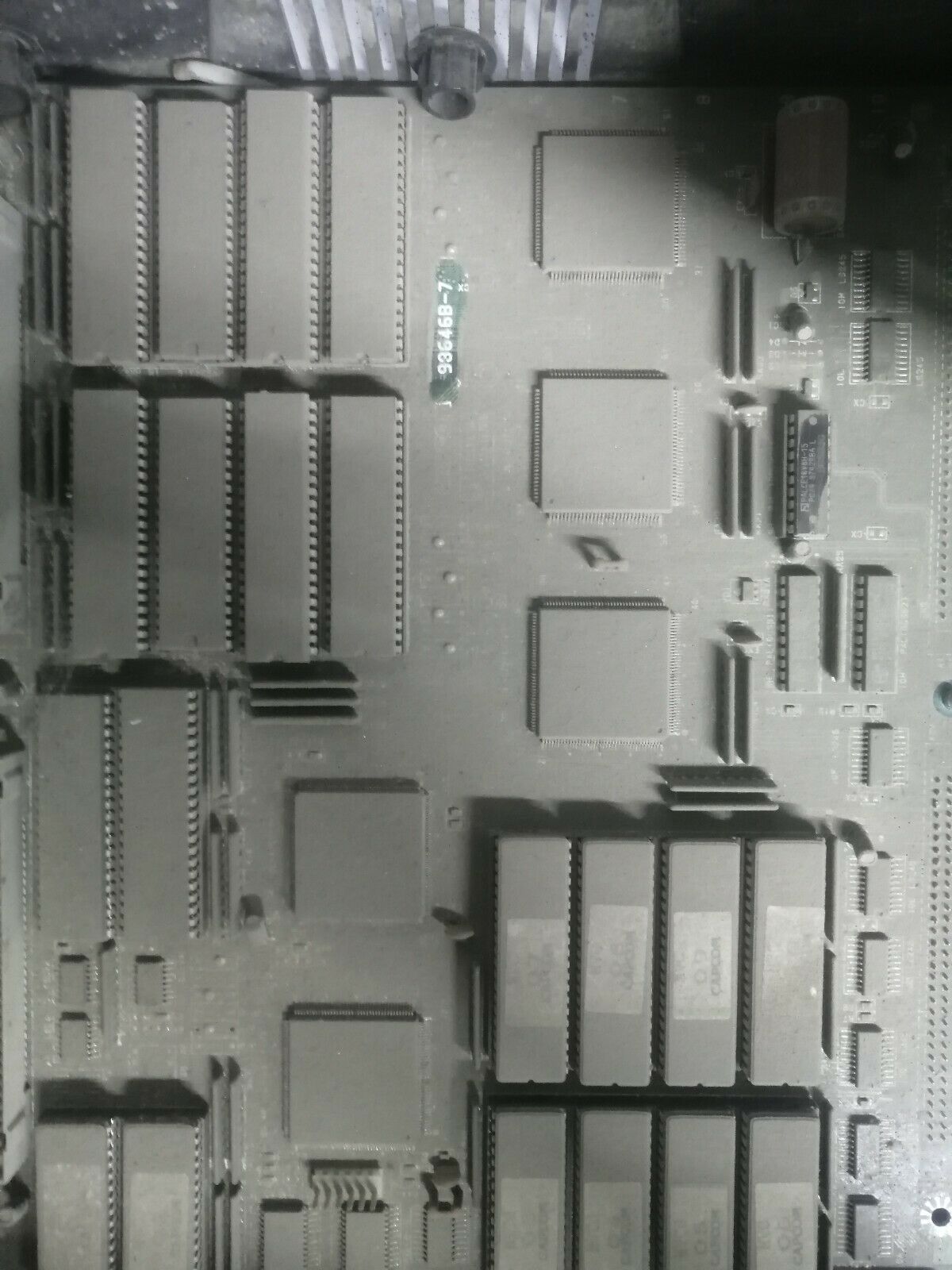

This but it was a combination of not pressing hard enough and the boards being really nasty. (here is a pic of it when I got it) I cleaned both a and b board with Water and soap (I know some people are going to go mad when they read that) then used compressed air to get all the water out.

Yikes though at that board when you got it. Mine was dirty but that looks like somebody tried to cover it all with something.
