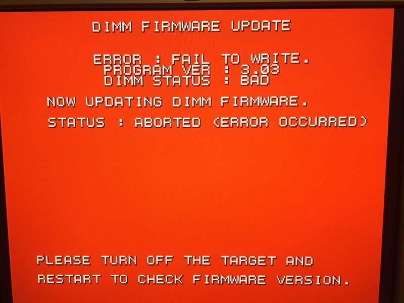

I have a problem with my NetDIMM... I'm currently on version 3.03, booting games with Raspberry Pi and Piforce Tools is working fine.
When I try to update the firmware, I get a "Fail to write" error:
It doesn't matter if I try the 3.17, 4.01 or 4.02 update, the error is always the same.

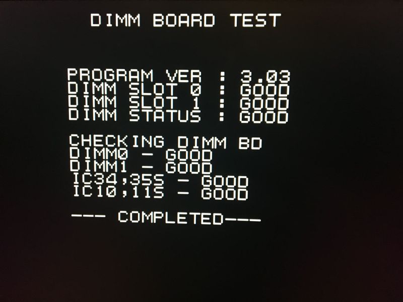

The Dimm board itself seems to be fine, at least that's what the test says:

It could very well be a bad flash chip but also could be a bad ram stick. They tend to test good in the dimm test even when they are bad.
Try using only one ram stick in the dimm during the update. If that fails try the other ram stick by itself. If both tests fail then your flash may be bad. It does happen. Especially if it is a Sharp chip.

Failed to write makes me think the flash chip is bad. ;(

Ok, I got it!
I opened up the Dimm-Module removed one ram stick, fired up the update and it worked straight away!
Now all I have to do is test whether it's the stick or the ram slot that's causing problems.
Today's lesson: Never trust the dimm test!
Thank you very much, guys!
Make sure also that both RAM sticks are the same type. It can be pc100 or pc133 but you cant mix the two. This will also give you the same errors you are having.
