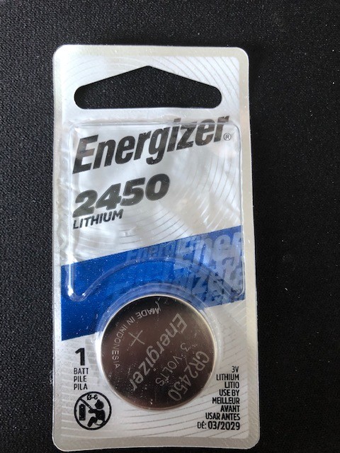

Once you know which pins to bridge it's a 5 minute procedure. The hardest part was actually having to wait for the CR2450 battery to arrive, since it's a somewhat uncommon size.

Got lucky and found a couple of these at Target a couple of towns over so was able to pick them up, almost none of my local brick & mortar places carry them.
BestBuy has them as well that is where I got mine. (got the last one on the shelf a few months ago)
