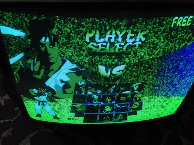

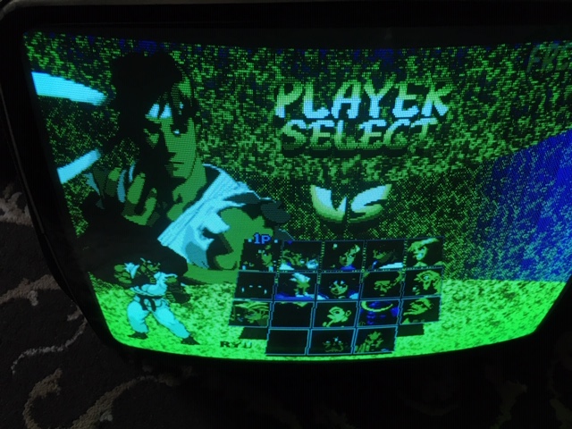

Hello,
Has anyone seen this issue.. when the monitor is turned on, the colors are not all there.. it is all green and seems to be missing the red colors or something..any ideas beside caps?

@nem - this is what happens since I got the cab.. I turned it on- green, leave it for about an hour, goes to normal and beautiful colors and pics. This is the average behavior. I don’t want to wait an hour to play and it is getting to me.
Intermittent behavior-
Turn it on, beautiful picture from the get go, then green in a few minutes, then normal in about 25ms with beautiful picture.
Turn it on - green and colors don’t change at all not even on for an hour..this behavior is rare but does happens
It's just a poor solder joint. Technically the wrong term for this, because it refers to a solder joint that was poor in the first place. However, in this case the drive transistors running hot have likely cracked the joints over time. Usually the PCB around the transistors turns visibly darker too.
Anyway, it's an easy fix. Just put new solder on the joints, add jumper wires if the pads come off. I would also spray contact cleaner on the pots and turn them a few times from end to end (take a photo before hand if you don't want to calibrate the monitor again).

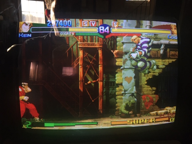

@nem - it seems that you were right on the money on the monitor cold solder. My friend agrees with you and is taking care of the problem.

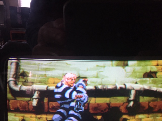

another question for everyone,
on the second cute different monitor.. we will call this one monitor number 2.. on the upper part of the monitor, there seems to be two or more lines missing, there is a blank gap.. this appears about two minutes once the monitor is on..please take a look at the picture..what could be the issue?
Does it go away at some point?
it goes away only when I make the picture smaller from top to bottom but I loose 1/2 inch of real estate from top to bottom and the character and game does not look right, they look A bit squashed.
Yeah, I don't know why that first scan line is off kilter. Possibly something you'll have to live with.
