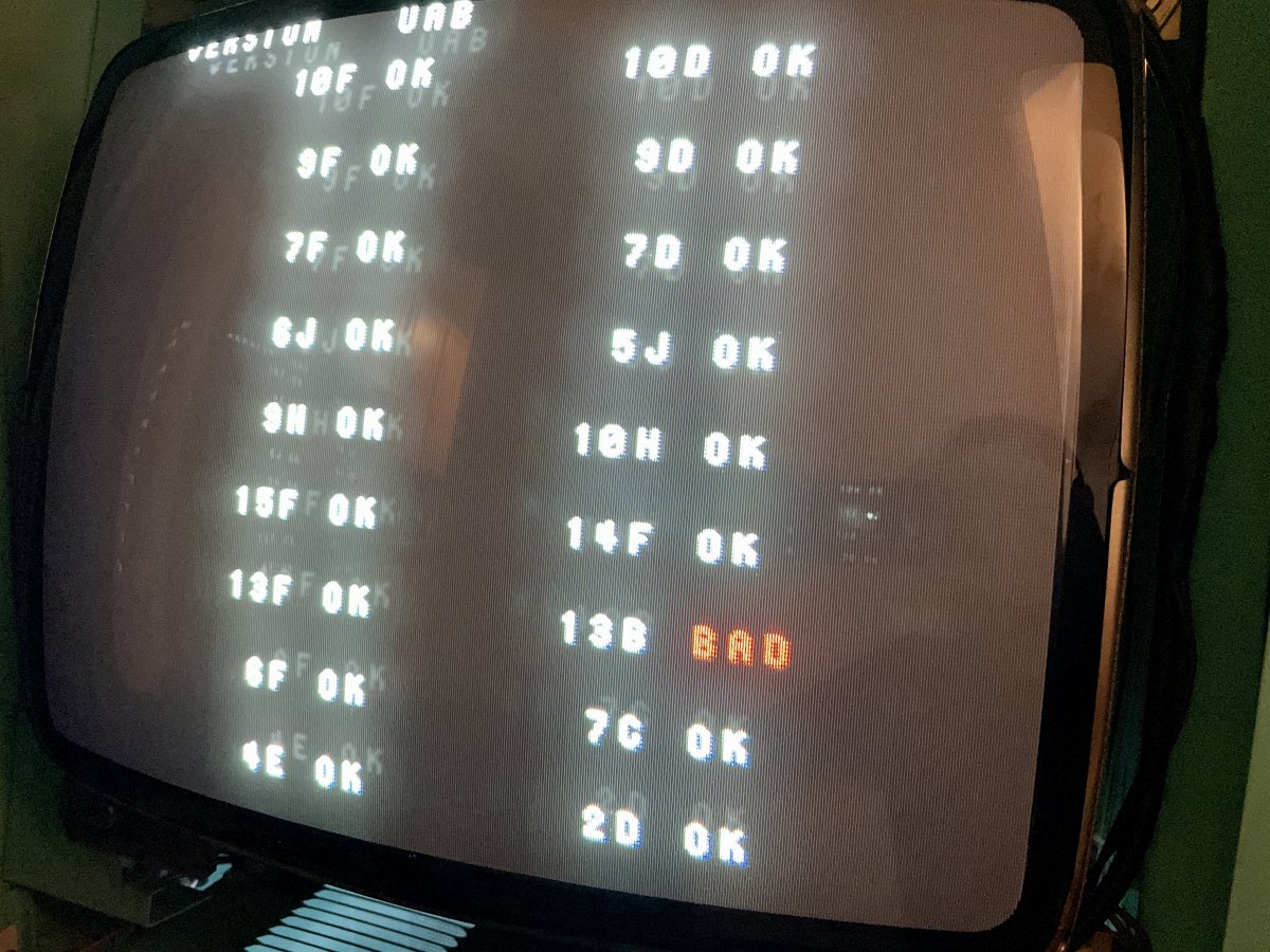

I have a Konami 4-player X-Men board I’m looking to convert to 2-player. I replaced the mask ROMs at 10D and 10F with burned EPROMs with the corresponding 2P files from xmen2pu but now I’m getting a RAM error At 13B. The RAM error goes away if I replace with original mask ROMs. The EPROMs were burned for me by BuyICNow. I successfully converted a Simpsons board to 2P using EPROMs from the same order. Does anyone know where I went wrong?

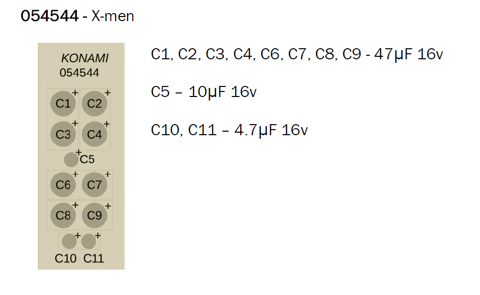

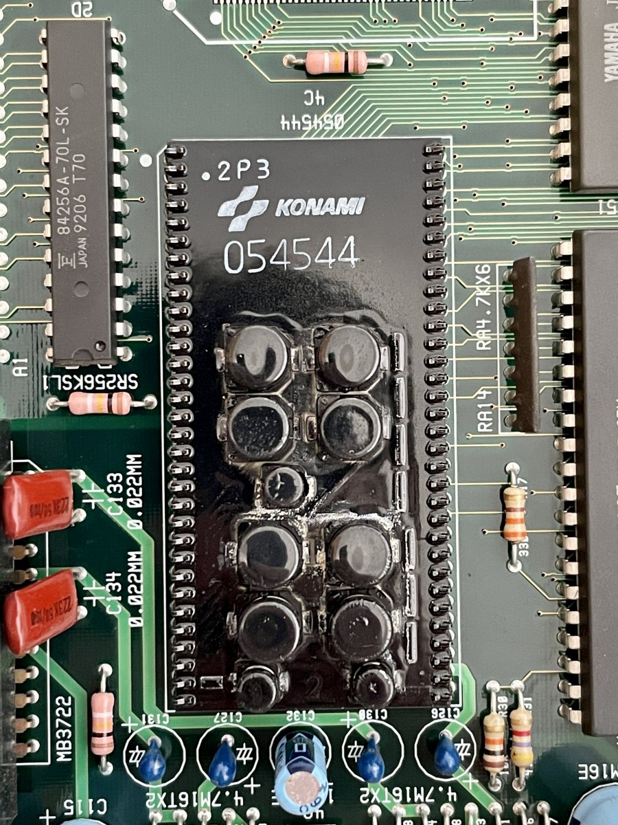

Second question; does anyone have the SMD capacitor list for the X-Men sound module? Looking to recap before they leak.
