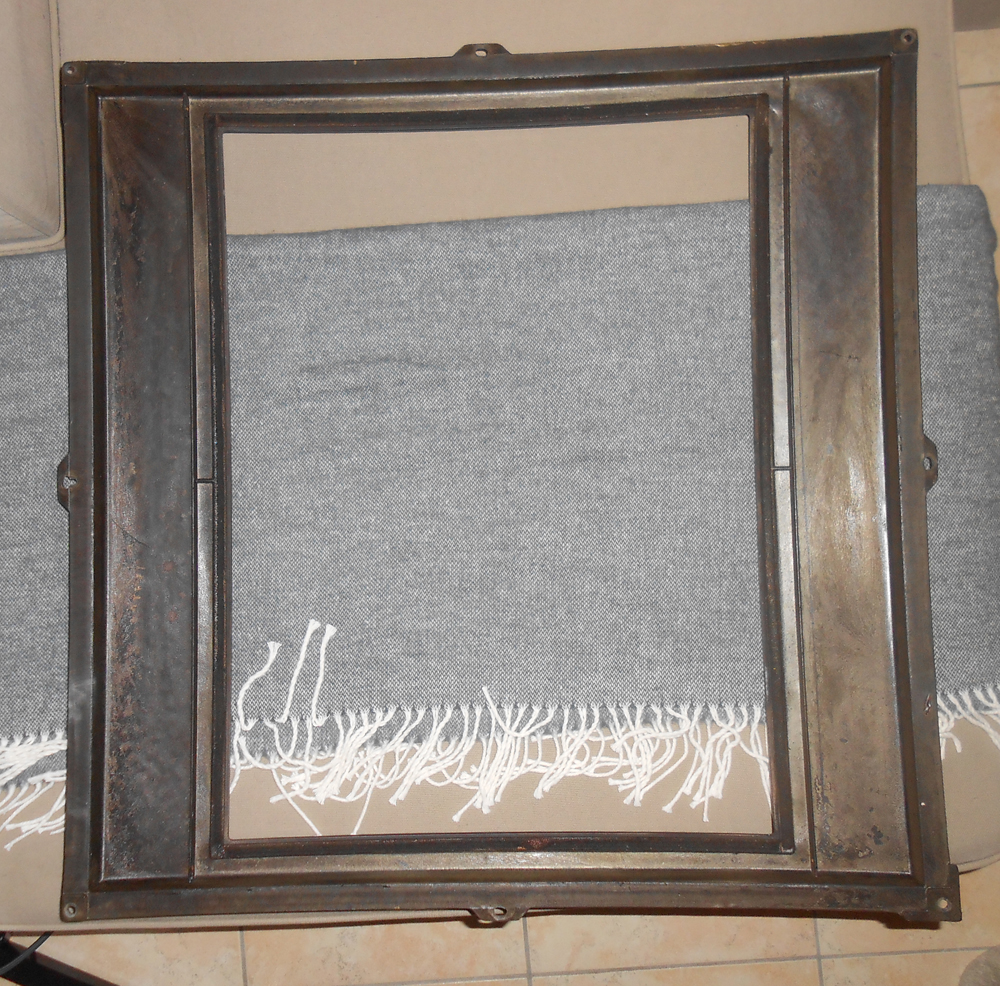

- Also, can you tell me if your Bezel is : 1. fully varnished ; 2. mate ; 3. oversprayed on the inside? Mine was so dirty that I had to completely sand it off and I have no idea about how does looks like a lucky one preserved in good condition since '94...

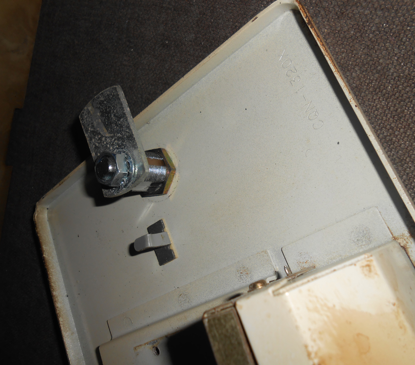

- Regarding the two small doors : the cashbox door and the coin door looks like oversprayed inside. Can you confirm this?

There is some white paint overspray on these cabinets on the inside, mostly on the front half. There should be several pictures already in the restoration threads that show this. Soap or degreaser and water is all you should use to clean the inside. The black part is a resin or maybe gel coat that covers the fiberglass and shouldn't be sanded. This applies to the monitor bezel as well. Only the front of the bezel is painted. Yours looks normal in the picture. In your other photos I see rust or dirt on the doors and oxidation on the lock tangs.
