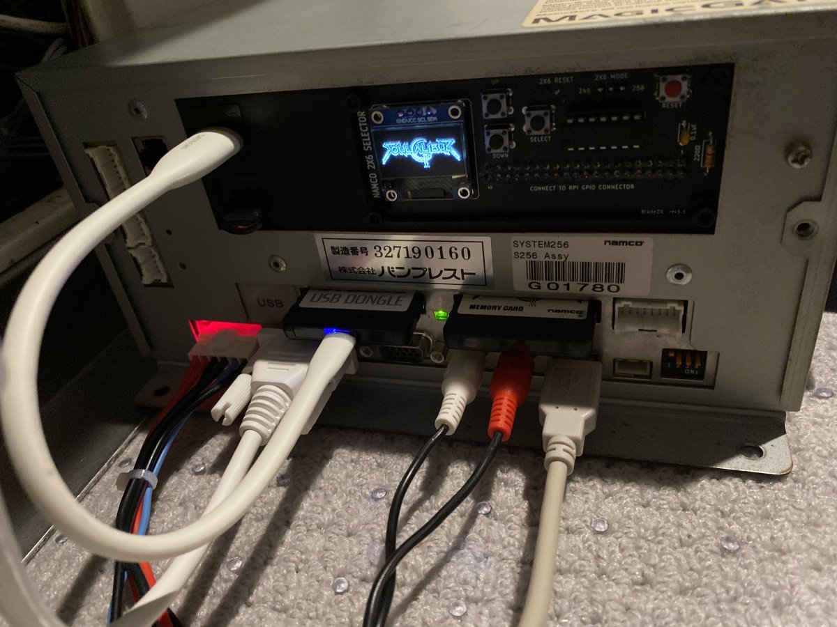

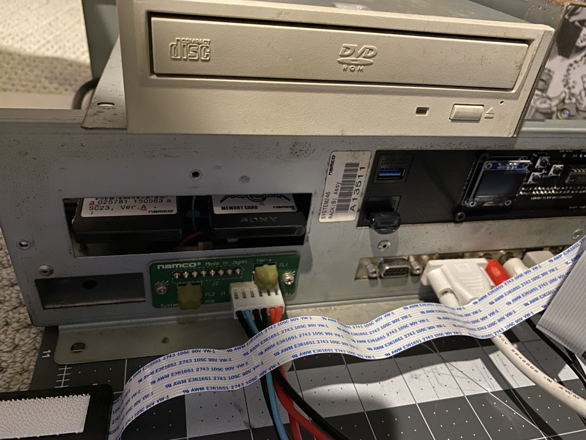

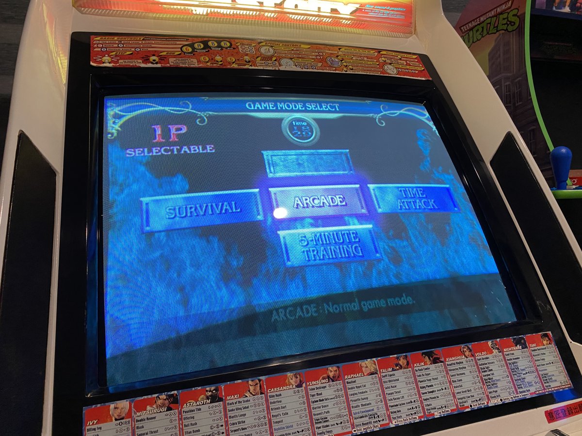

I was testing out the multi 2x6 setup and went back to my dvd rom and original memory dongle and card. Conquest mode is now missing from game mode select. This was working fine before I added the multi setup. Anyway to get it back?
You’re possibly using an early version of the disc which has it locked, you need the version D disc/ISO.

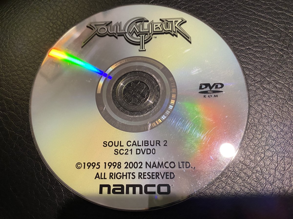

This was the original disk that came with the 246 and the two memory cards. They worked fine. It was the main selling point on ebay lol

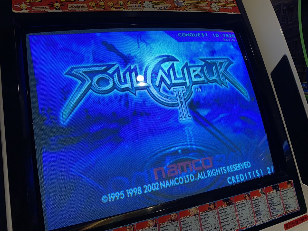

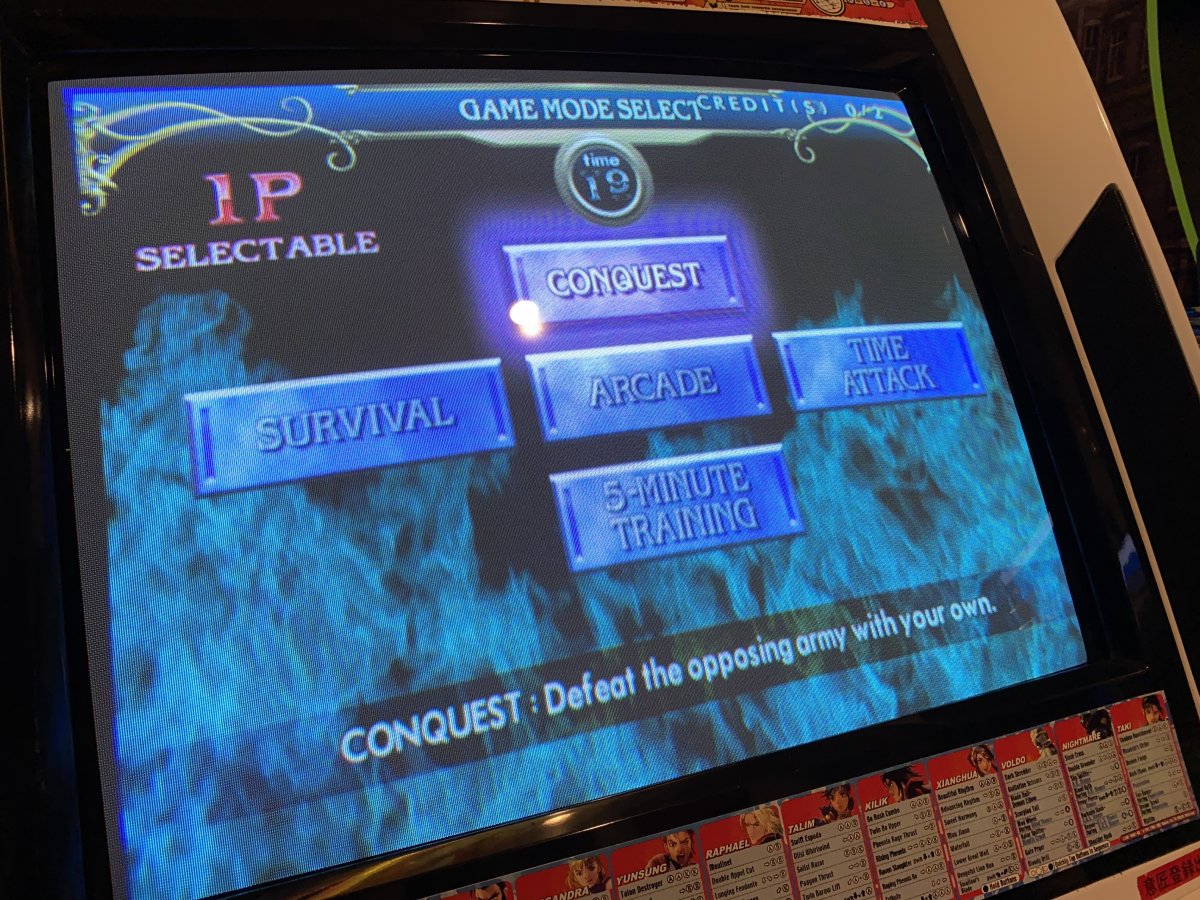

That’s version A, that version has conquest locked and probably the reason it works on your 246 is because it has been time released unlocked. Luckily the MEGA folder has the version D CHD.
  • Like
Reactions: nem
Interesting. I don’t see any documentation on time release. Do you know how long the system will need to be running for Conquest mode to appear?
I’m not sure how long it would take but version D unlocks everything by default so no waiting is involved.
