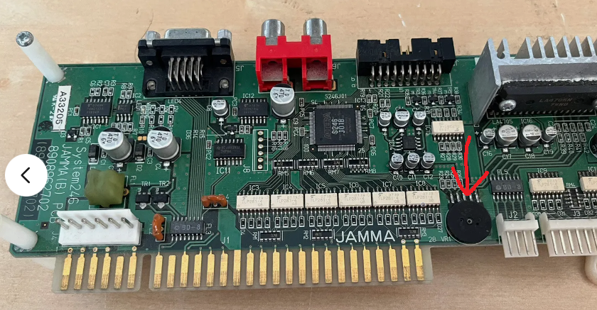

If you run it on 256 you need to make sure its in 246+ mode, on the motherboard there are 3 pins, you need to short two of them to change the mode.
Yeah, as far as I can tell I have left and right channels going where they should. I have a CPS2 that I can swap to and it sounds fine.
Yep! That was the problem exactly! Didn't even occur to me. Thanks!
