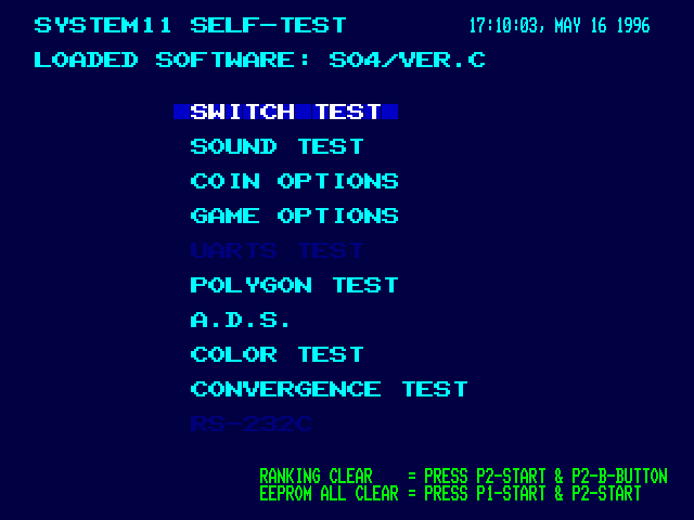

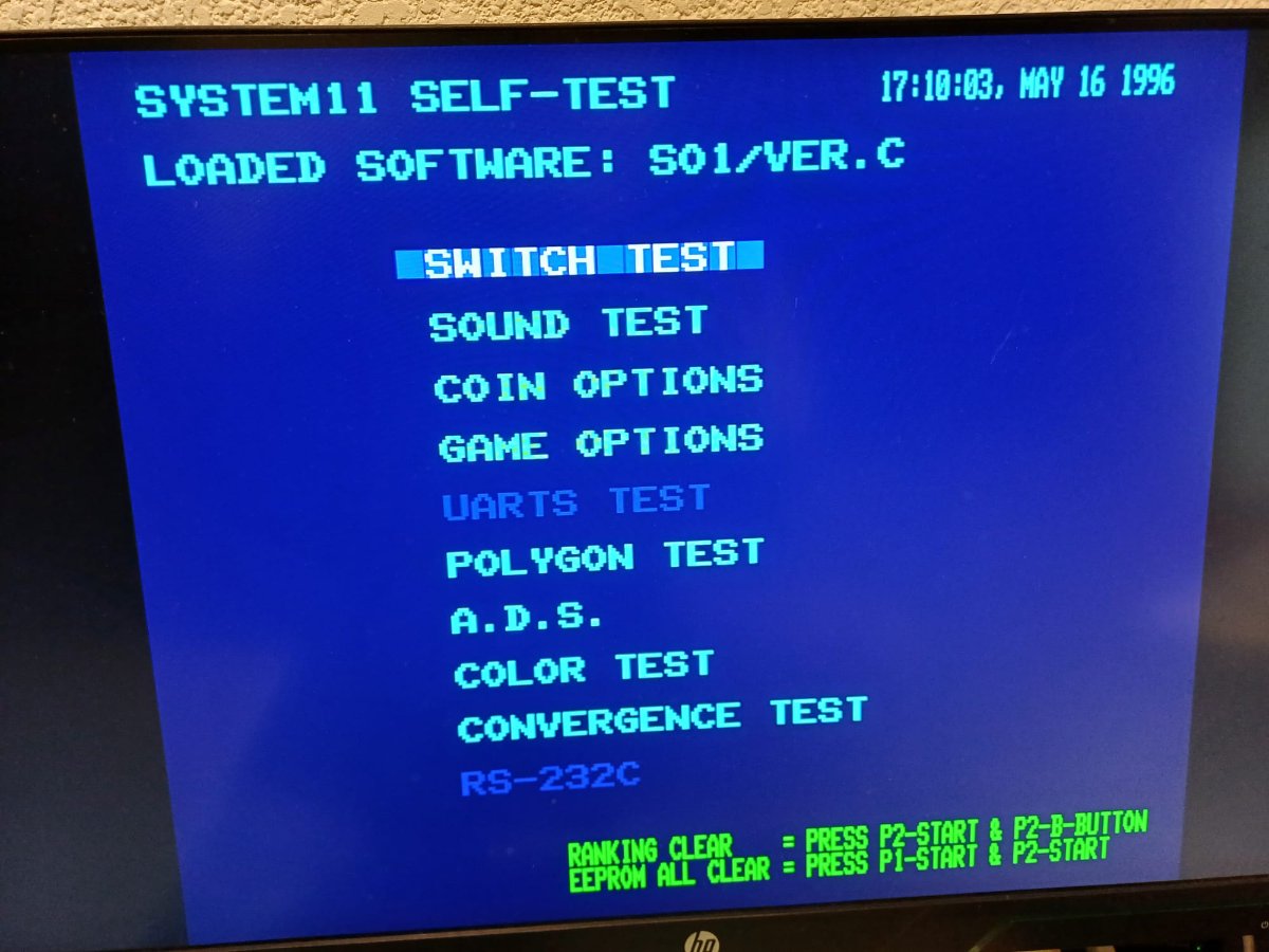

The version is displayed in the test menu.

Stickers can be wrong... you need to go by the version displayed in test mode as nem described.
to decode "SO" = Soul Edge and the number in the 3rd position is the region
1 = Japan
2 = World
3 = USA
4 = Asia
Seems you're right! we have the US and World Version C in MAME but not the JP version C

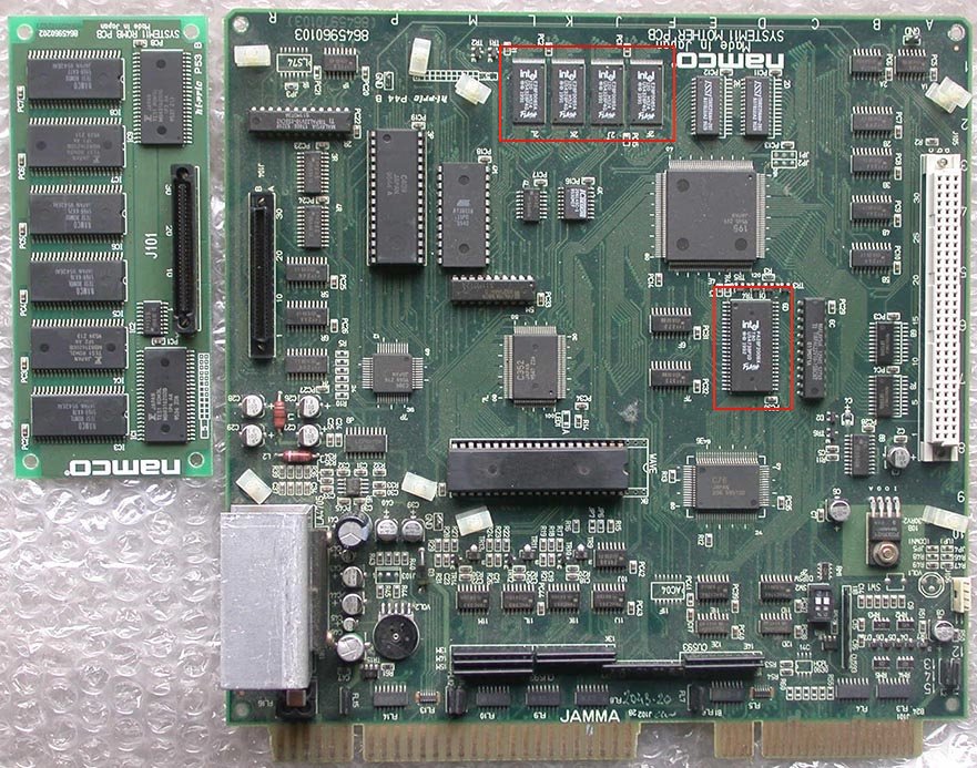

Anyone know if Version 1 can be converted to Version 2? I have a version 1 up for sale & seems like people want to buy V2.
If possible is it just a rom that needs to be burned?
theoretically yes as they use the same security key.
you need to swap out the 4 Flash ROMs on the mobo then the sound ROM.
This requires some serious soldering skills and some specialized adapters for the flash ROMs though.
Part of the reason there are so many undumped versions of System 11 and System 12 games is because dumping the ROMs is quite intense
These 5 chips need to be reflashed:
