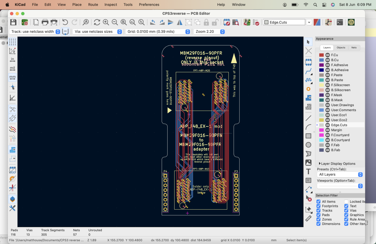

Also designed this, its a Normal to Reverse adapter for the t48. Found to the reason that no-one sells them which is that every chip maker has a different idea of what "reverse' means - Fuj is flipped x, AMD is flipped y, others pretty much reassign the pins at random.
So this one will ONLY work with the MBM29F016-PFR (if it works at all) If it does work I'll polish up the cads and share them
Edit: oops, forgot to post the link to the adapter, yes. tested and working fine, details and CADs here
https://www.arcade-projects.com/thr...-1-to-read-write-mbm29f016-90pfr-chips.30477/
