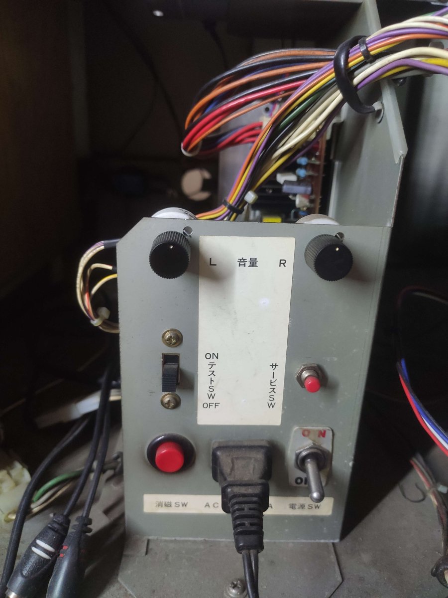

It's to replace broken Namco Exceleena volume variable resistor.

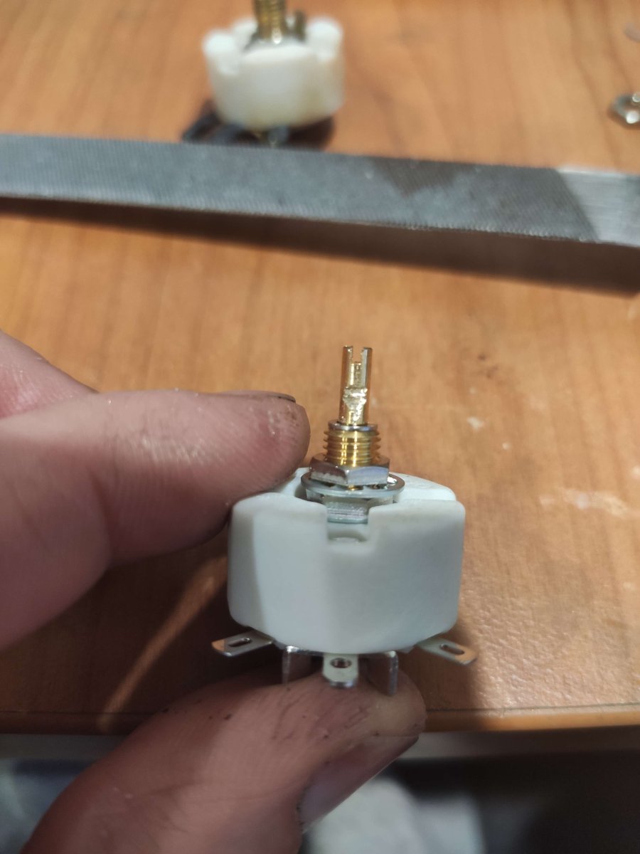

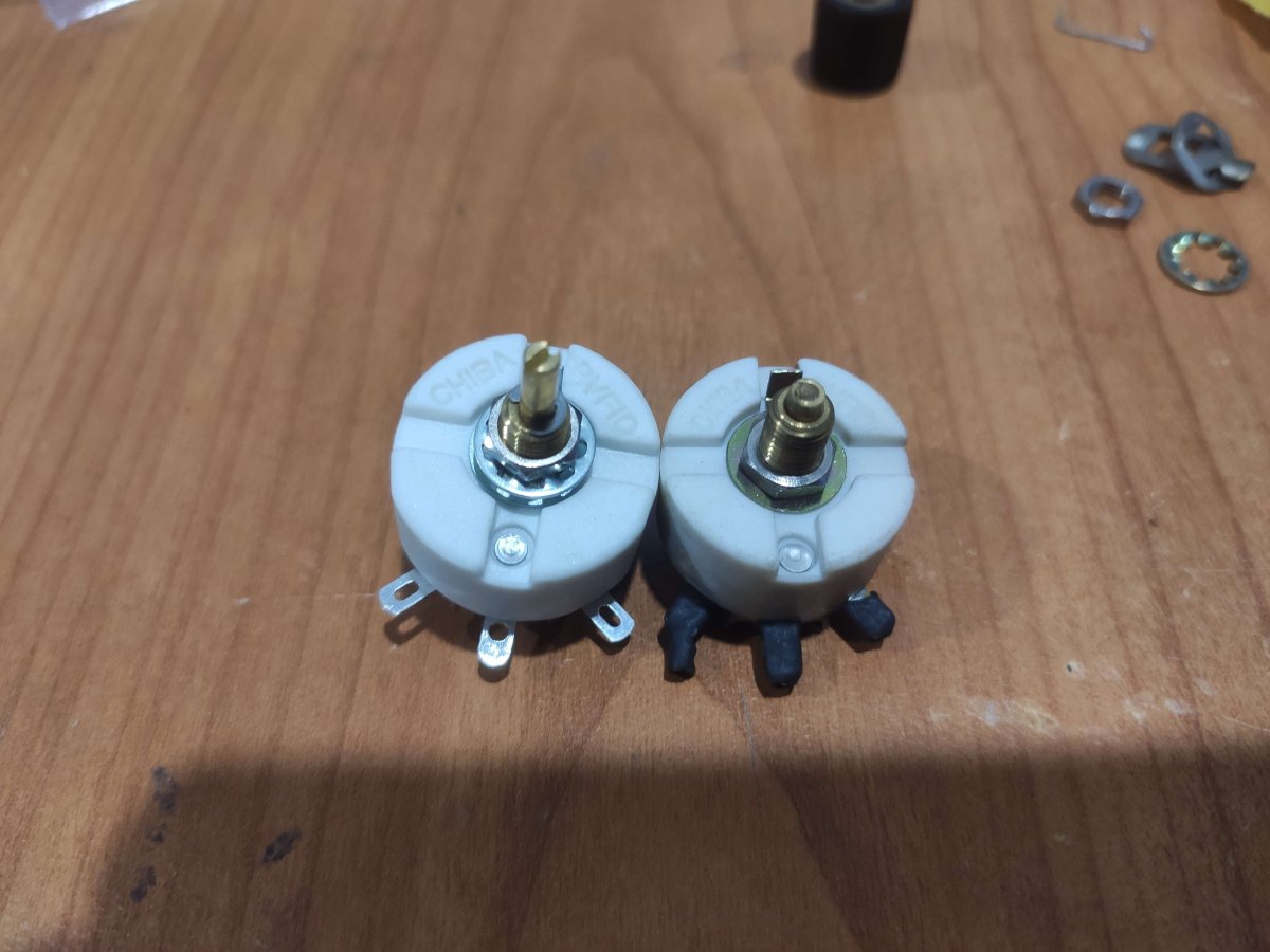

I finally got one in the mail after buying via a proxy, the part works but is slightly different.
The diameter of the white part is slightly larger and the shaft isn't notched for the grub screw for the volume knob.
I filed the shaft in the second picture and it volume knob attaches firmly, alternatively if you didn't break the original you could swap in one from a non working one.
Make sure you order the 100Ω.

Yep worked perfectly for my astro cities, the shaft is a bit smaller but you can just adjust with a small flathead. Thanks a gain to @kikaso for getting these for me.
