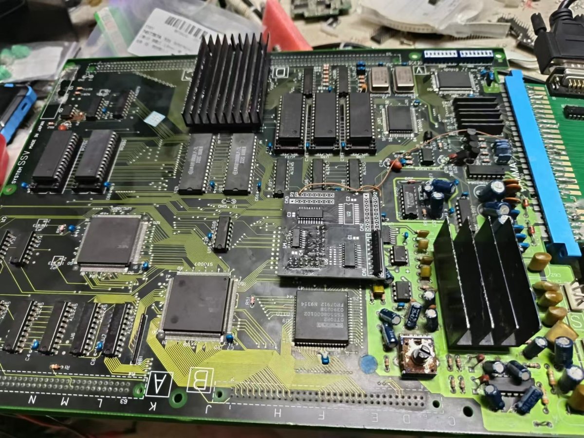

When the computer was turned on, it showed that there was an error in inserting a coin. After checking, it was found that the problem was with the st005 chip. There was no good chip to replace it. After looking up the circuit, it was found that the st005 was an IO chip. So I made a PCB to replace the IO.
