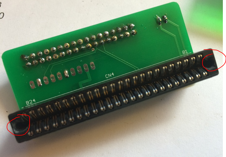

I could never find the right connector. I found something similar, but you need to cut or drill out the edges to make it work. If someone knows the exact part number let me know and I can try to make something.

everten
Jan 27, 2019
620
1,306
CT, USA
the official connector used by Namco is the 225D-10024C2-2312
it also has a little plastic key for the notch that I replicated: https://www.thingiverse.com/thing:2391981
JNX made (makes?) a kick adapter for system 12 with a different connector, not sure of the part number but it's out there.
https://www.arcade-projects.com/threads/jnx-namco-system-11-12-kick-harness-adapter.209/
Pretty sure JNX is drilling that connector out to make it work. These look like the same connectors I have.
