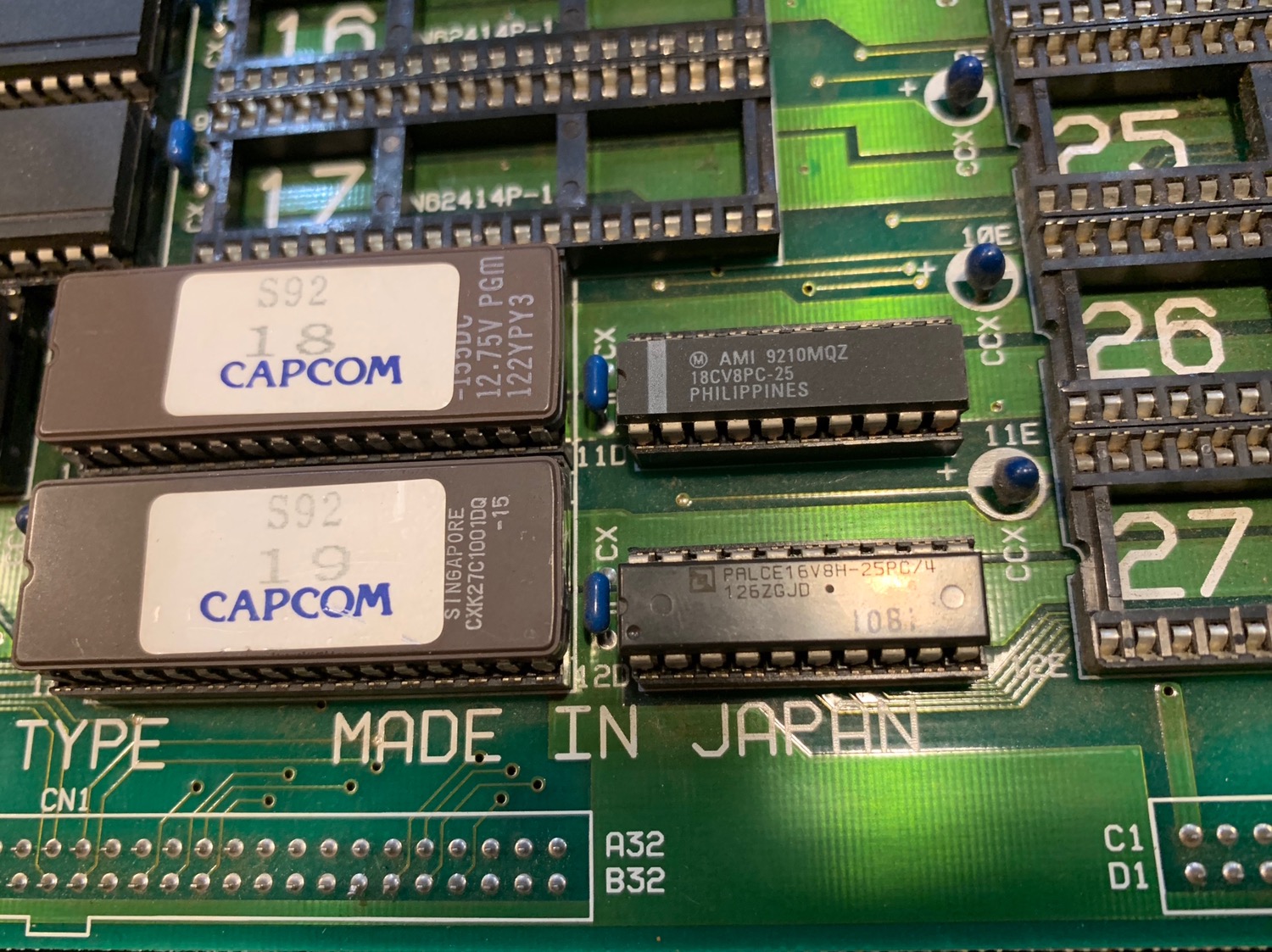

just took a look and the chip at 11d definitely looks replaced and newer. Doesn’t look stock. Pic attached to get your input.
If you’re willing to burn me a new one I’d be very thankful!
Oh yeah that's not stock. PM me your address and I'll ship one out

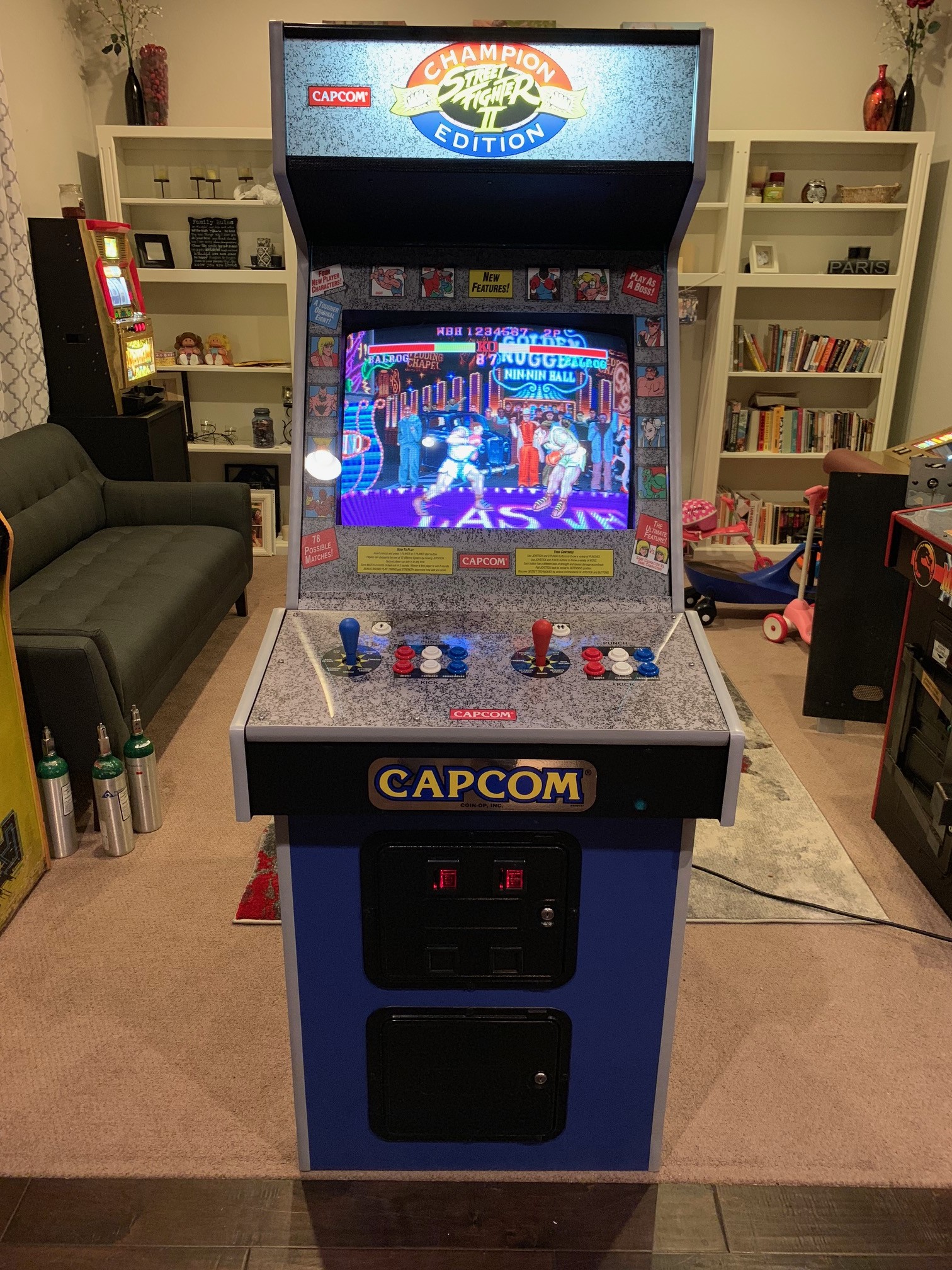

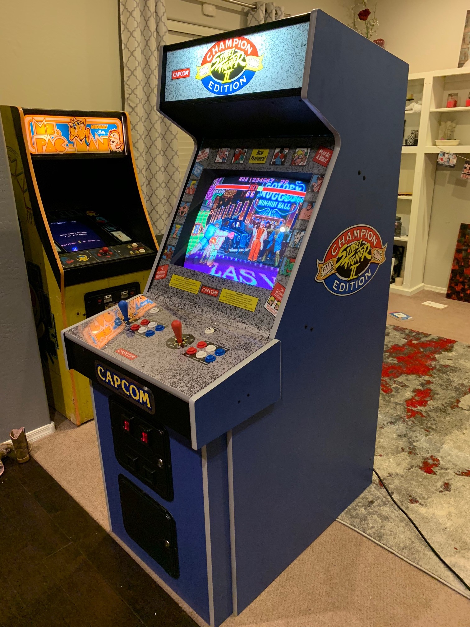

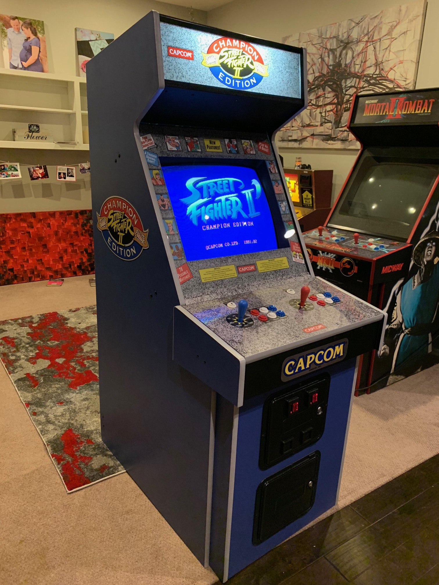

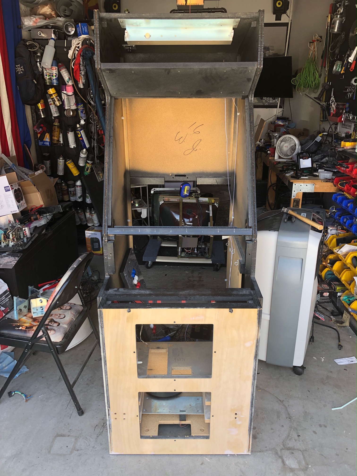

Can’t thank you enough. I took a beat up Midway cab and converted it into a dedicated Big Blue SF2 CE. Spent months on it only to plug in the PCB and find the glitch. So I’m very appreciative!
Attached is a before and after of the cab
