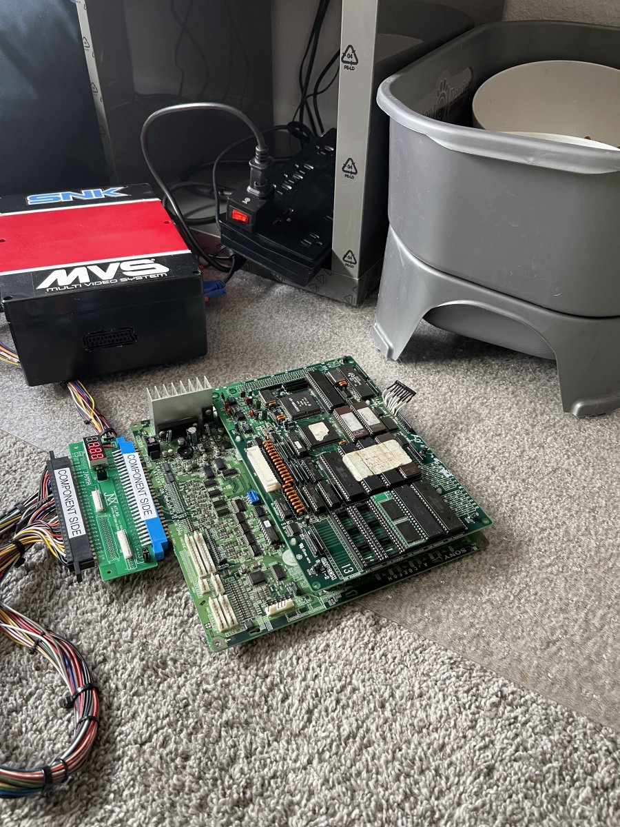

Hi!
TL;DR any guidance for troubleshooting which eeprom is not working?
I bought a non working street fighter ex1 pcb off eBay and it was DOA.
Cleaned it up, reseated the daughter pcb and took all the socketed ICs off and made sure no bent pins etc…
Then noticed a lot lot LOT of rust that left components nearly falling off. (One actually did so I had to fix it)
Deoxit overload on it and tada! It boots to the main warning screens and arika screen.
Then it goes BLANK ————— x_x. No button inputs change to the next screen.
Try again, hit the coin and I am greeted with the logo and it says press start
BLANK____________ x_x and it won’t load into the game
Any guidance on reflashing new ICs?
I have a writer but I don’t have a good working pcb to get the proper dumps to reflash some eeproms and I’d be going at it blindly.
In total I see
13 socketed ICs and that’s a lotta’reflashing.
Just wish I knew where the main rom for the game resides so I can attempt a new Rom
Oh also. I have another zn1 that has gallop racer on it. Read somewhere a while back I can swap out zn1s easily but I couldn’t get it to work.

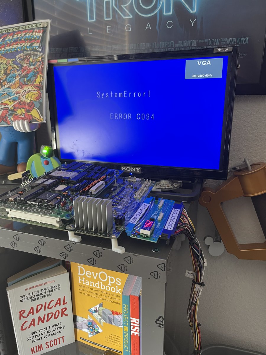

The error on the blue screen means a security check issue.
Didn’t see a capcom specific security dongle or thing?

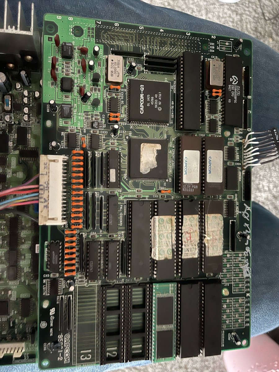

Security is in a CAT702 chip but if it boots passes the color bars it’s fine. Swaps work but only between security families(capcom<>capcom and gallop is tecmo)
I have no idea why I can’t link you to mame master on GitHub right now but here’s the sfex rom list on a branch
https://github.com/mamedev/mame/blo...3071db45a5aff61/src/mame/drivers/zn.cpp#L2978
Sadly iirc the program code is part of the banked rom group of 6 roms (3h 4h 5h 2k 3k 4k), and any one of them could cause that. 2H “country rom” is worth checking too, maybe I’m wrong and it’s the sole program code chip (and the banked ones are just gfx or something).
You can verify with the romset in mame though if you have a programmer. If you don’t have a mame set lmk
Gallop Racer 1 is Capcom, so that might be worth a try to see if it is the mainboard or the rom board.
Oh right, gallop2 and 3 are tecmo. The bios on the main motherboard is what’s compatible between families and yeah gallop1 should work then
Yep , tecmo motherboard won't work but has the correct memory,
Gallop 1 used less v-ram however.... EX is not too fussy on running....
EX should run as normal with a couple of very minor things missing with the lower V ram...?
It's been a while since it was tested - can't remember.

Looking at my pcb I'd now bet that the program code is just on the 2H chip. The rom board should have letters going across the top A>K and numbers from the top left corner 1>9. That's the grid, and the number reference is the chip location. It's like 2HJ really, it's a long chip!
Anyway I was wrong, it should be swap-able with the gallop rom/mother.
If you do end up using that programmer with the adapter, your best bet is just to dump the roms and concatenate however many result (in Dos: copy /b) and use mame's romident (or submit the result to an online romident). If your file gets a hit, then it is good. Since you're having to dump in banks, and concatinating, be sure you did that concatenation right or else you won't get a hit!
Also 2H is UV erasable (EPROM), but the rest in that banked set are mask roms not electronically erasable (EEPROM). You'd need brand new replacements for those if they were bad.
the v-ram is on the main board. If it is not populated, there will be an empty square solder footprint that has nothing in it. If your Gallop Racer is the Capcom version, the mobo should boot SFEX and the game should play fine minus a couple of minor grafic glitches.
just read in your roms and do a crc32 or md5. Check against mame set. Don’t burn them again if they’re already good. The mask roms are probably fine. I feel like sockets/traces get messed up more often than the roms themselves.
