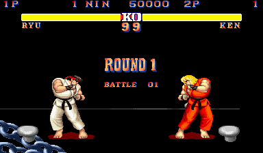

i always wanted to enable this , but it's not easy...
Got to the same point as your screenshot but it seems the x + y and priority is wrong.

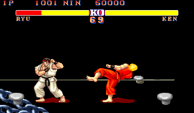

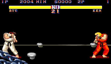

fixed priority but it's not staying in position / scrolling at the rate needed.
i think this is about as far as it goes playing with the A reg's, probably more is needed.

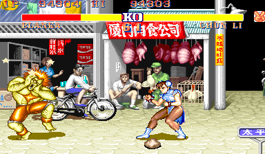

EDIT: chunli stage added
