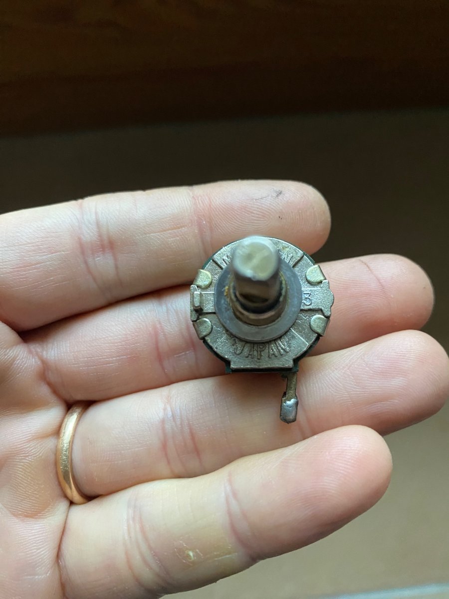

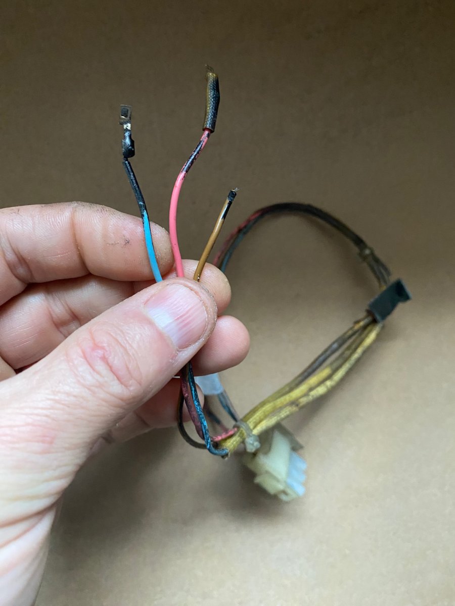

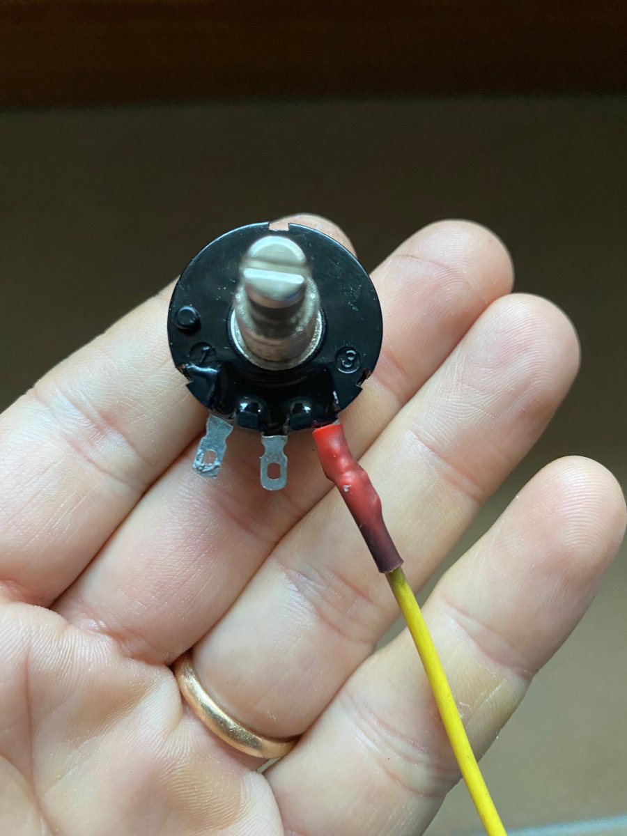

Hi everyone, I have to replace the 5k potentiometer on the handlebar of the Super Hang On... (it's old and I also found two pins unsoldered...)... the connector has three yellow, red and blue cables in which order they should be soldered on the new potentiometer shown in the photo? (from left to right of the potentiometer): I think the yellow goes to the third... where should the blue and red be soldered? Thank you
Ideally you will want to measure them.
One wire is +5V.
One is ground.
One is the output from the wiper.
If I had to guess, pink is +5V and goes to 1, blue is the wiper and goes 2, and brown is ground and goes to 3.
If 1 and 3 are wrong, the steering will just work in reverse. No harm done, just switch them.
