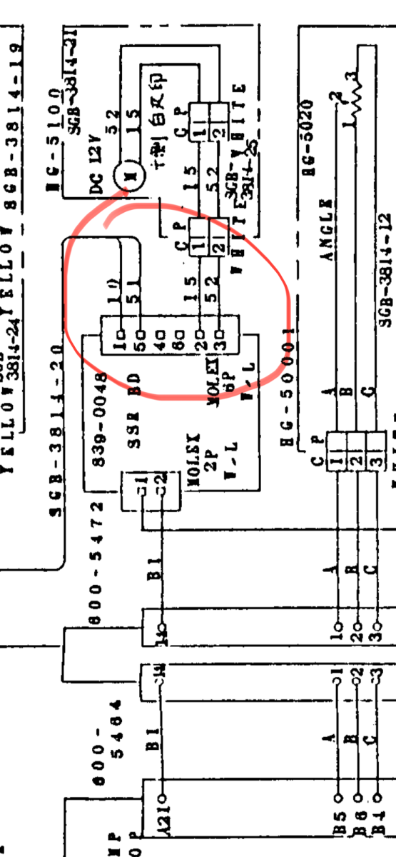

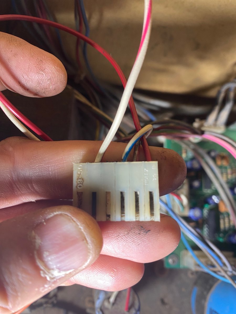

Hi, I'm restoring my Arcade Cabinet Super Hang On and I need clarification... I'm reconnecting the SSR board for the vibration and I noticed that the 6 pin connector is wired differently from what is indicated in the manual..... looking at my photo from left to right we have pin 1 empty, pin 2 with the white cable with red stripes, pin 3 empty, the quantum pin with the white cable with blue stripes, the fifth with the white and red cable and pin 6 with the red cable. Reading the manual I saw that the two central pins are empty... my question is: should I change the positioning of the pins in my molex connector like the manual or is it fine like this? Before trying the CAB I want to make sure I have connected everything correctly...:) Thanks

Look again. The header pins aren't numbered sequentially in the schematic.
You're also reading the order of the connector in reverse. Pin 1 (red wire) is on the right.

Thank you for your help...in fact I'm noticing that in the electrical diagram the pins are indicated not in sequential order therefore: 1,5,4,6,2,3...So following this diagram the wiring of my molex should be correct right? :)
Yes, the connector is wired according to the schematic.
