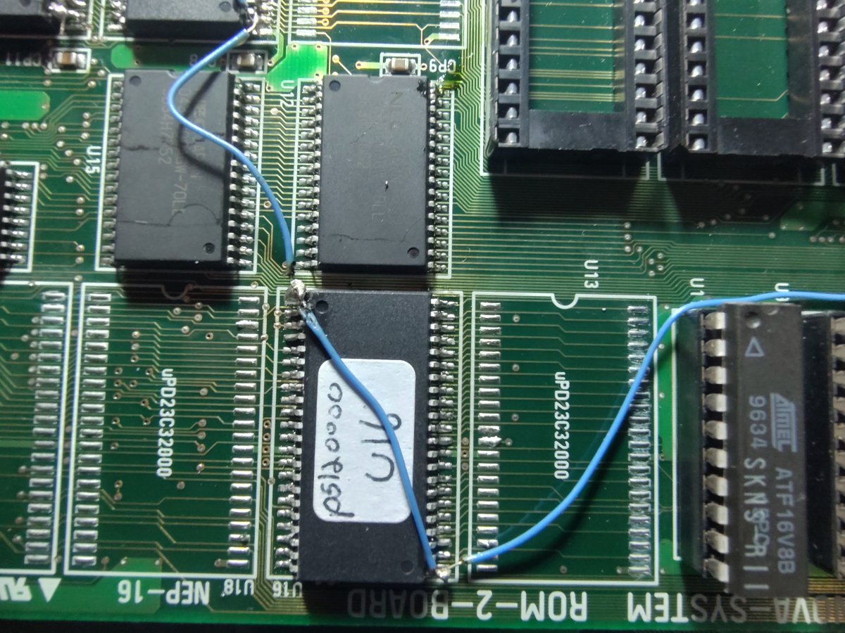

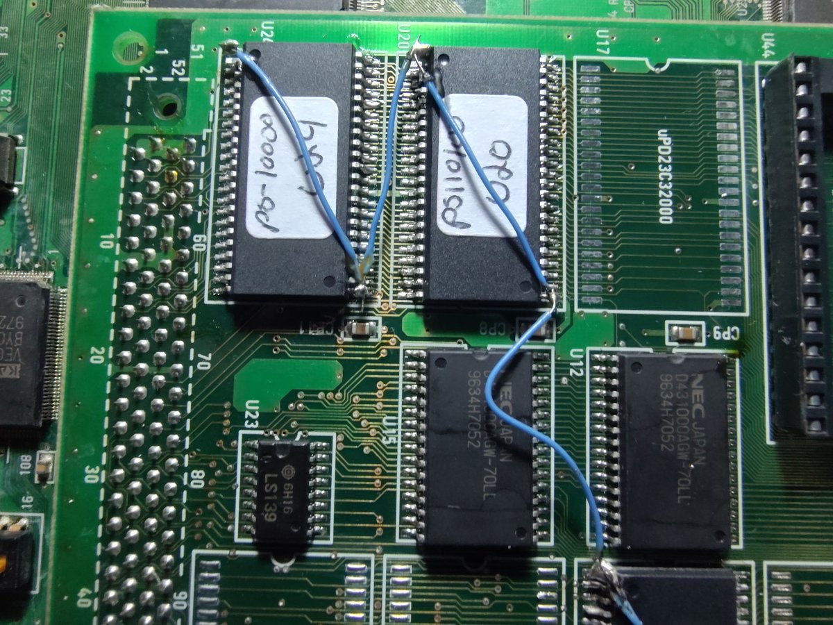

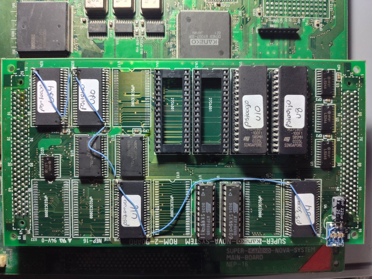

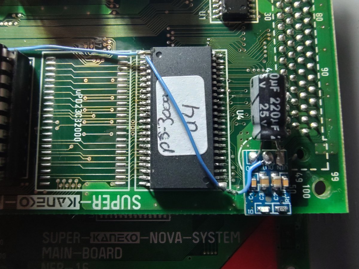

Anyway, back to the ROM 2 BOARD from Jan Jan Paradise. I hot air blasted all of the SOP44 surface mounted ROM chips off the board face, cleaned up the pads, burned four MX29L3211MC SOP44 chips and two 27C801 DIP32 chips, got a new 25V 220uF capacitor, and one HiLetgo AMS1117-3.3v buck power converter from my back stock to step down the 5v in current to 3.3v for the MX29L32211MC chips, lifted the opposing corner legs of each of the SOP44 chips, and got to town with some solder paste to resolder the surface mount chips with the hot air station.
After removing the pin header on the buck power converter, I just slipped the long legs of the new capacitor through it (positive on V-in and negative on ground, middle hole on the HiLetgo is the outputted 3.3v), soldered the capacitor to the power converter, and then placed the remainder of the long legs through the holes of the cartridge PCB and soldered it there and then wire nipped the remaining. Then it was just using 30 gauge wire to connect the lifted legs (which I still suck at but it was MUCH easier this time with the thinner wire).
I was amazed how quickly I got through this vs. my tortuous first go at making a Cyvern last year. I guess it is all about practice, practice, practice.

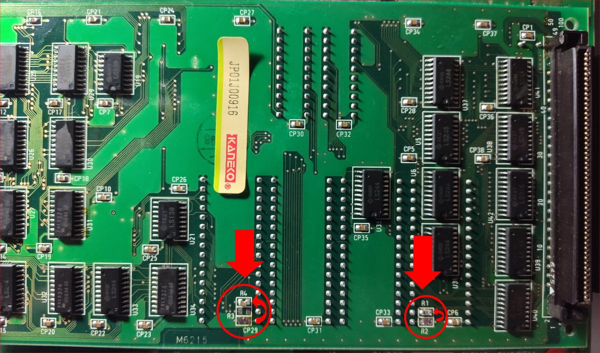

Rather than being smart and looking up information that has been definitely documented here in the Cyvern conversion thread, I just started playing around with the R# jumpers on the rear of the cartridge as that was going to be faster than trying actually verify that right settings. That being said, I can't actually say I have the right setting now, but the cartridge works with out issue, so I'm going to let it roll

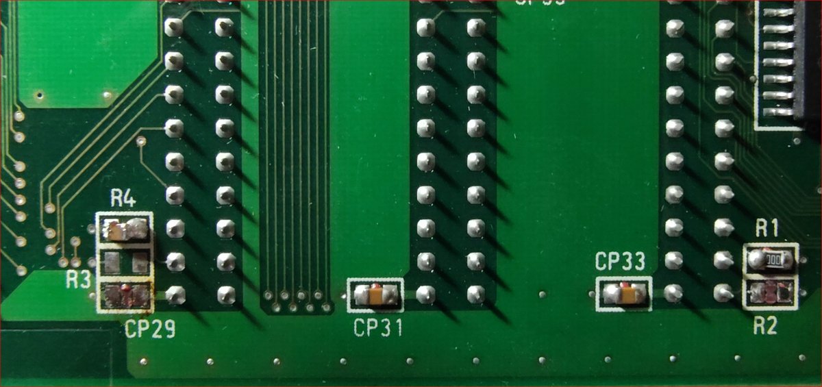

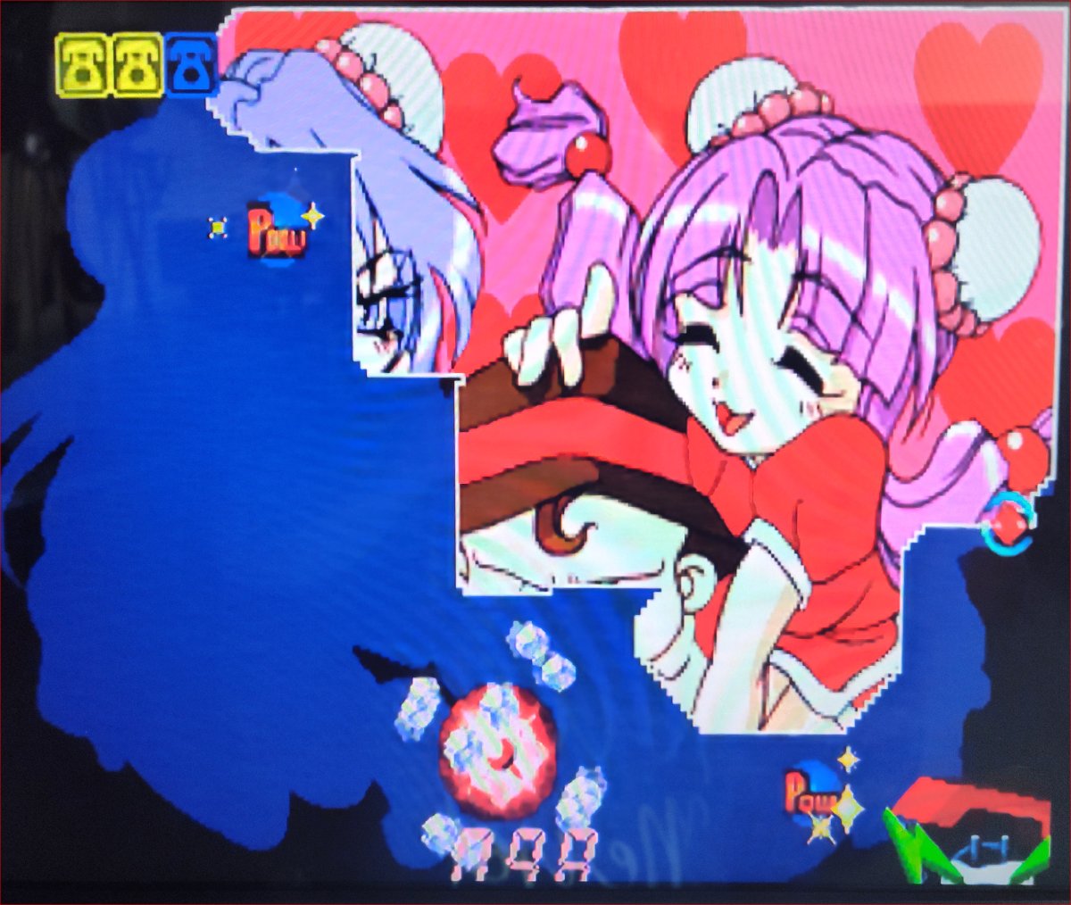

After moving one resistor from R3 to R4 (it looks horrible and I think it's resting on a mountain of solder... I'm still really bad with tiny components) and the other resistor 0 ohm resistor (clearly marked with 000, the other one on R3/R4 didn't have any discernible markings that I could read) from R2 to R1, the game booted through the Japanese modified universal BIOS, past the in-game brief RAM/ROM check, and it worked!
Here are the pics for reference:
