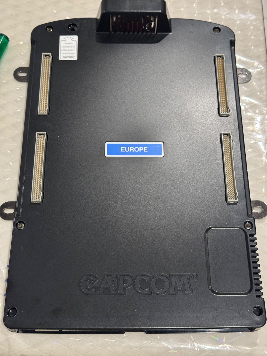

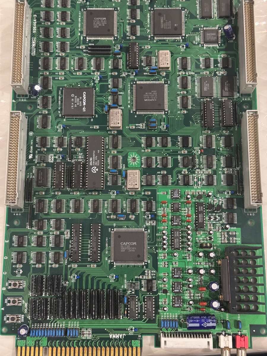

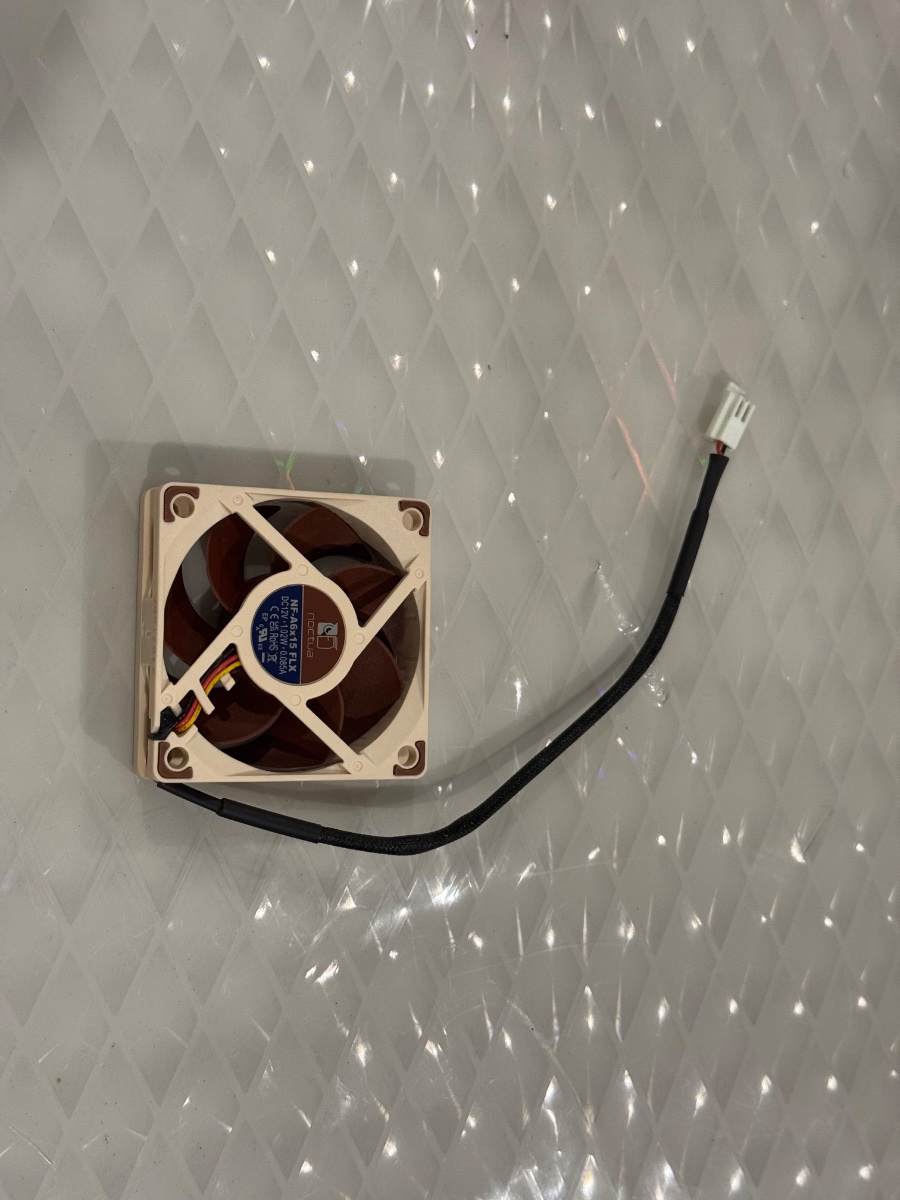

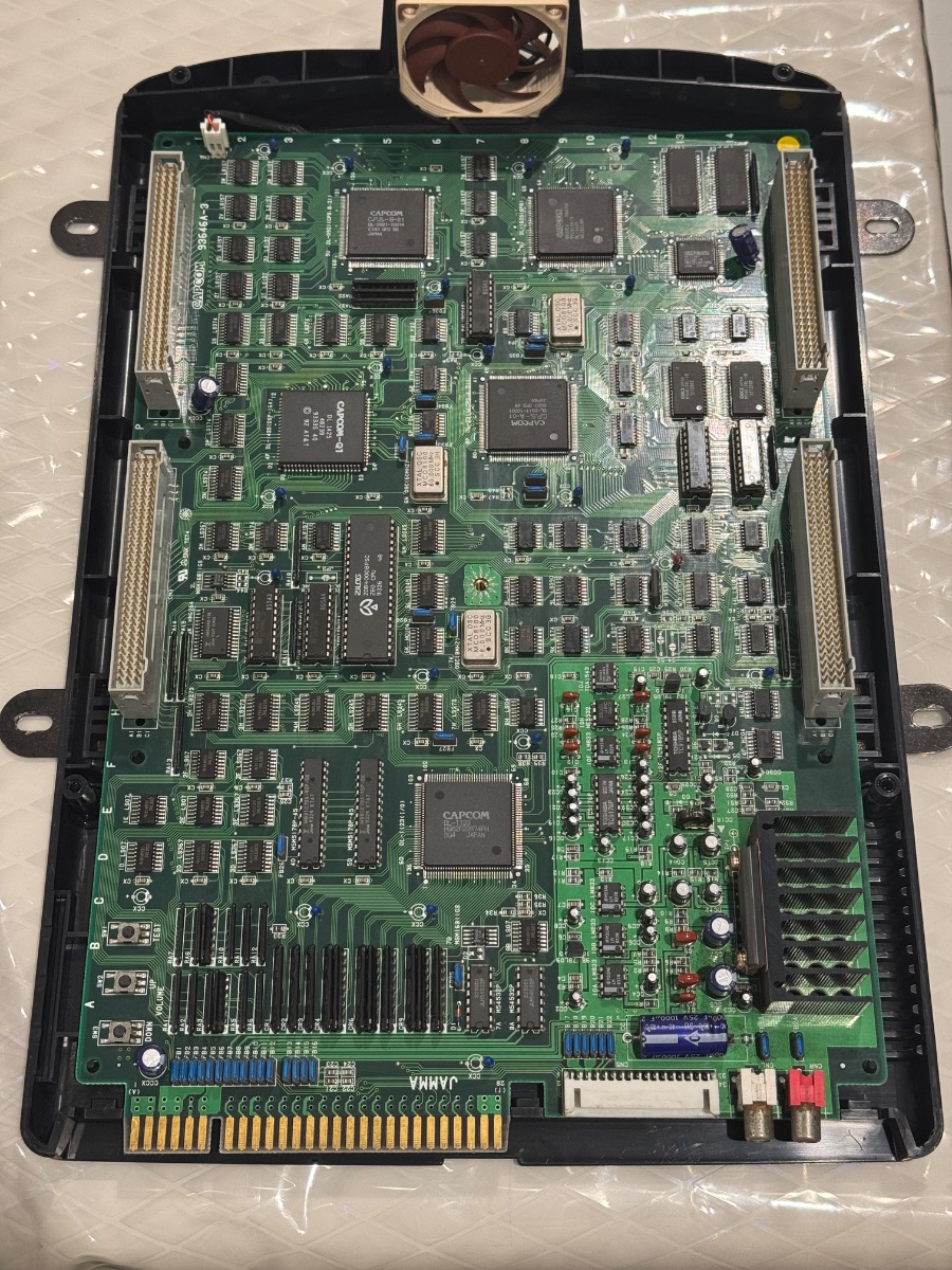

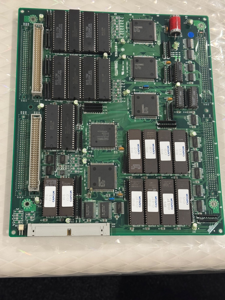

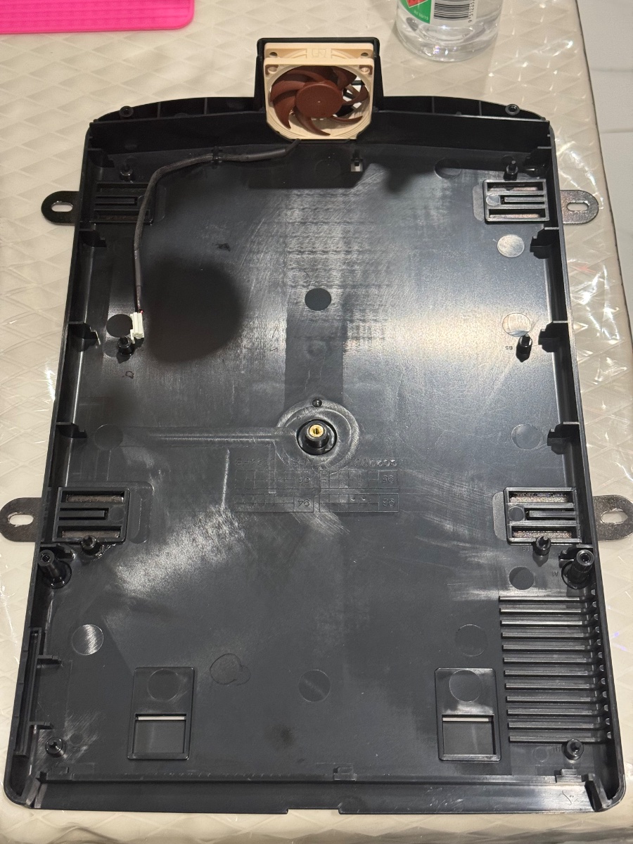

Mod complete in new CPS2 board I got. Which is in mint condition. Also, cleaned everything.
I unpinned the Noctua and unpinned the default fan and re-used the housing works perfectly. ❤️
