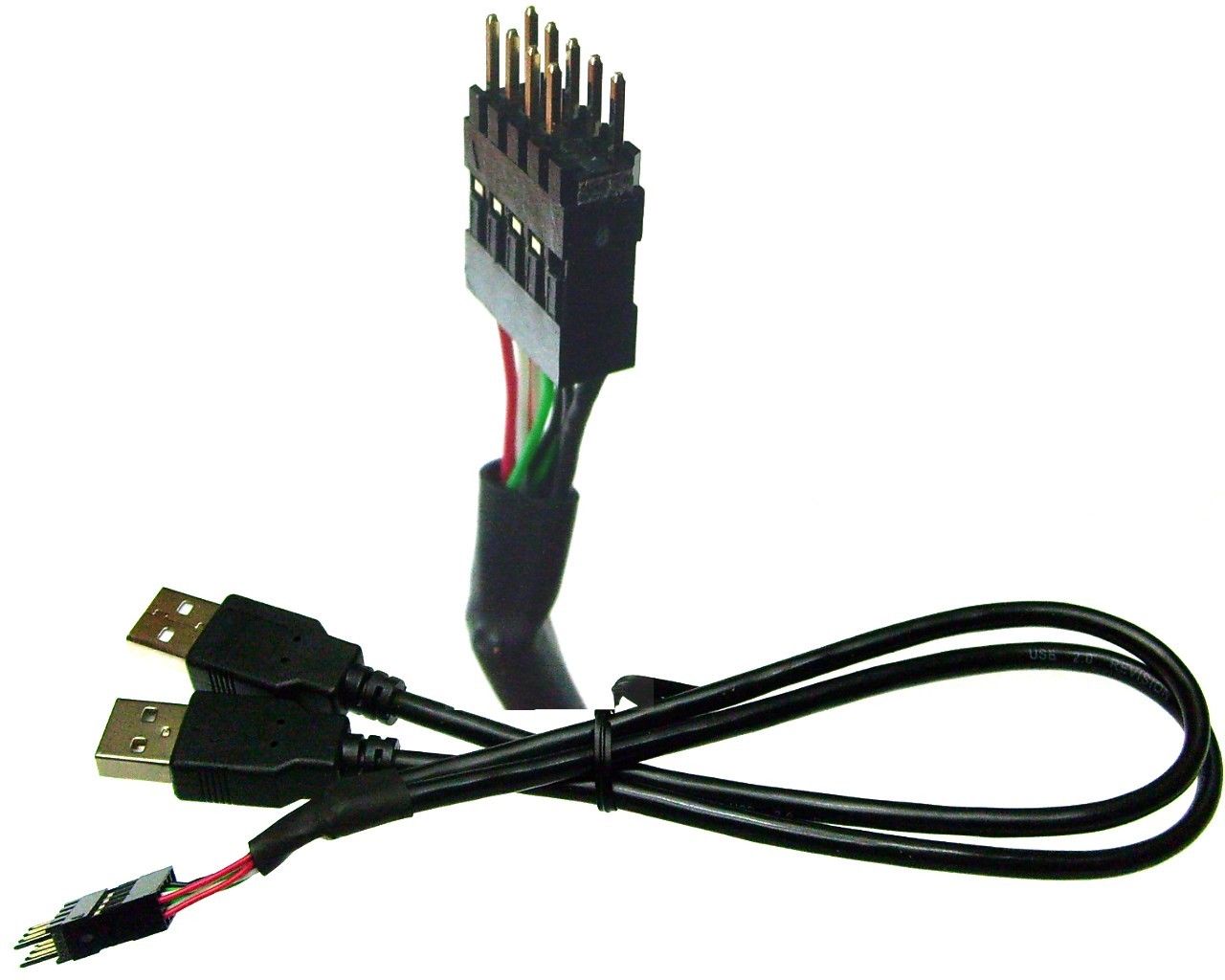

After searching ebay for a while I found this and it finally arrive today:
With this I can be really non-invasive when I connect the USB ports on the case to the Undamned USB decoders.

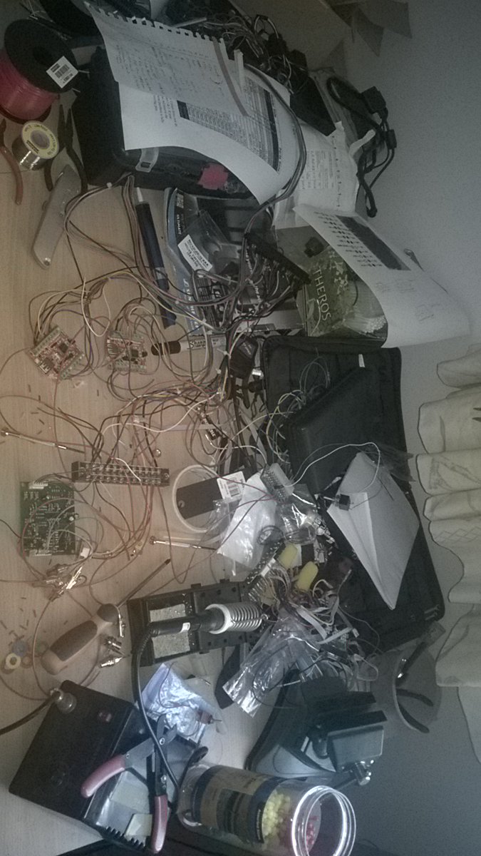

Believe it or not this is almost done.
It's also super ghetto rofl!
