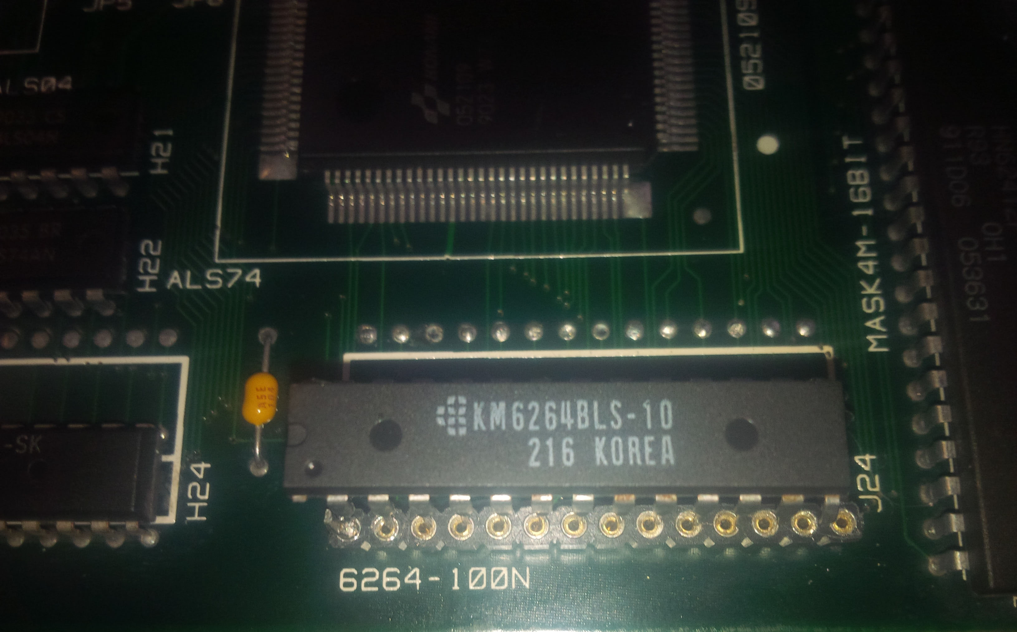

I got my hands on a Konami Surprise Attack board and it booted up and was playing generally fine. I noticed a small graphics glitch on the characters and so I pressed down on the rom chips to make sure they were seated correctly and there was a socketed chip that seemed to be shaky.

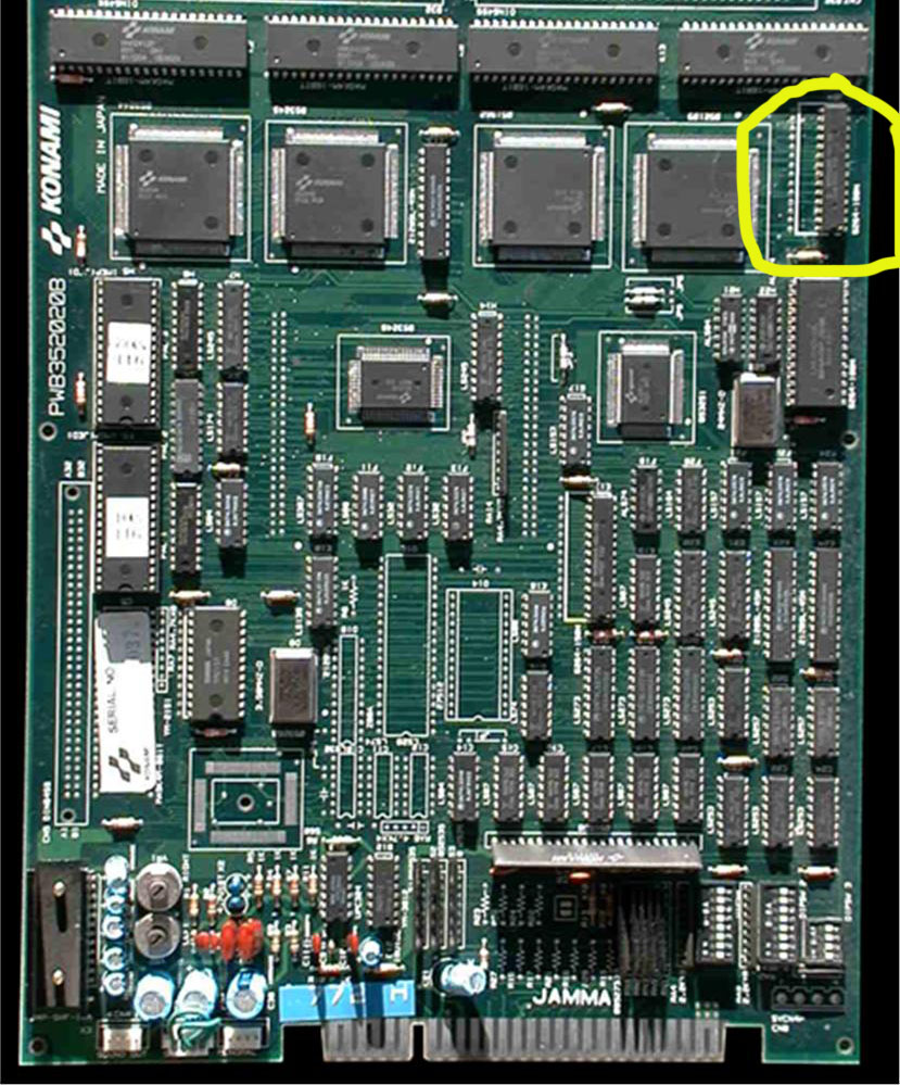

I pressed gently (or so I thought) on the socketed chip but it flew off the board and broke a leg. :( Please see the picture (not my actual board but good for showing the location)
The socketed rom is at the 6264-100N & J24 position and the chip has a code of KM6264BLS-10 216 Korea. The game played in English. Is there anyway to get a burned rom to replace the one that broke easily? The rom chip itself looked a bit beat up with very bent legs like the person before jammed the chip in without care. Also, judging by other pictures my board had a socket put in it.
close up of rom.jpg\
And yes, the rom isn't inserted in this picture. The leg is already broken but I wanted a good close up shot of the socket and rom.

This is not a ROM but a SRAM -> 8Kx8 bit Low Power CMOS Static RAM
You can find them on ebay or your local electronics dealer.
I think it's Video Ram Chip, and as mastercello said...no data on it.
That would make sense as without it I just get garbled garbage. What numbers are important in the SRAM code. I can find ones that have the beginning part of the code: KM6264BLS-10 216 Korea
I can find chips with the KM6264BLS-10 but not the 216 part. Does that matter? I can find KM6264BL-10 406Y Korea and/or KM6264BL-10 314Y Korea are these ok replacements?
Thanks again for your help.
Those should work. That 216 is probably a batch number.
