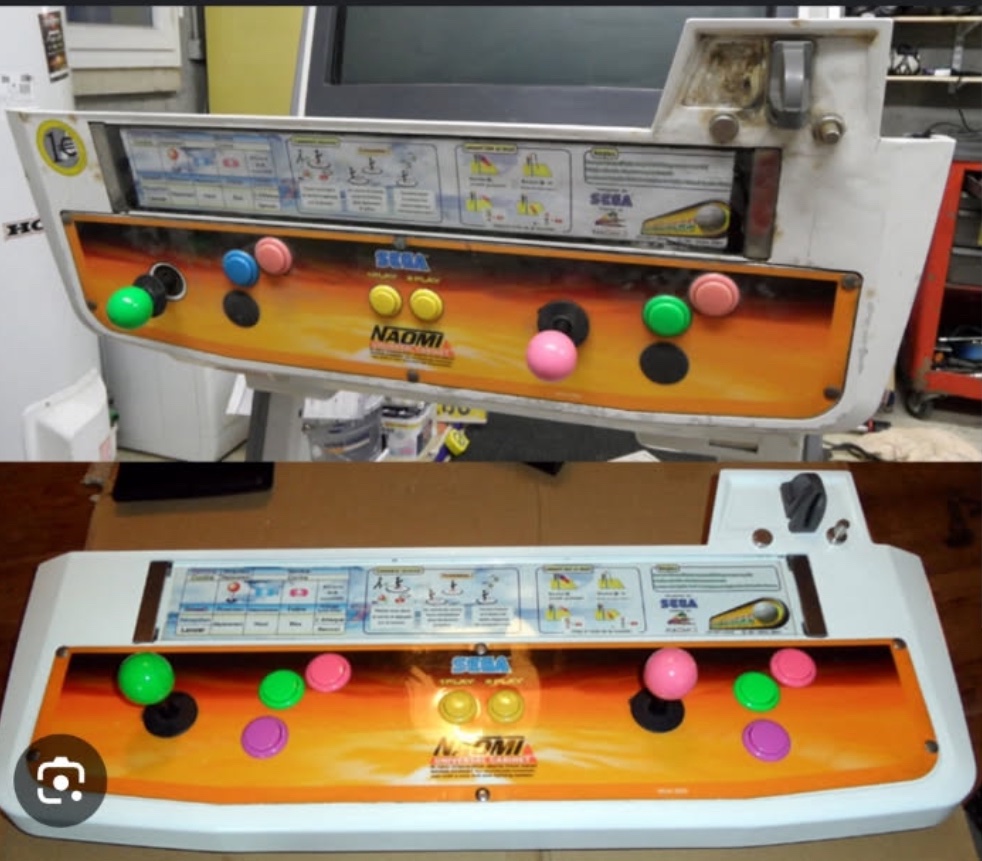

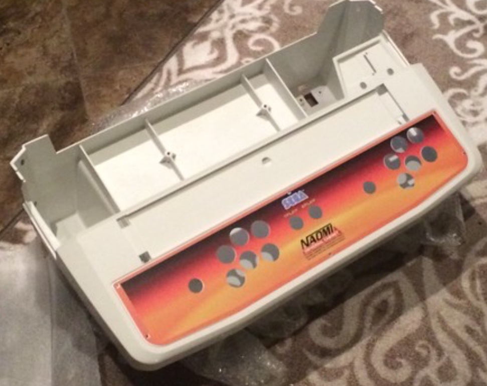

What operations are necessary to adapt it ? Change the support, make another or an adapter ?
Could you show me bottom and top control panel enclosures ?

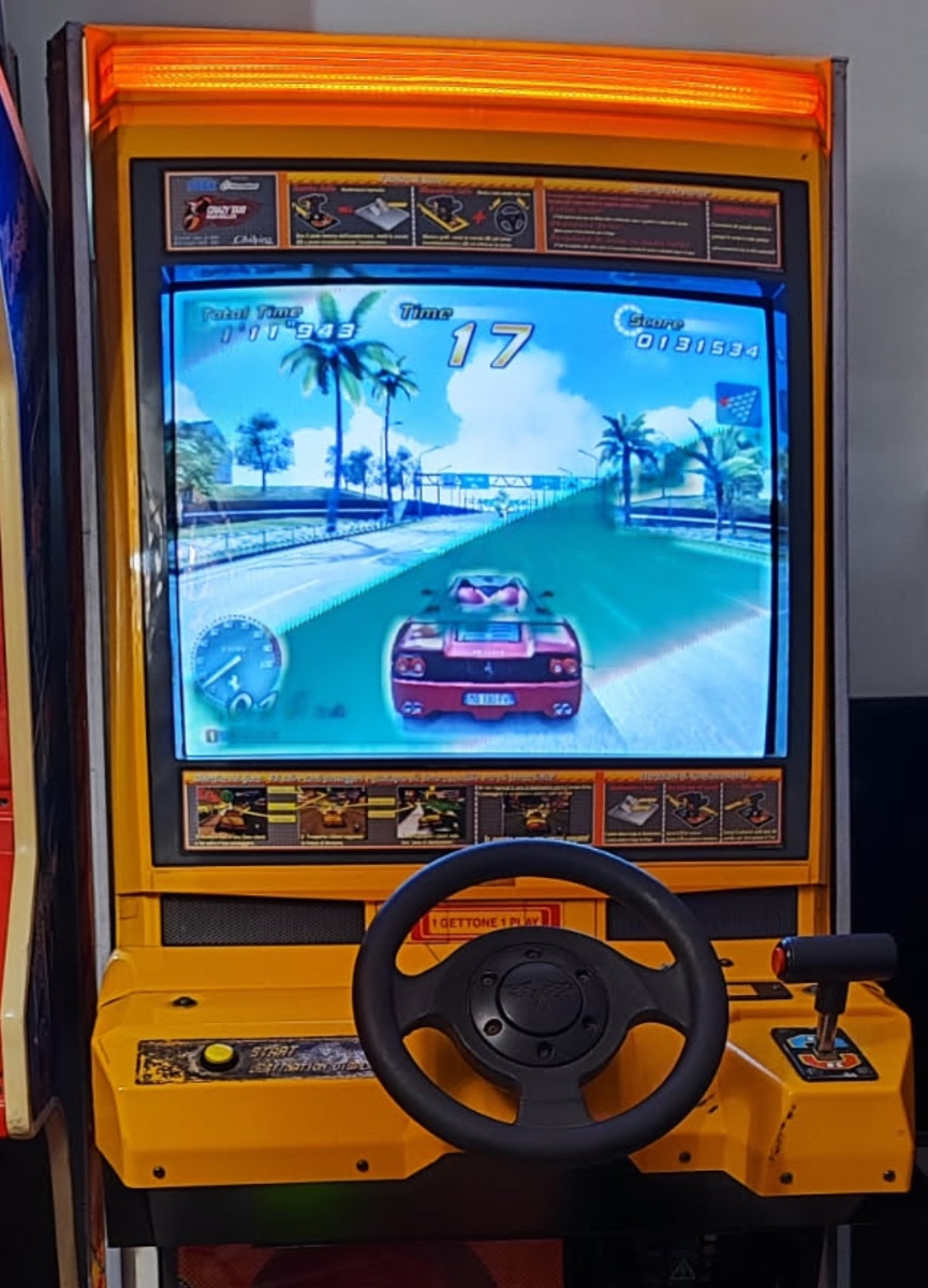

I have Initial D cab for driving game.

Ok, thank you for the answers.
I will see if panels are compatible with each other.
