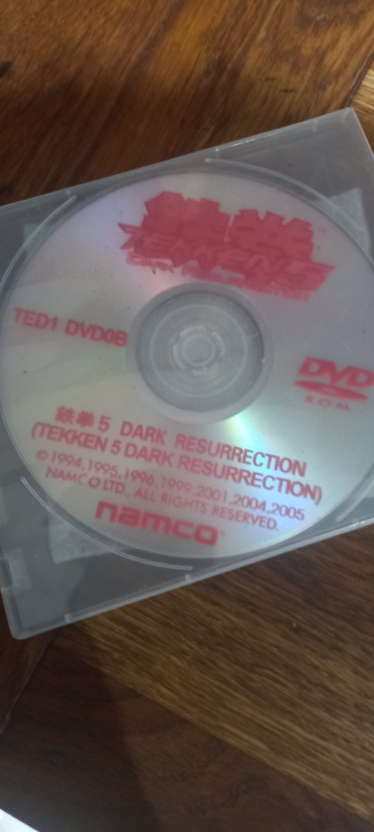

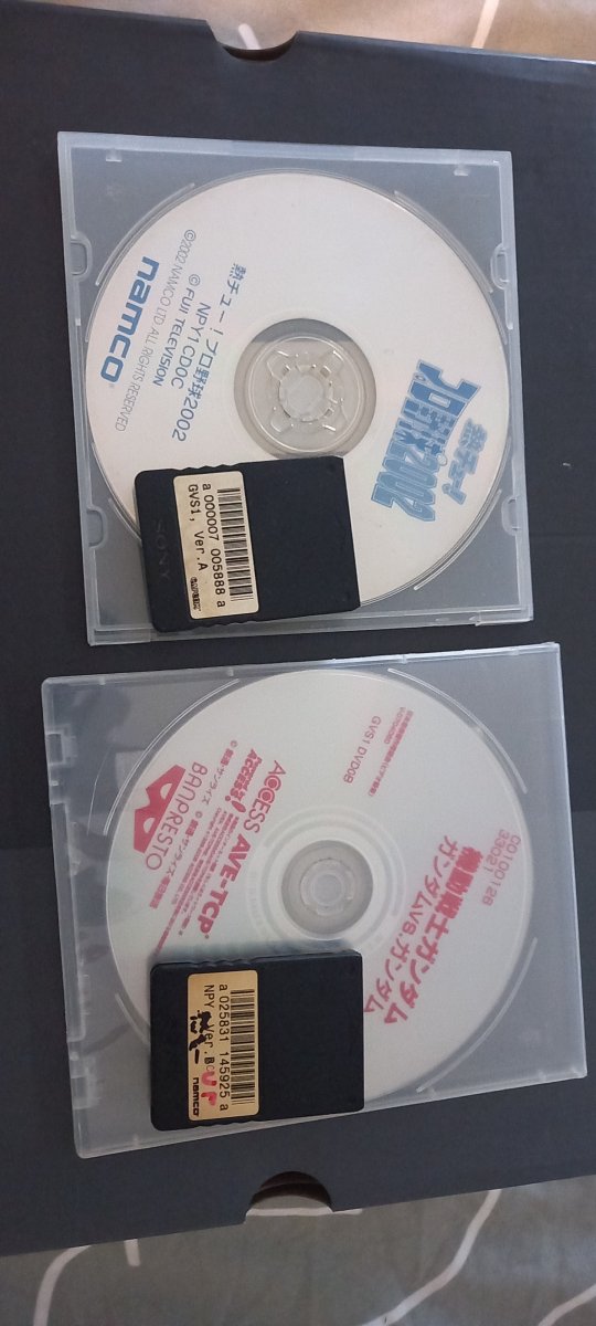

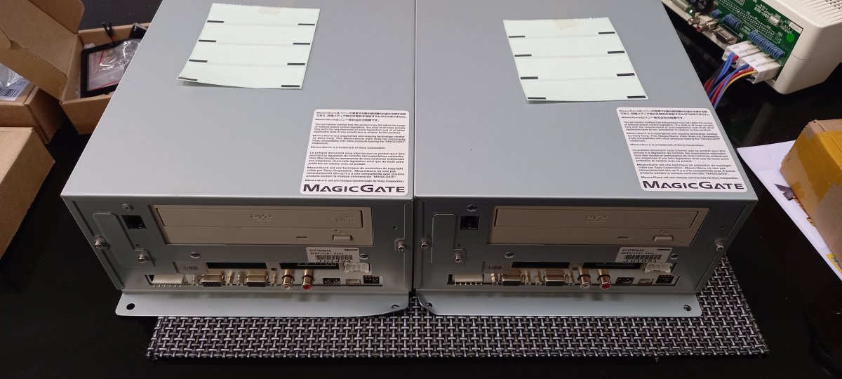

Hello @nem @twistedsymphony sorry for the ping lads
Im looking to do some work with my systems 256's
but cant seem to find the following:
CHD's: https://mega.nz/folder/Td4lEIwa#qT4XlvTKMEP1KDwY0yCUMw
Dongle Files: https://mega.nz/folder/vFx1VI7a#OeJPsgLL_PsxEhH9h6QDkQ
Roms (100% optional): https://mega.nz/folder/eQ5TCSSa#ecJvbXyHtE9NHiy6vIP_CQ
Looks like links for dead.
if someone would be kind to point me in the right direction would be great.
Ps. If these files need to be kept private for system 2x6 owners, i will kept any info handed to me 100% private
i just bought all the stuff to make htis happen overe the weekend. once it all comes in im gonna get this bad boy together and see if it works. fingers crossed. im excited for this

EDIT: also, I think your Netchuu Pro Yakyuu hasn't been dumped. If you would like to see it dumped (both disc and dongle), you can contact me.
Hello Nem
Im going dumping my Netchuu Pro Yakyuu disc and dongle tomorrow or the weekend and i will send it to you.
Think i have a few more things thats not public (2x6)
If you wanna talk in private we can PM
