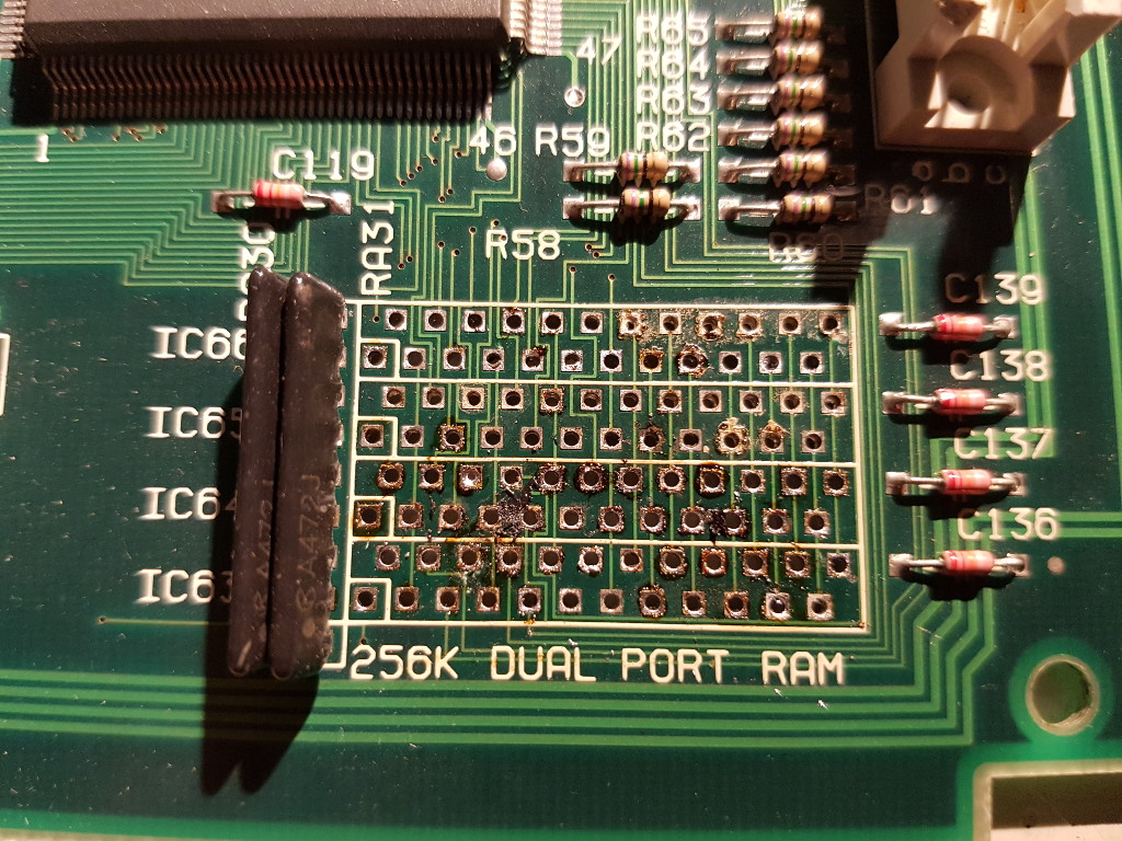

Pic from the board:
(A sample broken track is at the O in PORT, look up and follow the 4 connected holes. )
Anyway, bigger problem. The 3rd hole at the left, lining up with K in 256K (which goes off to the left) is dead. There is no signal on it.
If i follow it, it just goes off straight to the QFP custom. :(

It's the two lines under the row of C136 -> C139, nothing else is connected to this pin.
* Ignore the stupid holes at the top of that ram. I reflowed that after soldering, with some hot air and checked connections.

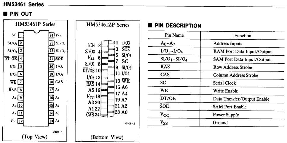

According to the data sheet for HM53461ZP (Yes, zip ram) this is SI/O4 or if i look at it the wrong way, it's A3.
Either way, I/O is needed to get data out/in and address is needed to utilize the full RAM size.

The square indicates pin 1 so it's SI/O4.

No signal: No leds light up on the probe. Not grounded, not high, not pulsing. It's like i'm touching air, like nothing is connected. Boohoo. which leads me to assume the custom is fried and the pin has become disconnected internally, inside the package on a level where i cannot repair it :(
Do you have an oscilloscope?
The pin is either connected to nothing or not reaching TTL levels (if one transistor is dead inside the chip).
But it's more likely it's disconnected.
It's reaching the custom, trace is OK. But there is no voltage there.
I checked on a working board, it's pulsing high. I guess i can safely steal the i/o custom from this board to fix my C2 board.
