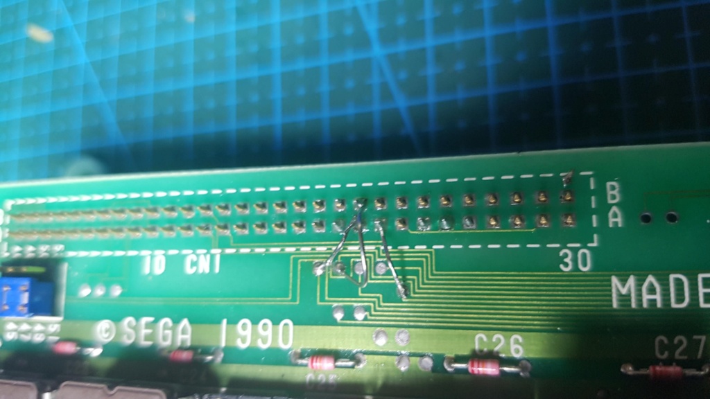

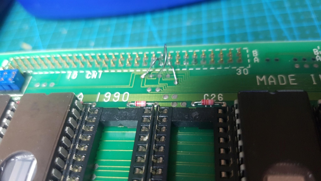

I have a couple of S18 boards that I paired with an original Shadow Dancer and Alien Storm ROM boards. I also made a Moonwalker board.
The Jp Alien Storm (with unencrypted ROMs) and Shadow Dancer worked in my Blast and NAC, but the picture was completely scrambled. I have read that it can be an issue with video ground, what is the easiest way to fix it? A JAMMA adaptor board on the motherboard with pins 1 and 14 (think that's right) connected by a wire? Or is there a simple fix to the JAMMA harnesses to make them work?

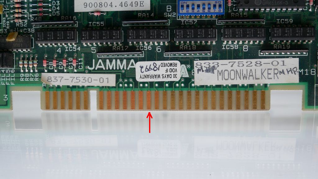

Moonwalker did not have the issue ironically, but had issues due to the ROMs used. Still have not been able to re-burn it with the ROMs Apocalypse made for the 2nd version of the ROM board. The Moonwalker ROM board is the 2nd version (I can use the Bloxeed ROM board, though), the other two are the original ROM boards. It made me wonder if the ground issue only effects the original ROM board? I never tried the Bloxeed ROM board before changing it.
I recently bought a Jp D.D CREW board, but will not be able to test for a while to see if the picture is stable.
