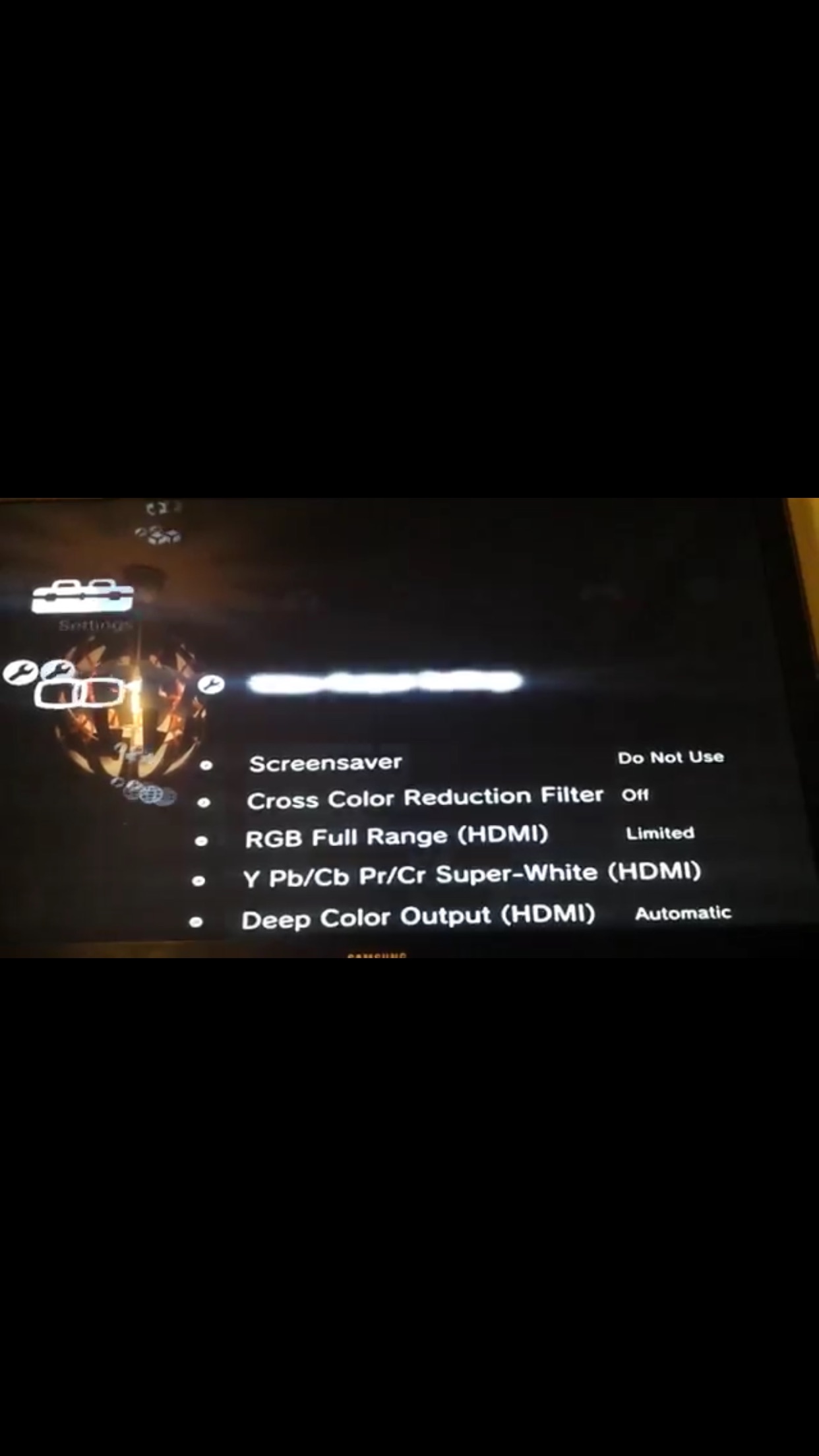

I finally got a chance to test things out this evening and the splitter works. I now have normal color video through dvi. So this is a cheap fix to get around hdcp.
Although the picture colors now look good, on a black screen there a little white dots that are noticeable. Also the picture is a little zoomed in. Changing any setting for monitor does not fix it. Even if I adjust the V or H size it doesn’t affect zoom. Maybe it’s because screen res is 768 output is 720 not sure just kinda guessing.
So it can be better but it better than it was before and much better than playing on small screen
It is probably a hdmi cable bandwidth or handshake issue. Try a different one first
Thank you for suggestion. I tried 2 other hdmi cables neither made a difference. All have the same end result. Little white specs on dark screens and zoomed in image
