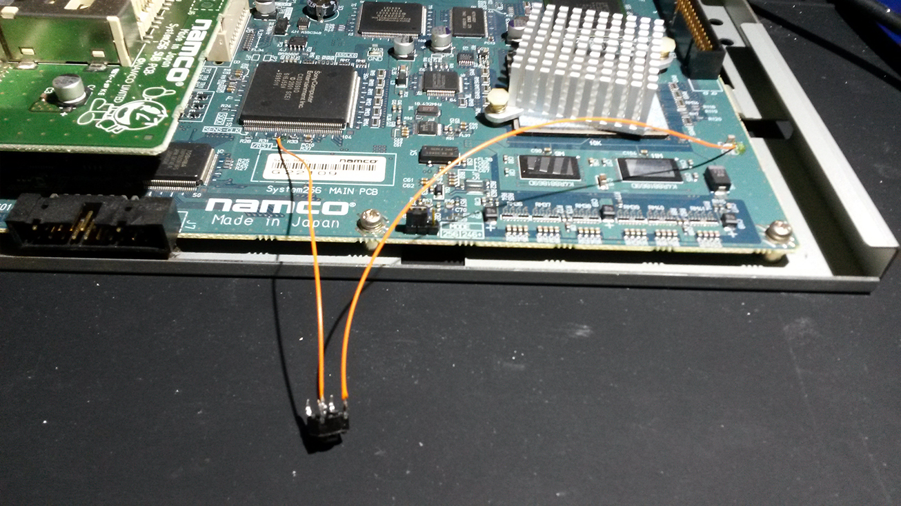

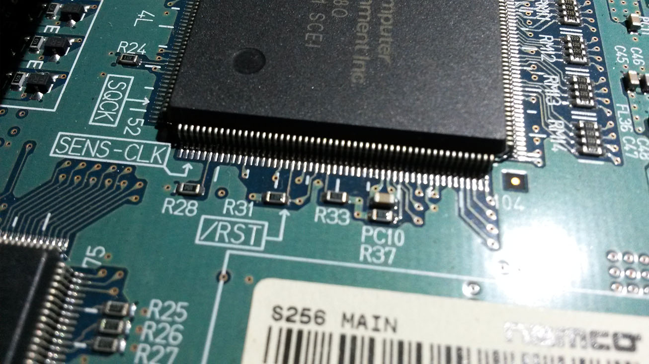

Took apart a System 256 to investigate -- good news!

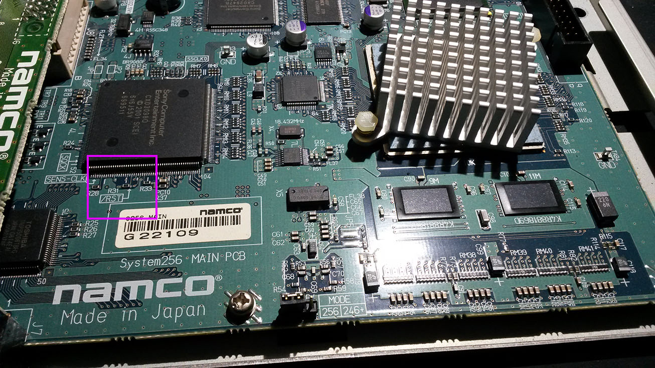

Was nice to find /RST marked on the pcb (that was easy!). Verified it against the PS2 schematics that this is the system wide shared /RST signal
Soldered some wires from /RST and GND test point to a momentary push button.
We're in action! Works to reset the entire system, just reset this sys256 over ten times and it restarts and boots the game without issue. This weekend I will test with usb dongle, holding reset active/low while programming dongle, then release/high to boot.

Excellent! So you just tie RST to ground to hold in reset?
I'm assuming this works on the 246C and 256. Do you have any of the older 246 variants to look at. I have a 246B here that could check.
The reset point on my 256 works great, I've been using it often.

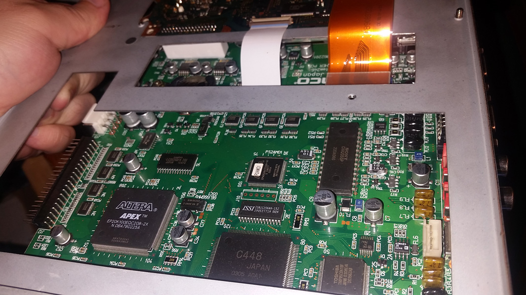

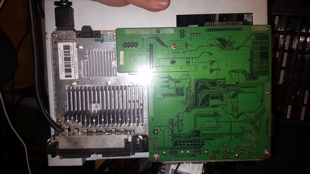

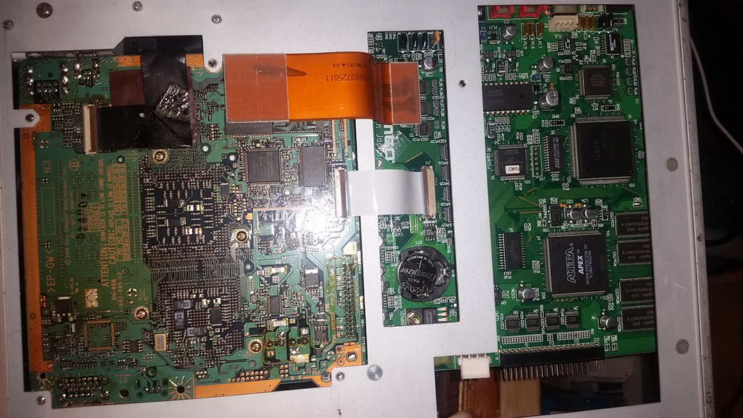

I pulled the mobo caddy out of my 246b to see if it had a similarly labeled RST point and I couldn't find one, though I didn't really go too far in the disassembly.
it basically has a PS2 main board and then a "246 mother" board that plugs into it for all of the front panel and IDE connections
Now a normal PS2 console has a reset button on it, the power button acts as a reset with a short push and powers off on hold... so we might not be able to hold the console in reset but we could probably trigger a reboot if we can figure out where that button normally goes to.
of course a proper RST point would be better :D
I am very confident we can locate /RST on the early 246 boards. We have schematics from early generation PS2 that is more or less same hardware configuration.
@theoddtech has offered to tear down his 246B and take high res photos for me to analyze and suggest where to connect /RST trigger

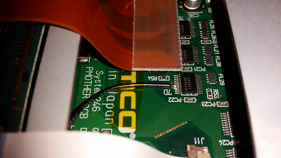

With help from @brizzo we found what I think is the best point, photo of my test below. It's on the 246 board, which came from a chip on the ps2 board with tiny tiny legs, and came over via the flat cable in the photo. The leg on that chip is gonna be the best long term point, there is a via next to it (symbolized by the red dot) that I hit for a quick test that works fine, but isn't a stable point.
Thanks for that. I've tested and it's working great on my system 246B

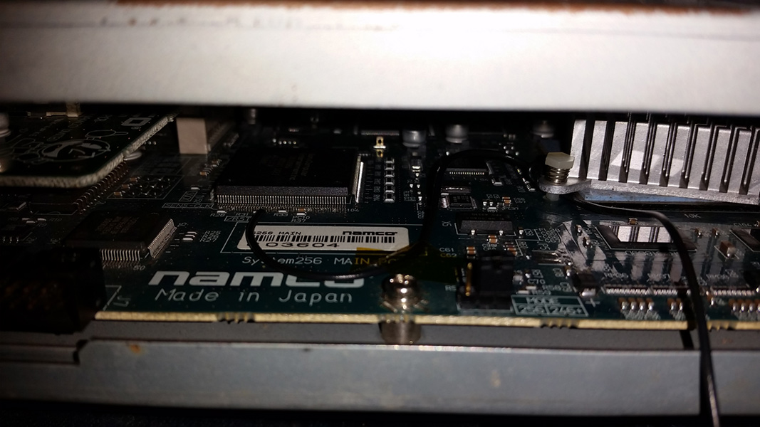

Here is how I have mine setup with some strain reliefs:
on the 246B I have a piece of kapton tape to keep vibrations on the solder joint to a minimum.
Then I gave the wire a bit of slack and tied it off around a stand off so any pulling or snagging of the wire gets put to the post instead of the tape/solder joint.
on the 256 I did something similar only instead of using a post I simply tied a not and tucked it under one of the heat-sync posts:
on both systems I terminated the wire into a female dupont connector to minimize the chance of the wire shorting out against something when not hooked up.
