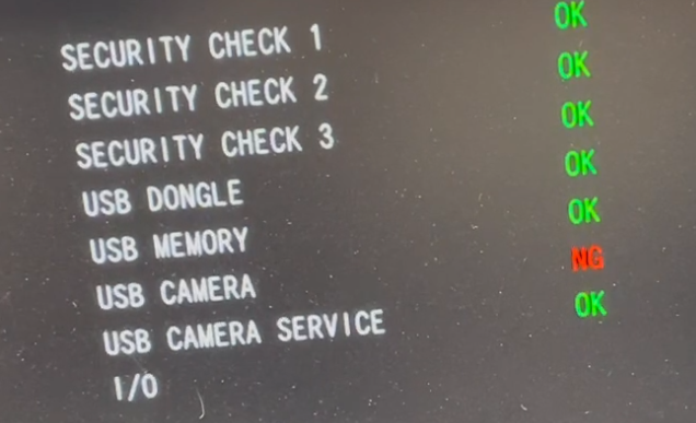

Hi, so I have a taiko cabinet on a Namco 357C and can't get it to work. It will turn on and boot into the game, but then during the checking it won't pass, it will get stuck on the camera error.
I was told that this has to do with the network service and I would have to mod my machine but what would I need to do because I am willing to do it, anyone know a way to disable this without doing anything crazy or how I would mod it?

I know nothing of these new Taikos, but can you access the test menu and turn off the camera?

I don't think so, unless it is in the ps3 os part, then no because when it boots, it goes straight to this, nothing with taiko at all.

It shouldn’t throw an error with the camera because the drive is unhacked. More likely something wrong in hardware.

I was told that it was about the network, maybe that is causing a network error because of that. How would I even hack the drive to get that to work anyways, or what about the version of the ps3 os, I was told some of the namco machines used a debug ps3 os so maybe I can figure something out. I am also working on another project because of how I thought it would be fun to make something for my school (will post about later) so for now I am kinda busy but I'll try to figure out something, any suggestions for this machine though is great because I don't know a lot about the namco machines.

Where did you get the cab? Until the last 2-3 months it's been near impossible to get Taiko HDs, so there isn't really anywhere you could get them.
A crack for this would require you to make new dongles as well. There's a working HDD image, but the dongles that came with the cab wouldn't work.
