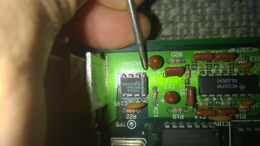

The DAC (with my screwdriver pointing to PIN1):

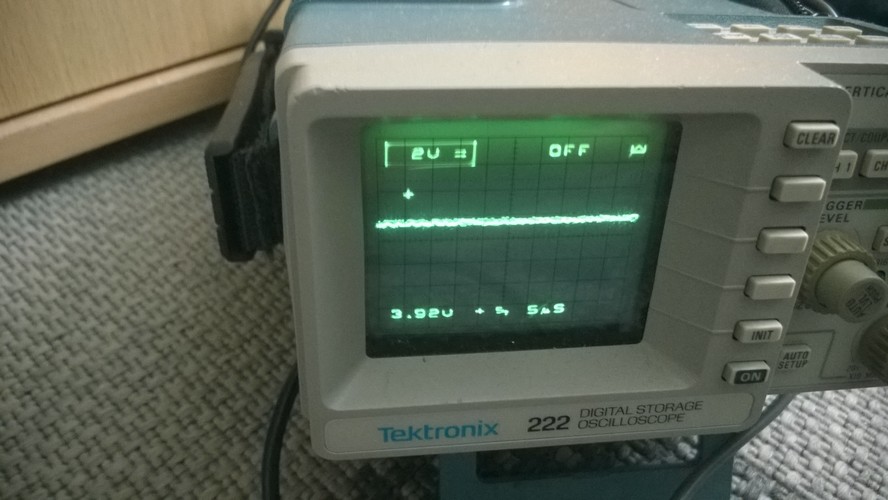

The PIN3 of this one which is all normal:

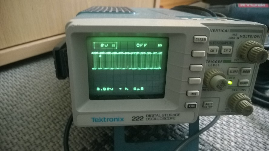

The PIN1 of this one which is bad (DAC or trace HS):

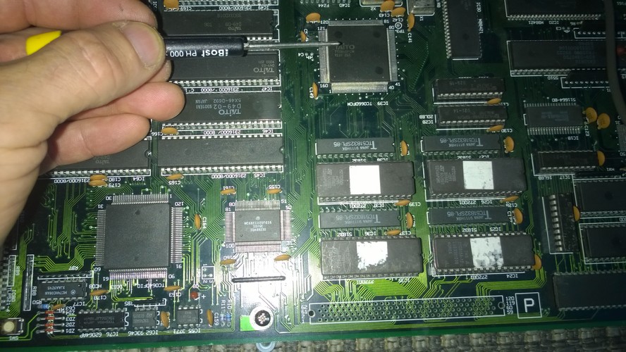

The Custom/QFP TAITO TC0660CFM which must output to me (it would seem) the signal of the PIN1 of the DAC (bitclock...clock of the DAC in fact):
On the other hand, where/which leg of this component?
Impossible to find with my multi. I therefore think of a cut trace or else the PIN1 goes elsewhere.
I was only able to trace the line of this PIN to below the QFP. It is through and therefore below the component.
Impossible to know where it is going :(

The Bitlock singal for DAC is outputed at PIN 49 of the Custom TC0660!
