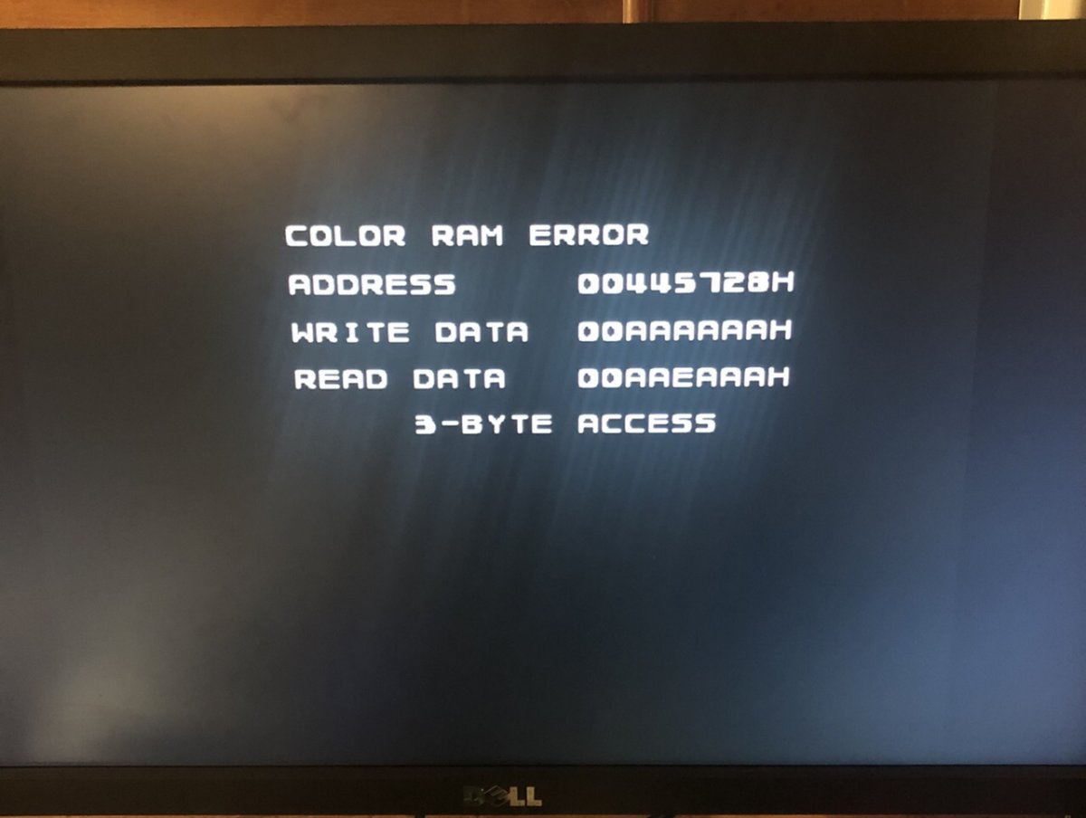

Did you ever resolve this? I just noticed my F3 throws a color ram error on Rayforce. Every other game seems to load just fine.
Having he same issue with my F3 multi. Any pointers on where to start looking, or a resolution would be great.
I'm also getting a color ram error on Puzzle Bobble 4 with a little more information:
COLOR RAM ERROR
ADDRESS 00440000H
WRITE DATA 00555555H
READ DATA 0055555DH
3-BYTE ACCESS

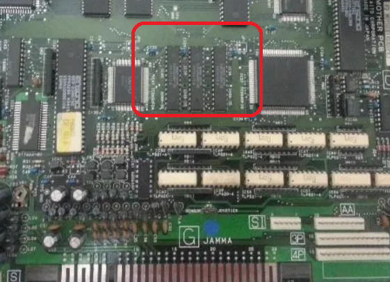

Anyone able to point to which chip this might be based on the address?
Found this in MAME driver:
map(0x440000, 0x447fff).ram().w(FUNC(taito_f3_state::palette_24bit_w)).share("paletteram");
COLOR RAM ERROR
ADDRESS 00440000H
READ DATA 0055555DH
3-BYTE ACCESS
I get a similar error with Puzzle Bobble 4....

I had an F3 motherboard once that had this behaviour. It would work with some games but throw the color ram error on rayforce. This was with original carts and not the multi. Do you have a different motherboard to test with?
Tested and works on a different board ok.
