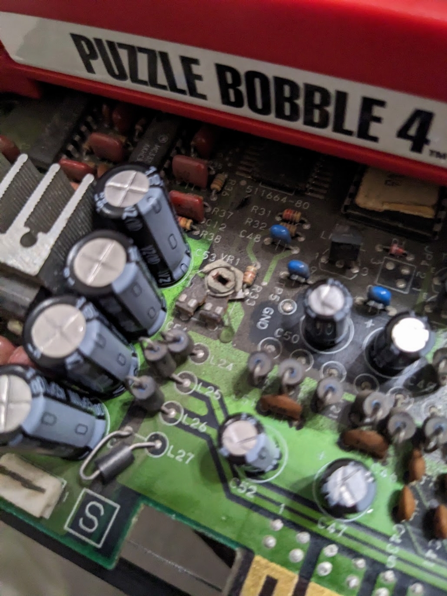

Hi there!

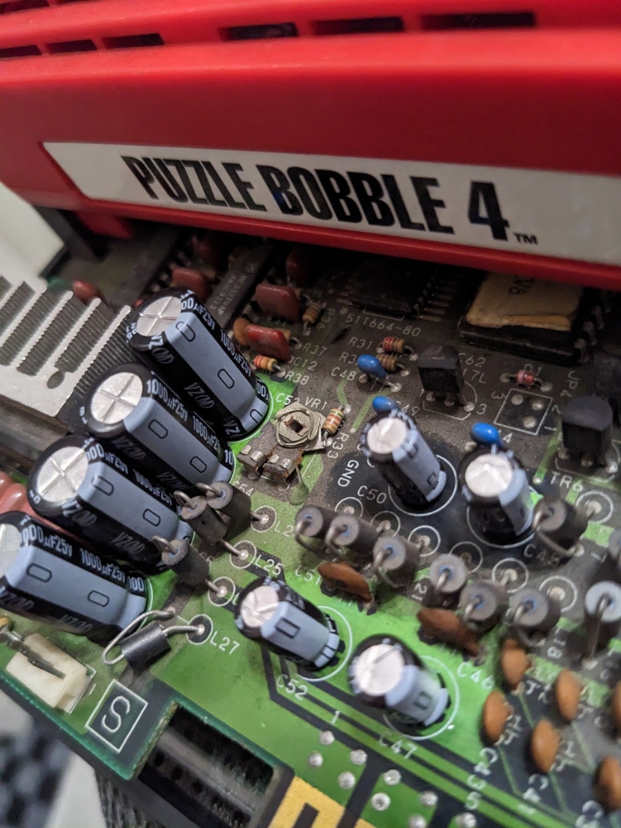

Can anyone point me to a replacement pot for VR1? I've seen some posts saying that it shouldn't be messed with. Sadly my board came with a busted pot. The game works, but I don't know if it will cause damage in the long term.
That’s not a volume pot.
That’s a voltage pot to adjust voltage on the board and should NEVER be touched.
Thanks I updated the title. Any idea what the value of that pot is? Also are there any reference points to set the voltage?
Don’t change it. Don’t touch it. You run a huge risk of frying your board if you do either of those things.
Can’t find the link but… one of the audio parts (ensoniq chip) has huge working voltage variability from part to part, so the VR1 regulated voltage to be on-spec on each individual board.
hmm I see.

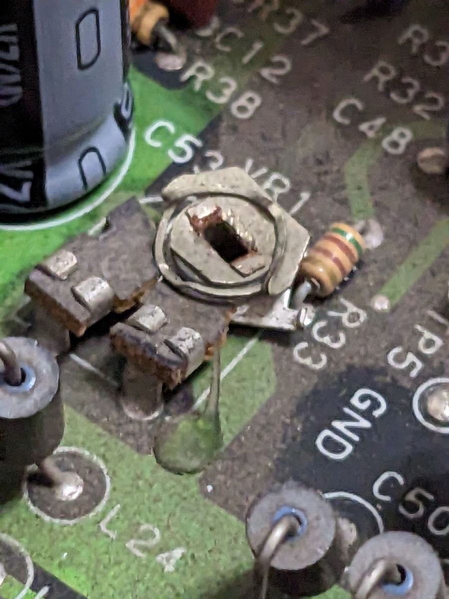

The reason for this post is because the pot looks like its been smashed and is missing pieces.
I could be mistaken though. This is my first time owning one of these boards so I'm just referencing pics online.
I guess this is a "if its working, don't fuck with it!" situation lol

That is my plan exactly! I've got the case already and ordered the multi.
I recapped it and noticed that pot and was just being paranoid that it might be an issue. Didn't wanna kill the multi kit.
