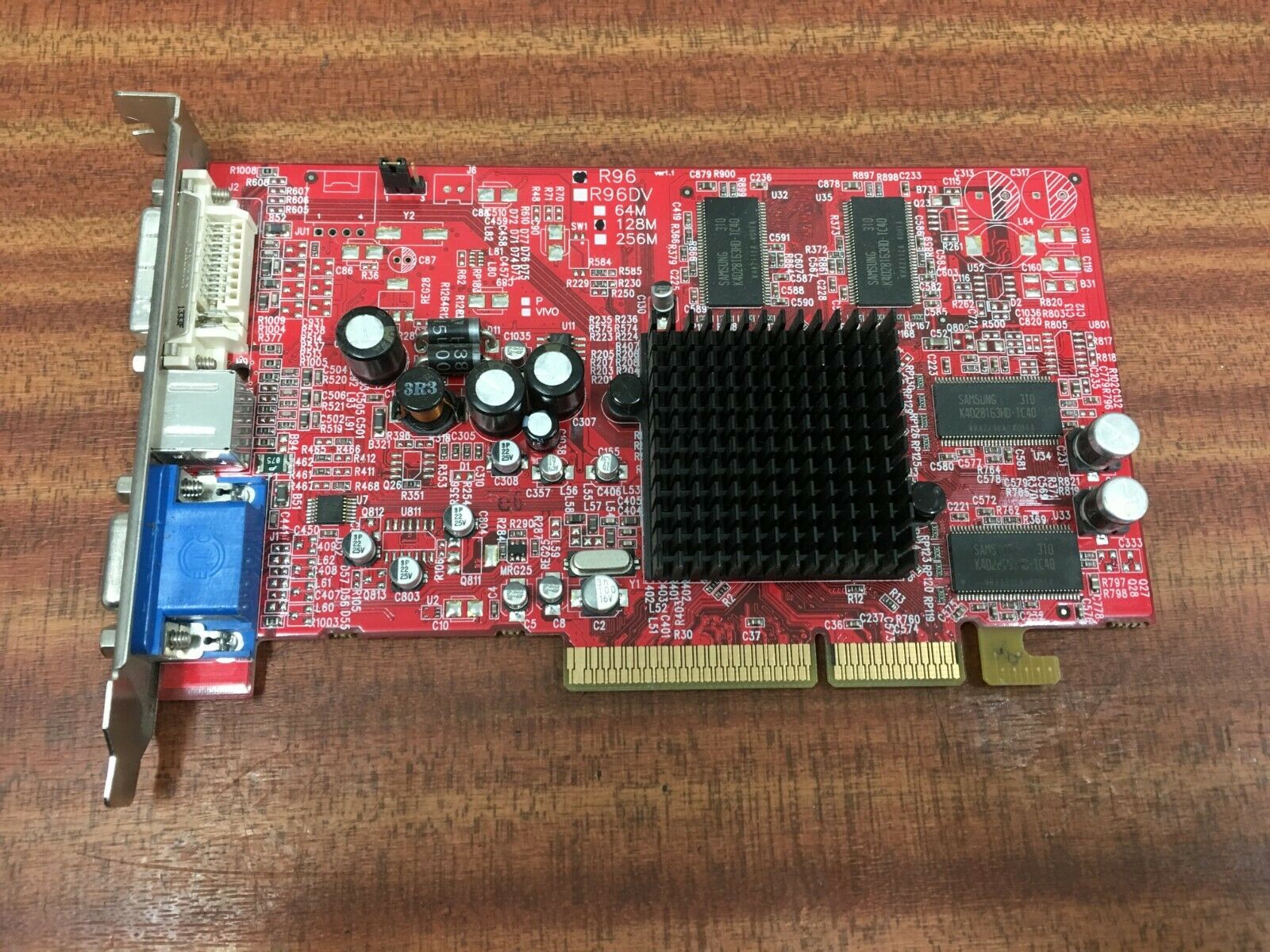

On Graphics cards I have tested a 9600XT 256, a 9600XT 128 and a 9600 (!PRO) 128.
The XT 256 booted, but threw software errors.
The XT 128 I chose as it looked identical to the TTX+ card. That gave software errors, then graphical glitches and then died...
The 9600 128 was advertised as a PRO, had no external markings as such so I am assuming it to be a vanilla 9600.
The vanilla 9600 128 boots to the multi and games are playable with the exception of Tetris TGM X/
(For that the game is clearly running, but the screen is black).
Ok, I have heard that Tetris is really picky about its graphics card. No real surprise.
I will mostly use this TTX for tate, but I hate tradeoffs.
Just some filler... I picked the 9600 !Pro (left) as it had the same PCB layout as the stock SE (right)
Here is the chipset...
I'm pretty sure the 215R8KAGA12F chipset is a non-PRO model :thumbdown:
Anyway... Perhaps I try for a legit PRO, possibly a better SE (lol).
At least it looks like the R350 family (SE, 9600, Pro) are viable.

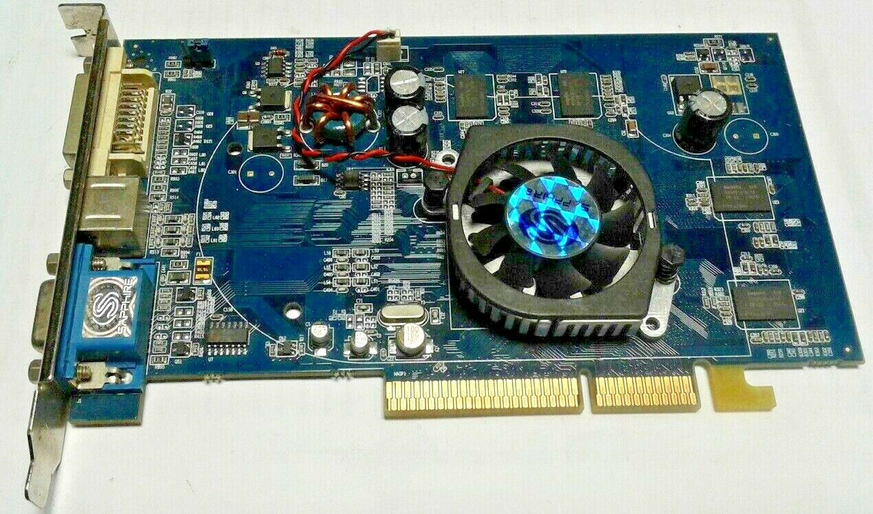

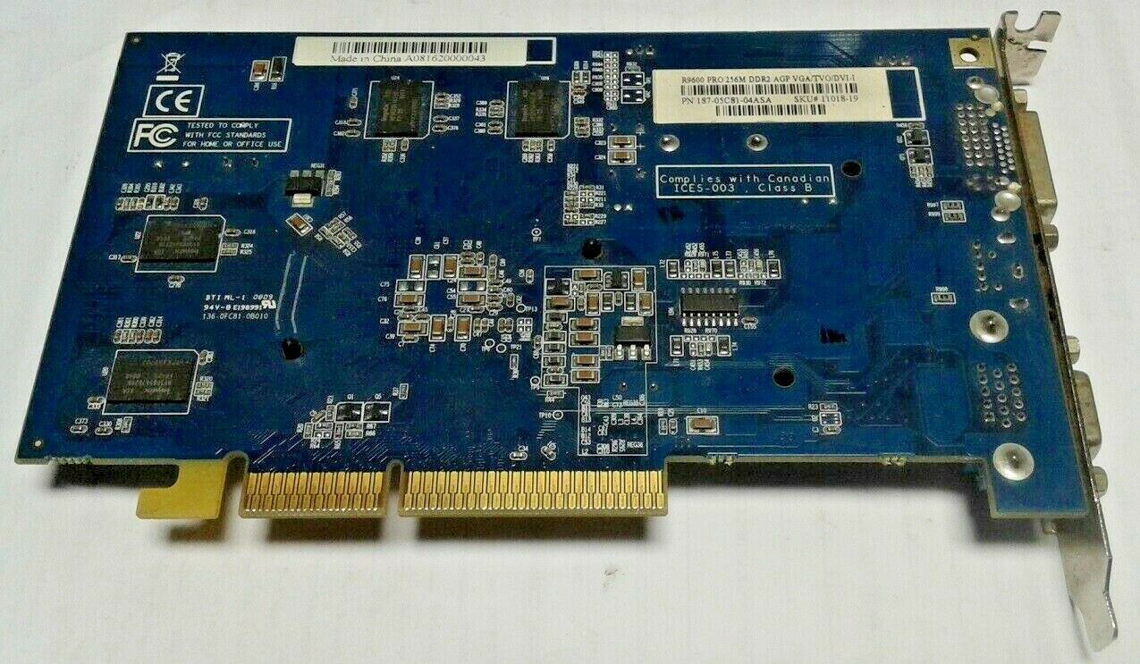

Picked up a Sapphire 9600 PRO 256 card for cheap.
This uses BGA memory unlike most cards in this range, so perhaps some better specs there too.
Boots up and runs fine. More testing required :thumbup:
Scratch everything.
Playing Raiden IV, noticed pretty prominent screen tearing.
Tested a 2nd TTX unit (near stock)... ran smooth.
Have returned to stock 9600SE.
Test for yourself - Raiden IV (Export), Standard game, Lvl2 over city buildings.
SE = nice and smooth, Anything else = choppy mess.

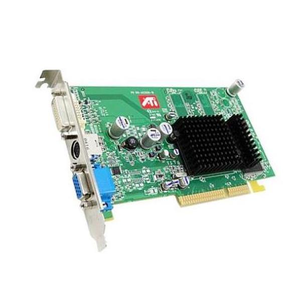

@Mickysmoke The stock SE looks like this:
It is assumed to have a custom BIOS.
It should be trivial to extract said bios and flash a stock card, but haven’t got round to trying.
May also be possible to flash another RV350 based card with the same or modified BIOS.
@twistedsymphony and @rtw may also be onboard with experimenting here...
