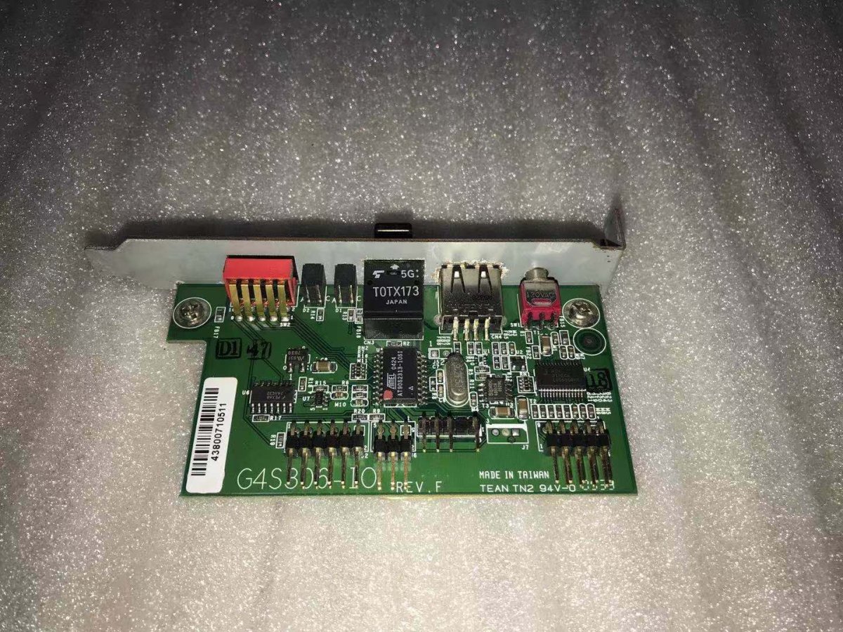

Any thoughts on this Taito Type X I/O G4S306-IO Jamma JVS Board PCB (I attached the photo)?
I've never used the JVS-Bridge before, so I don't have any real opinions on it. The website specifically states that it doesn't support Taito Type X though. Also, it seems that you would need to either build a control setup that's wired to this board, or wired into a DB15 port for DB15 based controllers. Doesn't seem to be what you want if you intend to connect X360 or other USB based controllers.
The G4S306-IO is precisely the thing I was describing in the 2nd paragraph of my earlier wall of text. You need this for JVS controls to work with stock TTX games. I mentioned that it was a PCB with a control board, which isn't 100% correct. Both the controls and the PCB itself are one unit that's connected to the mobo COM and front panel header, as Niko described. I accidentally mixed up TTX2 and TTX3 hardware in my mind...
Those were $20 on eBay a while ago.

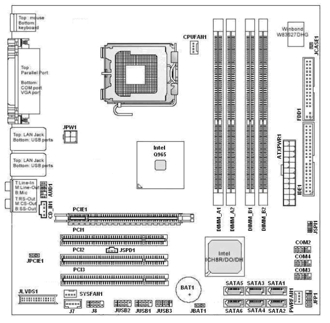

I now have the G4S306-IO. I have a motherboard that is of the same generation but not exactly the official Taito MOBO that would have come with the X2. I'm curious as to what each cable connects to and why. I found another post but there's confusion in the explanation and I think they end up glossing over that. Do you happen to know where I can connect each input within my MOBO (I have a picture of the layout from the manual)? If I have to get converters or longer cables, shouldn't be an issue. I can ebay them or go to my local microcenter. Below (not my hand, found on another post) is what I purchased, which includes the same cables.
Below is the layout of my MOBO
I'm not even sure if I exactly need all of the cables plugged in or not. I know one of the posts mentioned that one of the cables (12-pin) is for the headers but I'm curious if the button outside of the I/O board powers it on but if not, unsure how I would then power on the computer without the headers connecting to the case motherboard. Also, Is there documentation on what the USB and the middle output (can't tell what it is from other pictures) is for but I did find out what the dip switches do, so I won't be changing those.
I'll try to look online for an official manual for the I/O in the meantime.
The post above yours by nam9 links to another post that describes what the 3 cables are. It's COM (serial, goes into COM2 per other posts), SPDIF (audio), and front panel (which is probably for the reset button).

Nice. Your motherboard has a COM2 header. That could save some issues. I don’t see SPDiF, so drop that connector. You only need to send power on FP1 if you want to keep your case buttons. I’ll find another post of mine…
You need to connect +5v and Gnd to the 11 pin header on the I/O card.
This is the pinout on the motherboard. Pin 1 is top left. Pin 12 is missing (keyed).
+5v --> Pin 2/4
Gnd --> Pin 7
You don't need anything else wired up to test. Just power, ground and of course the serial port to COM2.

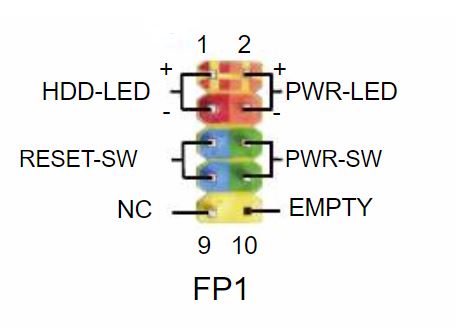

Above is the pinout for the FP1 connection.
It is slightly modified from a standard Front panel header on a regular ATX motherboard (below):
TTX ATX has 2 additional pins before pin 1, 2 on the standard ATX.
Now you just need to decide how you want things wired. If you connect FP1 to the front panel connector on the motherboard then you have no power button, reset is on the I/O and the LEDs on the IO function. The system can also reset itself if the watchdog timer is tripped (probably don't want that..).
You can just repin your PC case FP connection to mix and match as required - I spliced cables to have both sets of LEDs and reset buttons functioning.
The main issue you will have is that your motherboard won't supply a +5v power source to the I/O. You will get a softdips missing error with the Multis.
Solution is to repin the +5v/Gnd to a nearby USB header. That will get you powered up.

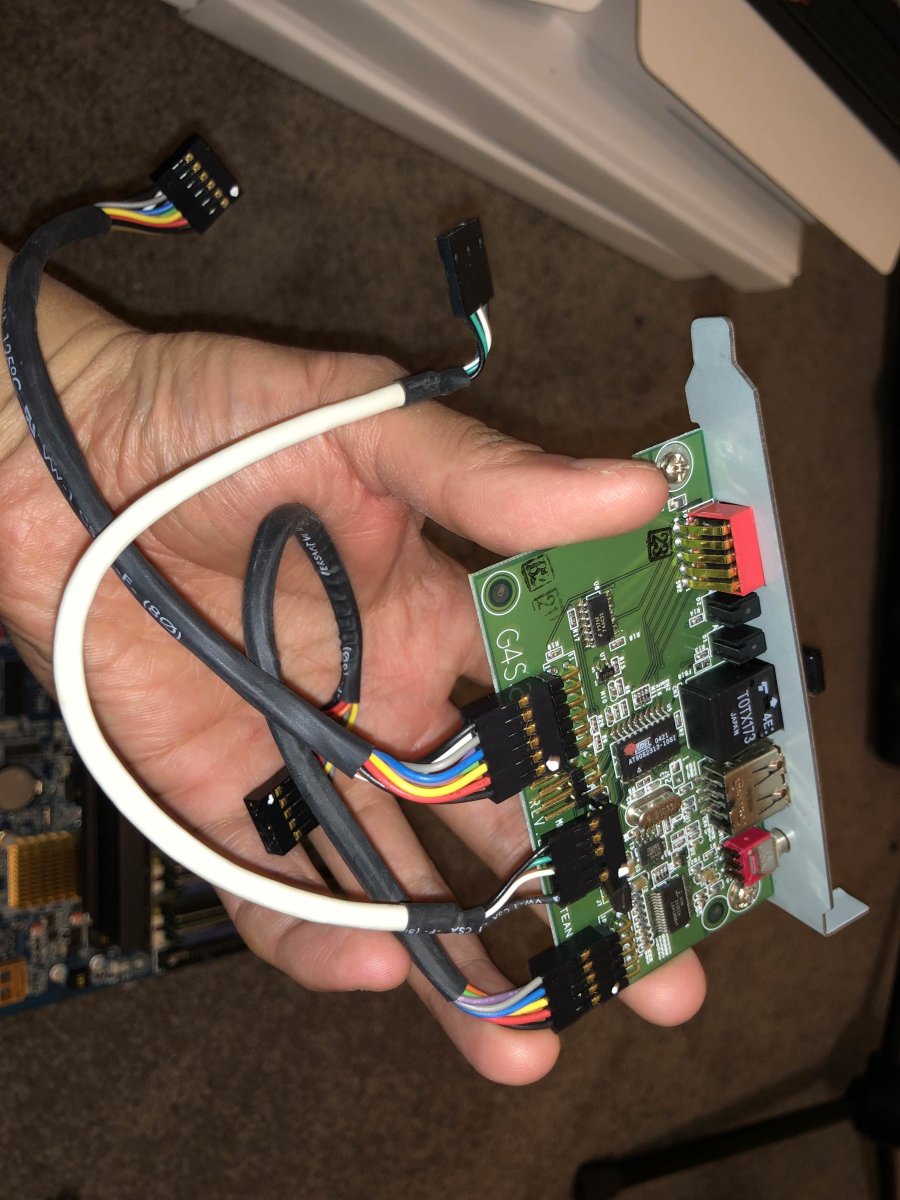

I finally have an update. I now have a motherboard (that works), has an IDE/COM socket, so I no longer get a blue screen about the motherboard not being compliant when I connect the JVS. Now I get another blue screen that seems related to the Hard Drive OS. The COM IRQ settings are correct and I'm using a SATA SSD/USB that both have different versions of the TTX Multi that I got from another forum.
I believe I need to get the proper OS in order for it to load properly. Any assistance with where to go for that? I can also try just get my hands on either an IDE drive or a SATA to IDE converter to see if that helps but I have a feeling the OS is really the issue and getting my hands on Windows XP Embedded is not as easy as I thought (I do have Windows XP Pro installed on a SSD drive that was used in the machine)
I had to remove all of the cables from the FP1 housing in order to get them connected to the motherboard. I believe it works correctly as I tested out the reset button on the JVS and it worked with no issues (I found a way to both us the Power SW from the Case and from the JVS). I also think maybe I need a second reference point for the FP1 cables to know what each one is for. Someone has it in another forum but he's unsure of some of the colors.
I can provide pictures to half of what I said later (at work at the moment) in case there's confusion in my wording.
