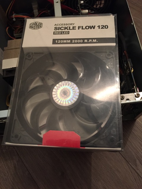

What to buy
These are the fans I purchased, they are quite cheap.
CPU CoolerGeLid Silent 7 FN-SX07-22 70mm
Case fanCooler Master SickleFlow 120
Power SupplyScythe Mini KAZE ULTRA 40mm (2x)

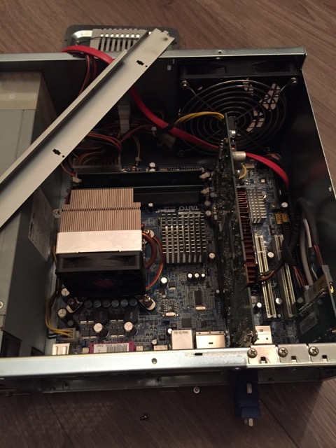

Open up the casing
  1. Unscrew the top hdd-cover with your (multi)hdd
  2. Unplug the SATA cable and the power cable.
  3. Next, unscrew the full top cover. There are 3 screws on top, 2 on the side and 2 at back as well as 2x front side.
Remove the support bar
Remove the graphics card + JVS/Dipswitch support PCB
Note: the graphics card is connected to the powerPSU, you have to unplug the power cable.

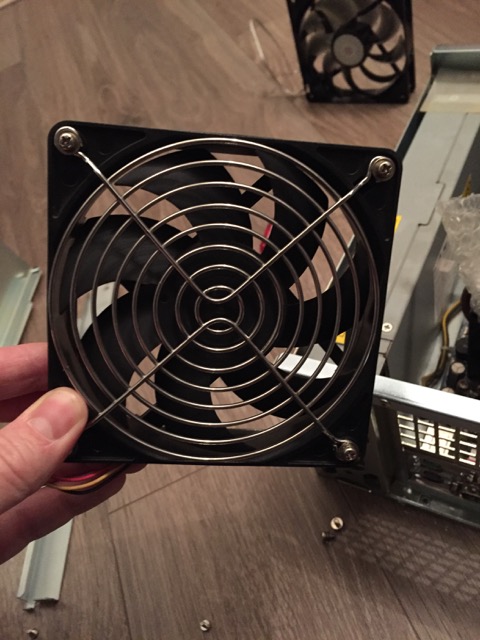

Remove case fan from casing and replace with new fan
Note: mind the direction of the airflow, should be the same as the original ;)

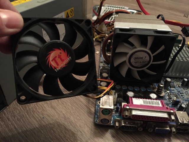

Replacing the CPU fan
Now comes hard part #1, in order to get to the CPU fan (without removing it from the board/cpu), you need to lift the whole motherboard from the casing.
I chose to leave all the power plugs in place; hence I lifted the powerPSU and the motherboard together.
  1. Unscrew, on the side + in the front of the casing 2x2 screws from the powerPSU
  2. Unscrew the 7+ motherboard screws
  3. At the back, inside of the casing the power cables are bundled; open that clip to release the cables from the casing
  4. Lift the mobo + powerPSU together and place them next to the case
  5. Replace the CPU fan - there are 4 screws in the fan itself

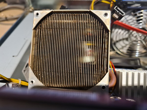

Thanks for the guide! Just performed this myself. I went with Gelid Solution Silent fans all round (12, 7, + 2x 4) just because it was easy to order all the same :D
The CPU rad needed a damn good clean too!
